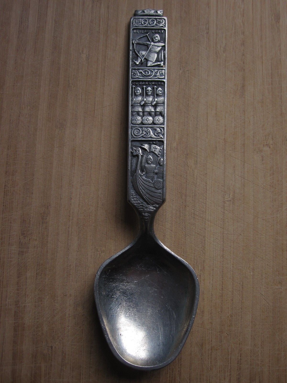

Here is a pic of my special edition limited run serialized viking cereal spoon. The pride of my spoon collection! I might make a Kydex neck sheath for it soon.:D:rolleyes:
