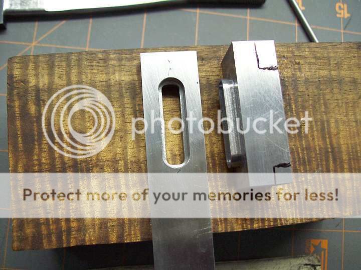

Here's a pic of the stock I'll be using along with a simple mill vise and stop set-up. The stop will allow me to remove and replace pieces, while maintaining position, as they progress through different operations in my process.

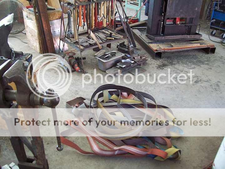

A Week or so, in the Life of a Belt
Yesterday also found me doing a bit of cleaning around the shop, specifically, in the area my belts reside.
I also removed my belt rack, replacing it in what I think is a much better place
I know there are quite a few knifemakers checking this thread and I'll bet real money they go through exactly the same thing I do when it comes to belts.

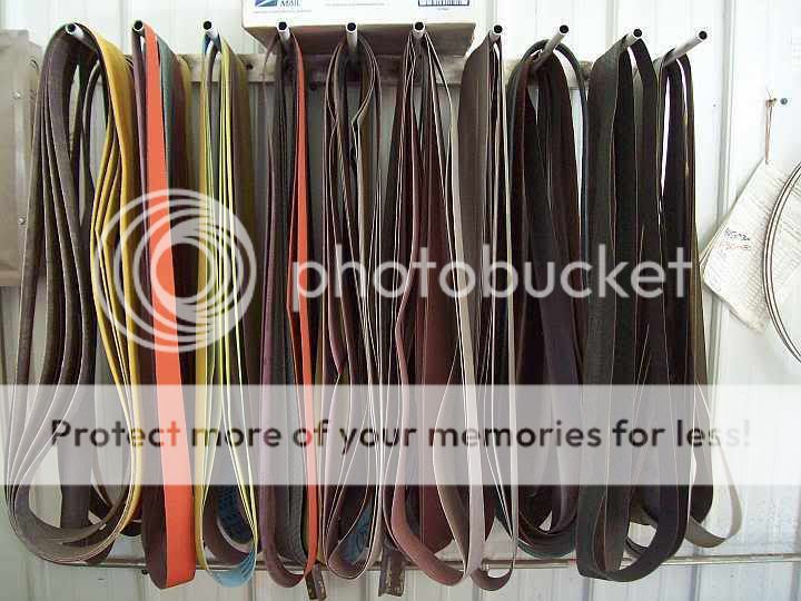

Like everyone, I order from one of the many suppliers of quality abrasive belts.
After receiving them, I hang them on a rack I made several years ago.
I try to place new belts towards the back of the rack so the older ones get used first

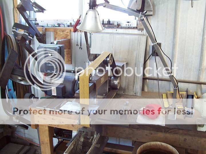

Every belt inevitably ,ends up here, on my grinder.
And they never, ever last long enough :grumpy:
The next spot they end up is like a time warp. It's pure and simple..... denial :rolleyes:
I have a spot, a couple of garage hooks actually, where I hang belts that aren't quite used up yet :o
:rolleyes:
I'll bet every knifemaker has a spot like this.
The belt numbers seems to grow in an exponential manner.
Isn't that just a pitiful sight ??? Denial !!
It gets to about the point you're seeing in the pic. One day it seems like I've just had enough and they move here .....................
I don't have to tell anyone where the next stop after this is :D The garbage can !

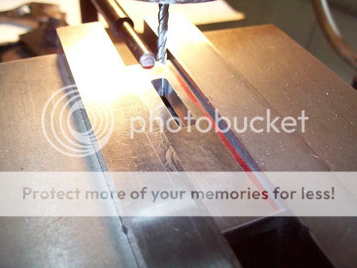

Here we see some guard slotting going on.
Next up was the spacer ......

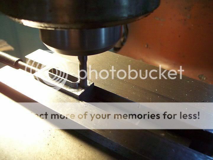

Here I'm milling a boss on the guard side of the spacer.
And for what you might ask :D
Well............ so I don't have to use any pins for part location ;)
:D
I thought that would be a good way to mate the spacer to the handle block too :thumbup:

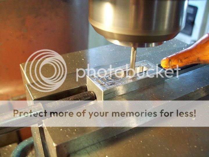

So I milled another boss on the handle side of the spacer ......................
I need to mill my spacer pocket into the handle block next, then cut my tang slot through.

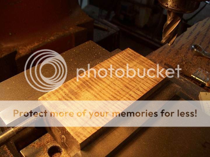

I'll most likely be putting the handle block in my mill vise and taking it back out more than a few times before everything is ready for hand finishing. To make sure I can accurately locate until that time comes, I squared this Beautiful block of Koa up too ;)
Just to be on the safe side............. ;)

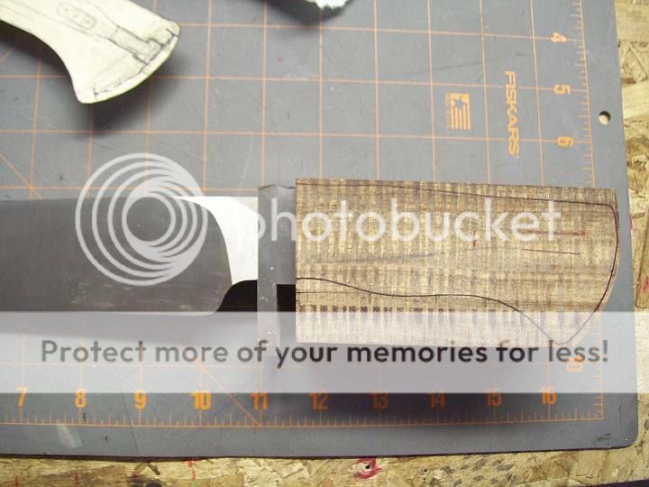

After at least a dozen handle to spacer/guard/blade positioning attempts on the squared up handle block face, I came to the conclusion I wasn't pleased with how the Koa stripes looked relative to the blade. They looked like they were tipped forward too much, like this \\\\\.
IMHO they needed to at least be perpendicular to the blade.
Preferably, I wanted them to tip in at the bottom, towards the ricasso just a tiny bit, kind of like this ////, not quite as extreme as the keyboard stroke.
That being said, I ended up re-milling the face of the handle block at 1 degree, which positioned the stripes perfect relative to the blade, IMHO :thumbup:

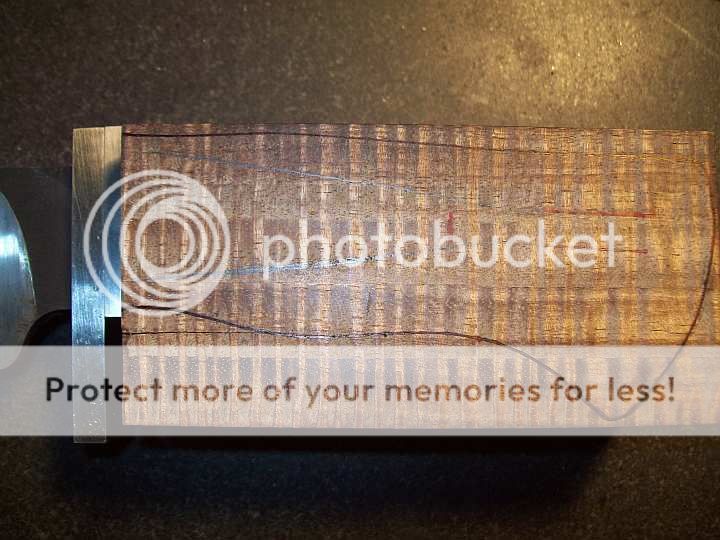

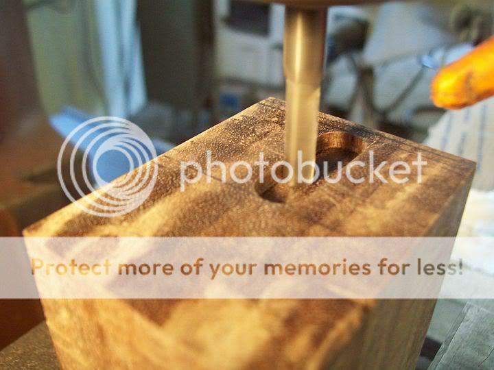

I figured, as best I could, where the pocket for the spacer boss needed to be and milled my pocket.
and deeper .................... ;)

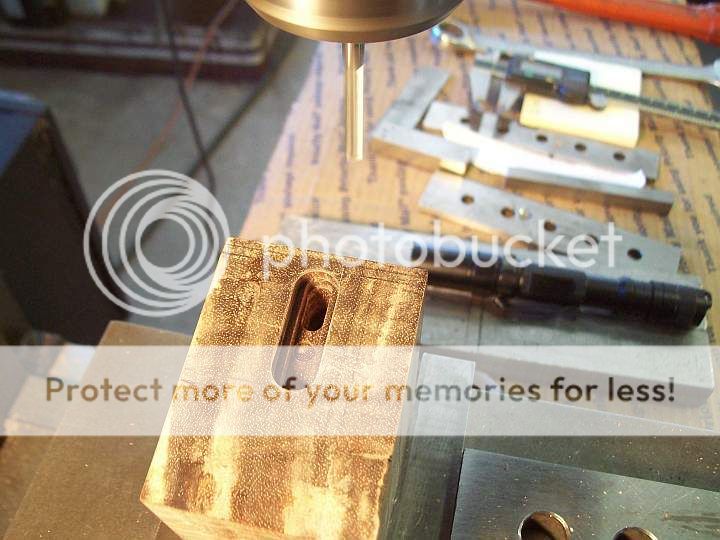

After I had a nice snap fit for the spacer boss I milled some rough guide lines where my tang slot needed to be. You can see the shallow guide line pocket, in the boss pocket, ;) in this next picture.

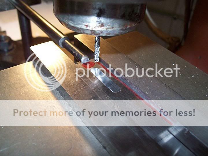

The next picture shows me milling the tang slot. I position using a square and the tang guide lines I traced onto the handle block. I tip the block accordingly and clamp in my vise.
So I milled and drilled, flipped and flopped, and finally, I have a nice snug fit for the tang :D

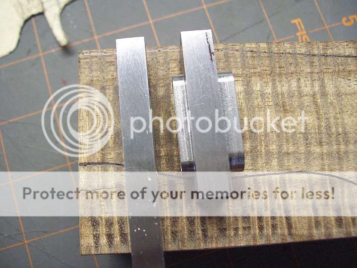

Next I knocked the extra-extra length I had on the topside of the guard and spacer
I still left a nice bit for finishing ;)
I also roughed in the backside of the handle. That visual really helps me when I'm thinking about exactly how I'm going to attack the pommel cap, the fit-up and finial nut. I think I have a good plan :thumbup:
