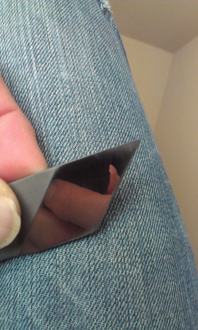

With all due respect tryppyr, the 1x30 (while I still don't recommend it) can achieve a flat grind. It's pretty crappy, but with a little hand sanding the flat will be be doable. I just did a kiridashi with a bevel only about 1.5", but it was very flat. As another example, I'm working on a wharncliffe right now. I'll post a pic just for reference, but please be aware that I'm far from done. Still, I've seen a few examples of work done on the little grinder that was actually worth posting. My point is that it can work. Especially (I'm guessing) for someone (like myself) that hasn't had exposure to a decent grinder.
Let me be 100% clear. I DON'T recommend the 1x30. Try to get the Craftsman. I know I will asap, but that doesn't mean that no one should try one. I just happened to own one when I got interested. As for hollow grinding with the top idler... Don't even bother trying. As tryppyr pointed out it's useless for that job.
A long way to go, but what you see that isn't flat was all inexperience. I'm still working on figuring a lot of this out.
Edit- this is the dashi primary. Literally less than 5 minutes with sandpaper. Flat right off an 80 grit zirc. Again, a couple of problem areas, but my fault, not the grinders.
Good results, Strigamort (under the circumstance). You've obviously put some time into adjusting the machine and learning to use it. I'm impressed.
