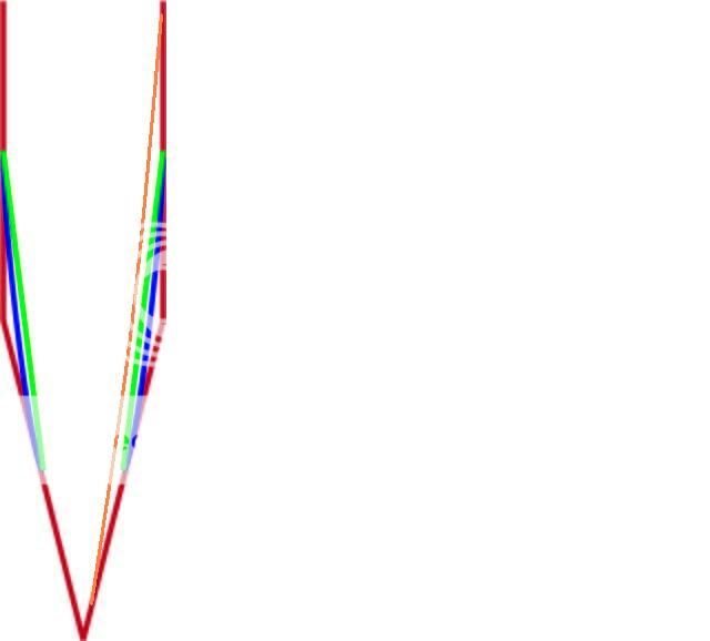

Having thought about this topic quite a bit while measuring the geometry of convex blades, I would offer the following images:
Convexing blade on a pasted strop produces a geometry approximated by the following image:
Translating the convex (blue) to the same apex as the original (red) shows the expected result, the convex is thicker behind the edge.
An important (mathematically) point here is that there is no "terminal apex angle" in this case. This is why the arguments invoking the terminal apex angle are problematic.
If you partially "convex" the blade by simply knocking down the shoulders and not touching the original apex, you get a geometry (blue) that is thinner behind the edge (some distance from the apex).
However, if you simply flatten that convex part of the bevel, you get an even thinner edge (green). As a surveyor, you will know that a straight line is the shortest distance between two points.

Also note the green lines that are more thin behind the edge do not appear to contact along the spec'd terminal angle (in fact cannot based on where they started if one is trying to keep the edge angle the same), but form a bridge making an additional bevel. We are now very close to making a convex edge anyway.
I included an additional line to your art, the orange one would be more typical of a convex arc that stops just short of the apex. To now fit a thinner V bevel into the remaining space one would need to make a full flat grind or something very near to it.

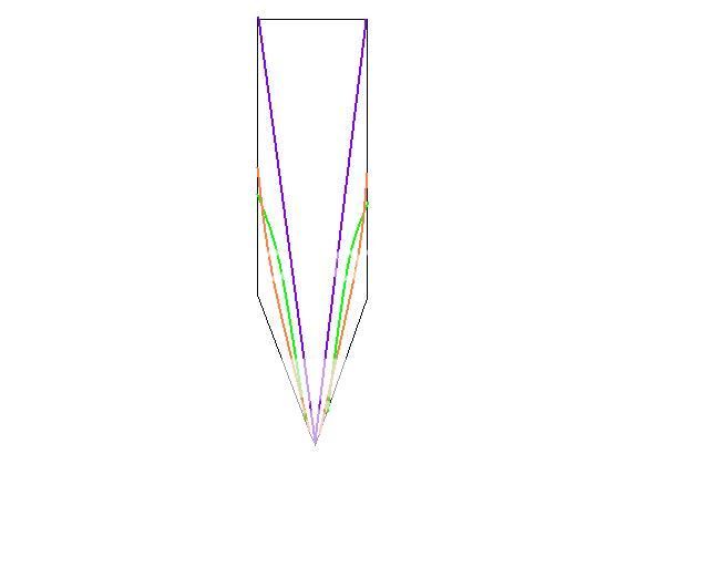

If one uses X/Y dimensions per the OP, the convex will come in dead last. However, every joining of two planes, at any angle, will leave a region that can be bridged by an arc. Only a single straight line is free of this condition - that's why there's always trampled grass inside the corner where two sidewalks meet but it grows to the concrete where its straight - folks are taking a short cut.
Below is:
flat (much more acute than the rest), hollow, convex, and V bevel. One could substitute any value for the final approach distance back from the edge, and unless the cross distance ("T" on your diagram) is a constraint the hollow will have the least material, convex next, V bevel will have the most. Remove "T" and the initiation point for the convex arc is free to move closer to the spine, shrinking the enclosed area.

I am still not clear on why the convex would be thicker than any flat sided approach until one reaches a straight line.
It must be by definition of the word "convex".
The 'T' is arbitrary, put it ANYWHERE and the results are the same, the flat bevel will fit beneath it. Again, that is what the term "convex" means. And your diagram is comparing a bunch of random edges with variant geometries, what is its purpose??
