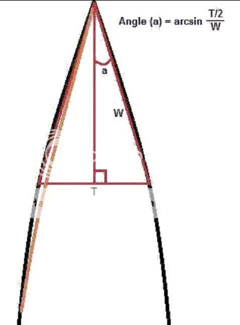

You haven't addressed the whole bridging between two joining planes issue.
If you have two planes and grind a third plane between the two planes, you have 3 planes. What is the problem? Only a curve that lies outside (or above) those planes is considered "convex". If the curve falls beneath those planes, then the curve corresponds to some other plane to which it is convex.
If you grind away the the shoulder where two flat planes meet using a curve to join them (creating a "mid"-bevel or whatever you wish to call it), that curve has a distinct start and end - two points that could be 'bridged' with a straight line falling beneath the curve you created.
Regarding the effect of the convex reducing penetration and increasing wedging, how is that not obvious?
Take as example one of the measurements from the edge of the Gillette razor-blade described, ignoring for now the thickness of the apex: "...a thickness of between 0.96 and 1.16 micrometers measured at a distance of 2 micrometers from the blade tip". The edge-angle that creates is ~14 degrees per side if you measure using straight lines, you'd expect the edge thickness at 1 micrometer from the apex to be ~0.5 microns. But it is a "convex" edge, not a flat V bevel, and what do you get: "a thickness of between 0.61 and 0.71 micrometers measured at a distance of 1 micrometer from the blade tip...".
Which presents a reduction in penetration and an increase in friction via an increase in wedging, the thinner edge or the thicker edge? It should be obvious that the thicker edge requires displacement of more material in order to proceed = greater wedging and reduced penetration. And the convex edge by definition is thicker than the only corresponding flat edge to which it can be compared.
The limit you come up against is how fine you can take your measurements in presenting the angle of the convex edge, but however fine you go, you will always be measuring straight lines that necessarily fall beneath that curve.
Again, it is all contained in the very definition of the word "convex".

Here is a butchered version of the sketch in the OP - the blue lines indicate bevels "bridged" by the curved bevel which is "convex" to the bevel beneath it that "bridges" the curve.
Alright, one last time. You either get it or you don't at this point.
Looking at the diagram - the exact angle is meaningless for the purposes of the discussion, everything is relative.
Orange line is convex that joins two points on the planes that make the original angle. Which defined area has more surface area and extends further from the center line, in both images?

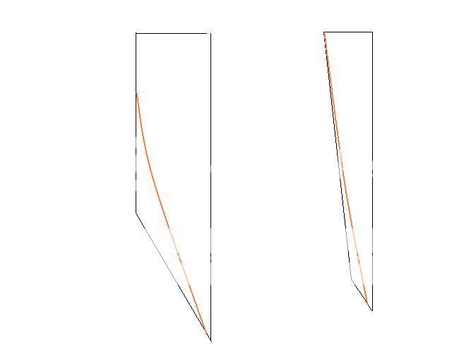

And here is the convex inside your defined cutting angle (maybe we can agree to use the term "known working angle" since according to you there is no such thing as a terminal angle)? It would have been easier and more noticeable, but you have built your V bevel inside a larger convex structure. In effect I have thinned out the convex while maintaining the known working angle. In reality I could have run the initiation of the convex even further up the primary and your V bevel would shrink dramatically right from the get-go, while the convex continues to maintain the same "known working edge".
As I stated, to undercut that arc with a straight line you will have to change your primary grind and make the known working/cutting angle smaller. Or if you blow it up you could maintain the original edge on some microscopic scale, that I could then arc and exactly as I stated you will chase it until the working angle shrinks into a FFG from spine to apex.Along the way the convex will always have less mass behind the edge at any "known working angle".
Ask around about the convex increasing resistance and wedging, the outdoor forum would be a good place to start...
And here is the convex inside your defined cutting angle...
Are you kidding me?? The reason no value is given is because it is arbitrary! Your curve has a new beginning point and end point beneath which lies the connecting straight line to which it corresponds. Why si this so hard to grasp?
... maybe we can agree to use the term "known working angle"
The image I provided is the only way to measure the "known working angle". Your orange line creates a NEW "working angle" that requires derivation through inscribing a straight line. That was unnecessary since the original image provided no units, I could have made the same image thinner and it would still apply. Get it?
EXACTLY wrong.
... to undercut that arc with a straight line you will have to change your primary grind and make the known working/cutting angle smaller...you will chase it until the working angle shrinks into a FFG from spine to apex

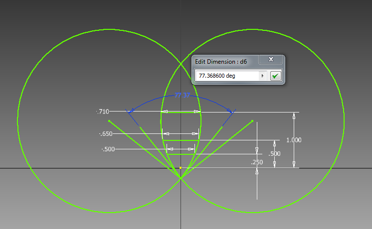

I'm glad you asked ;) I decided to use your dimensions from Gillette, as they provide a real world example. Throwing those into CAD (using the max dimension of each of three), I can tell you that the apex angle of this blade (if it had a perfect apex) would be 77.368600 degrees. Interestingly enough, the radius of curvature for these bevels is 1.6502 microns.
Thank you for doing that :thumbup: Attachment not working...? :(
How crazy is it that the apex, by that method, is ~38.7 dps?! On a razor-blade! :)

I was able to redo this on Inventor, here is an image of the Gillette example.

Are you implying I cheated somehow? And as stated earlier - if I had driven the initiation point closer to the spine it would simply become ever more acute with that final overlap of angles unchanging.
The final angle that one would hold the tool against stone hasn't changed, the working angle is the same, clearly visible on your image blown up. I haven't changed anything, you are attempting to apply the wrong mathematical principles to the problem and instead of checking the results against what can be observed, you are claiming the observable phenomena are wrong. Feel free to place a V bevel inside the orange convex that doesn't shrink the final working angle, or default to scales of operation that are unrealistic in practice - the only thing left being a micro-microbevel at the original angle (within which I could place an equally unrealistic arc until the V bevel becomes a straight line).
As for convex and wedging, the convex is less precisely because it is thinner per any given working edge value, and the contact area is spread over more surface area as well. It cuts deeper with less force.
A straight sided wedge pushes the two sections apart further with a smaller contact area driving the split ahead of the actual cutting edge, greater wedging force. Felling and chopping tools are normally convex, splitting mauls and wedges normally straighter sided. People that actually use a variety of tools for doing actual work, understand these dynamics better than folk attempting to apply them from an arm chair.
A convex edge has no angle -- only converging straight lines that meet at a vertex have an angle.
https://www.mathsisfun.com/definitions/angle.html
What you are measuring is the angle of two straight lines, in this case the tangents of two intersecting circles. The angle of the tangent (two straight lines) is not the angle of the convex edge formed by two intersecting arcs. As you can see, the tangents are outside of the convex edge at every point except the single point at a perfect apex. And no convex edge has a perfect apex, the angle of tangent doesn't even exist except in perfect theory. No single point can have an angle.
The two tangents in this case share a common point, and the angle of the tangent is good only for that single point, not any place on the actual edge bevel. If you go back from the apex on that edge by only a split whisker, you'll have two different tangents and a different angle of tangents. If you go back another whisker or so, you'll get two tangents with yet a different angle.
In fact, any convex edge has an infinite number of angles of tangent, each with a different angle. A V edge has a constant angle for the entire edge.
The problem is you can't directly compare a V edge to a convex edge. When you try to say a convex edge has an angle (or a angle proxy), you end up with a situation like trying to divide by zero.
Where you go wrong is saying that the angle of the tangent is the same as the angle of the convex edge. The convex edge has no angle. It has an infinite number of angles of tangent and all are different.
Convert convex edge to polar coordinate, then compare to v edge. Otherwise, mirror dancing can be eternal lonely :hopelessness:
