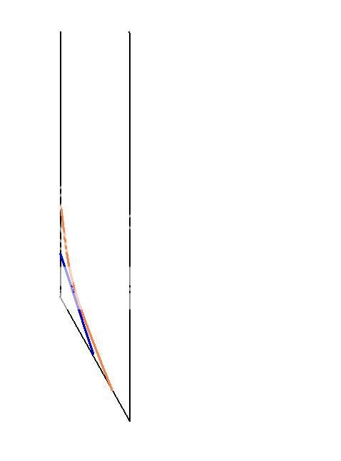

If you look at Bpeezer's diagram, you'll see what could be a convex edge, at least from at the apex to the 0.650 width line. If I understand Bpeezer correctly, he is saying that the angle of the tangents (green lines shown by the blue line to have an inclusive angle of 77 degrees) as being the way we measure the "angle of a convex edge." Actually, angles can be measured only by straight lines, which is what the diagram is doing.
But the key point is looking at the V edge at 77 degrees compared to the convex edge that has an angle of tangents of 77 degrees. The convex edge is more acute than the V edge at every single point on the edge bevel, other than a single point at the apex. To say that Bpeezer's V edge at 77 degrees has the same acuteness as the convex edge with an angle of tangents also equal to 77 degrees, is clearly not the case.
That's not what I'm trying to say, but my point is such a small aspect of the overall discussion that I won't pursue it further.

I was able to redo this on Inventor, here is an image of the Gillette example.
