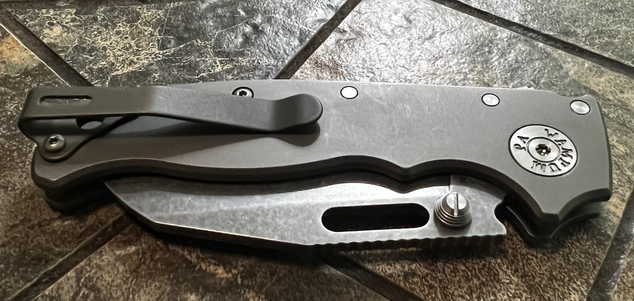

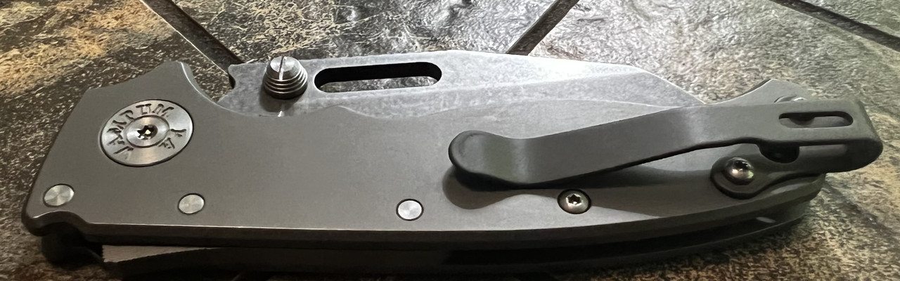

UPDATE:
So I got delayed until today with installing the Skiffs on the smooth ti sharks foot. I cleaned the knife with alcohol, added one drop of KPL on each bearing and the pivot, and reassembled.
At first, I didn’t notice a difference…but then I tuned in the pivot, and it is noticeably smoother now. It’s hard to describe because the knife is already so smooth. But it seems to glide better now, and requires almost no force whatsoever to open or close the knife. I don’t think that the KPL is necessary, but I only put 3 tiny drops on the whole knife, so I figured it couldn’t hurt anything.
I’m likely going to replace all of my daily carry 20.5s with these now. I must say that disassembling and reassembling this knife was extremely easy. I just removed the clip side and left the lock and spring in place while changing the bearings. It took less than 10 minutes, and most of that was cleaning it and dialing in the pivot.
One note is that the larger pivot knives have the pivot screw on the opposite side as the smaller pivot variants. I might do a Grivory knife next to see how the dis/assembly process differs.
