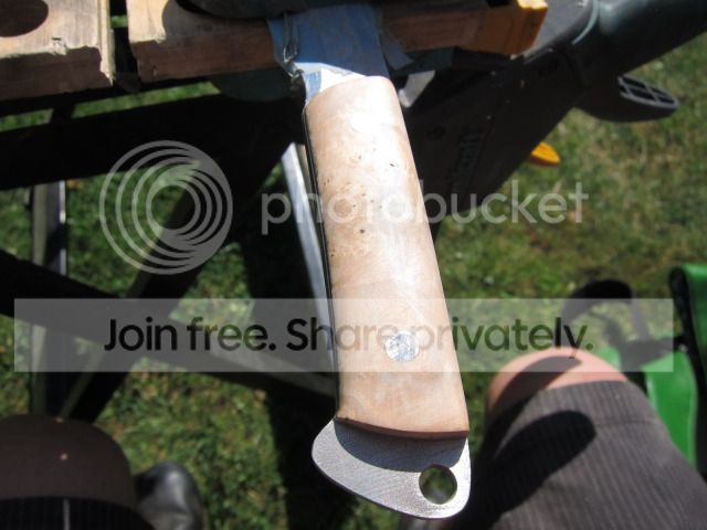

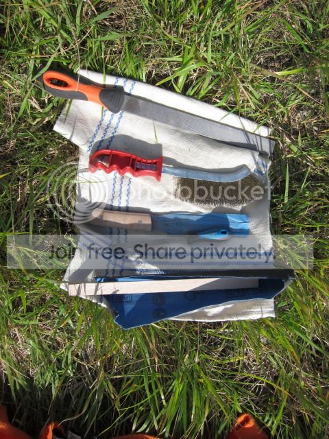

Use a sandpaper backer It will help out quite a bit. I get my handles close then file down the corby's high spots. Then go to hard rubber backed paper(a hard rubber "stick" with paper over it) :)
Thats a great tip. I am going to dig out my rubber back paper block.

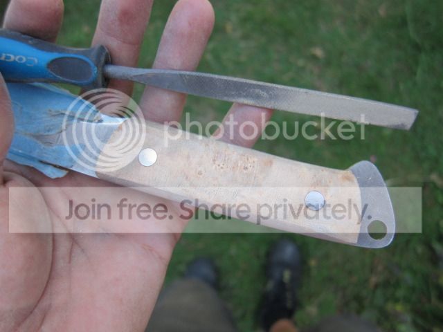

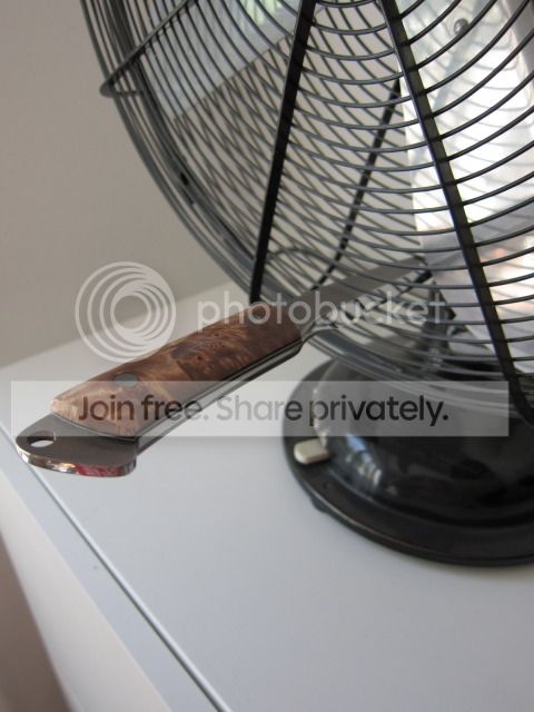

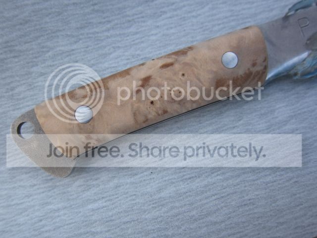

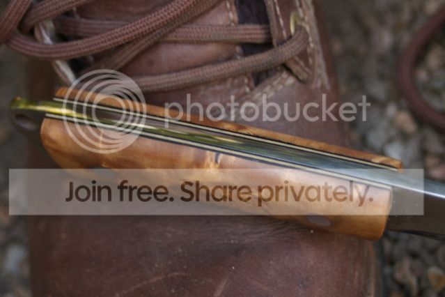

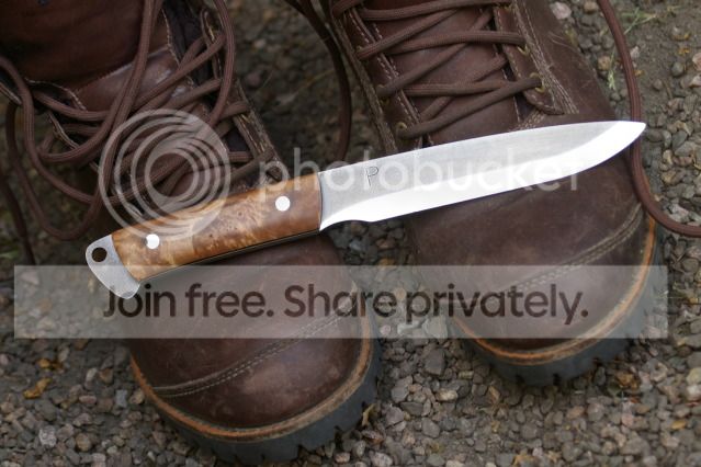

I decided do go zen with this one although its just a prototype.

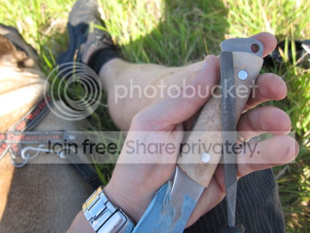

I used a paint stick to back up the paper.

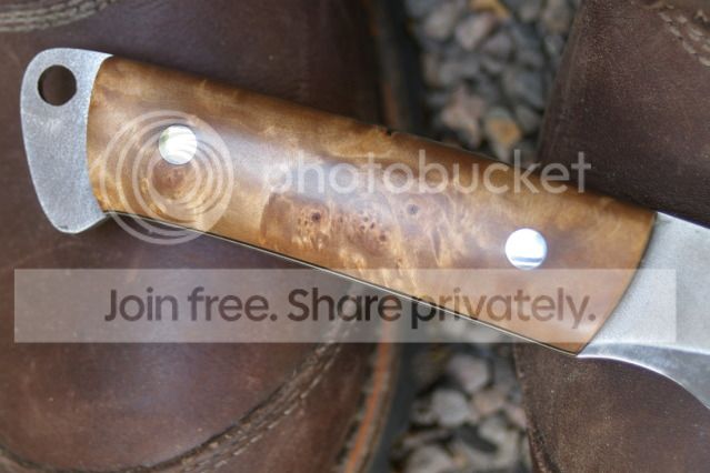

Progression. Öberg cut file, fine file, by this time the over all shape was finished. 80, 100, 120, 240, 320, 400 clean of whit ethanol. Polish metal parts. Clean of whit ethanol. 400 and polish wood parts. Clean of and danish oil.

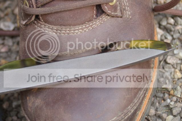

Cool blade man! I like it.

Looks good. I like the shape, looks very utilitarian.
