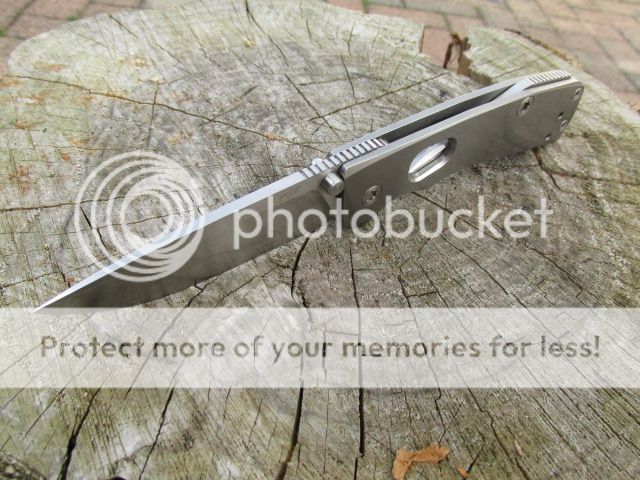

Also I thought you might like this
I can't like it if I don't know what it is.
Could you please tell us what you've posted ?
I'm sure many know, but I've never seen one, and have no idea. Thanks.
You will not have seen it before.
It is a sort of cross between a frame lock and a back lock.
The lock bar locks against a ramp like a frame lock so the lock bar is in compression, like a frame lock. Construction is more like a back lock.
I wouldn't say it is a fixed folder but it certainly locks up solid and reliably.
It is not the finished article yet but is getting close.
Thanks !
Who is making those ?
Got another pic of the lock engaging the tang? Does it engage/disengage side to side or up and down?
That is difficult to show with a photo. Lock engages vertically in the upward direction and is disengaged by pushing it down through the window.
I don't want to derail the thread too far, there are a few more pics and a video on Edge Matters Forum http://edgematters.uk/thread/2301-something-new/
That's pretty impressive. Really interesting design, when you mentioned you disengage the lock by pushing it down through the window I couldn't see how that would work without being clumsy, but in that video it actually looks pretty slick. Nice work!
