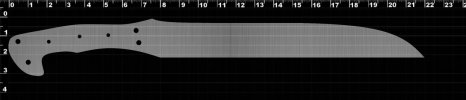

Here is a basic concept so far. I might as well send it to him and see what he says. I'd love to hear all your thoughts too.

N NWPM2 , You really inspired me, and though I was going to shy away from a sheepcliffe design, I'm glad I didn't. This is my dream Spyderco.
That's really nice of Spyderco to reply to you so quickly. I'm constantly impressed by the consistency and speed with which everyone in the company seems to respond to their customers.
I really like that design in the picture you posted above. That blade shape is exactly what I was picturing in my head. The full length cutting edge looks superb and the slight downward angle of the blade look great. (I don't know the terms here, but if the knife were open and on a flat surface, I like how the tip touches the surface and then the edge rises off the flat surface as you go toward the pivot.) I think your placement of the holes for the clip are perfect! I assume it's on purpose, but the angles of the holes look perfect. When tip up, the knife would angle toward the seam of your front pocket and when tip down it would allow access to the CBBL.
The overall design strikes me as somewhat reminiscent of a Manix 2 lightweight with G10 for handles along with a bit of Manix XL thrown in there as well. I'd imagine the internals of the Manix 2 lightweight would work with your design.
I also watched a disassembly video of a Native Chief the other day. That one looked like it had phosphor bronze washers riding against G10. I've never heard anyone complain about the durability of that knife. That's also coming out in S90V so I imagine it's selling really well for Spyderco.
I have never had or used LC200N steel. That might make the knife appeal to a much wider audience since it would be extremely corrosion resistant.
I do have one very selfish request: A deep carry clip that fits the standard Spyderco screw pattern. I think that would be a big source of controversy.
Edit: I think this is pretty obscure, but I wonder if a variation of the Janisong clip could be used. The hole pattern on that is very wide, but I like the clip.

I threw out some vague terms in an attempt to convey a few poorly formed images I had in my head. You deserve the credit for running with it! My suggestions were actually inspired by looking at the other pieces you made.

In looking at the pictures a little more, are you thinking of some type of G10 or metal backspacer for the knife? I see 6 screws running along the top edge of the handles. From the pivot moving toward the back, I assume there would be some sort of metal insert for the CBBL mechanism that would likely take the first two pairs of body screws. I think a backspacer would likely need at least two locating pins anchored in the G10 along with the remaining pair of screws. The backspacer might be a good opportunity to add a contrasting color for a little visual interest.
Thank you very much for the kind words. Yes, I thought carefully about everything I did up there, especially clip placement. That's not to say I didn't make any mistakes, I may very well have, but I am sure they will be revealed soon if they exist. I have multiple layers, including the lock and tang, but they are not ready. I might see if I can leave the engineering intricacies of lining those up just right to Spyderco. If not, I'll seek help with it from the community.
You'll note the lack of a lanyard fob hole. There is no need on such a large knife. If someone wants it badly enough they can use a drill! ;)
Sal has stated that Spyderco will not get into deep carry clips, because Spyderco doesn't want to step on the toes of craftsman who have carved out niches for themselves making and selling after market clips. I would be getting an MXGear clip for mine.

Yes, the first two body screws are for the lock bar, and the last one would be for a stand off. Keeps the weight down. Maybe a backspacer would be called for though to balance the knife.
Lanyard/fob acceptance: For the most part I think they're overrated on folders but for a knife using LC200n you're probably looking at people that would take this out to the water where some type of line to the knife would be a way of not losing it. Also, I use fobs on several of my 4" bladed folders and pull the clip off so the fob sits at the top of the pocket and the knife is allowed a more natural position within my pocket. Probably not in the majority there. I have one on my millie and had one on my buck 110 LT but moved that to a belt pouch carry so I removed it. I like using bails and fobs even, blend in some of the aesthetics from the old scout slipjoints.
I think a slight adjustment to the front "guard" spot to cover up the exposed blade tang when the knife is folded could be a nice touch if it can be integrated in without making it a pecking point in the pocket, like flipper tabs tend to be. I think some slight scalloping of the handle near the spydie hole, like the endura and delica, wouldn't hurt my feelings, even if just to smooth it out for a sliding point into the spydie hole.
I could see the pinky beak and pocket clip area being weird catching a pocket lip, but that's purely a theoretical problem that could be vetted with some quick testing, just a thought at this point and maybe not an actual problem
Lastly, and this is theoretical, but I think the pivot may be a little too far forward as conceptually it seems like there would be very little steel on the area at the backside of the blade around the pivot. I would have to measure my millie there to see what they have but in a larger folder that may get used I think that would be a weak point. I believe the spyderco tatanka had a weak spot in the pivot and it was a point of failure in some destruction videos on youtube, maybe it was one of the cold steel challenge vids. Purely theoretical and basing that solely on the looks and proportions of the image and that's something I would base on numerical data of what spyderco already has on their knives, like your resilience.
Any plans for gimping on the thumb ramp or back of the handle like the manix 2 has? Maybe some around the butt for the thumb for reverse grip shenanigans?

Awesome. I really like the design you came up with. The larger “sheepcliffe” blade with the negative angle is sweet! I really like how you made it 4.25 cutting edge which is a little different for spyderco. It looks comfortable in reverse grip too, I hope this comes to fruition. So what’s the name gonna be the David Mary Sheepcliffe!?

I really like the clip placement you put in your concept. I think leaving out the lanyard/fob hole is the right call. I could see them being useful on a smaller knife, but not called for on a larger knife. That's especially true when the lanyard hold interferes with the clip placement.

However: the Sheepsfoot and Wharnie are well covered now by Spyderco (Caribbean and Yojumbo). And the Yojumbo is something else ... I suggest not to compete with it, you'll loose :)
What's missing in the current line-up is a large Bowie-type blade shape with a straight top-edge'ed tip, like the Chinook 1 (not a Persian trailing point like the Chinook 4).
Some chamfering would be called for, certainly but I don't want to make any change that will alter the existing outline, except perhaps to deepen the entire inward curve of the front of the handle. That is a possibility. On the to do list to play with it.
It can use some refinement for the reasons you stated, and for aesthetic purposes. On the to do list.
pivot may be a little too far forward...
The center of the pivot on my Resilience is just under 3/8" away from the front of the scales. I set up the knife above to be a touch more than that. I think it will be strong. And the further back the pivot goes, the less blade length we get relative to handle length, so I didn't want to go too far back.
Absolutely. The is going to be a Filipino grip focused knife, but it is designed to allow a saber grip nonetheless, although the force vector for thrusting or piercing in that grip is not anywhere near as efficient as something like the Military or Police.
