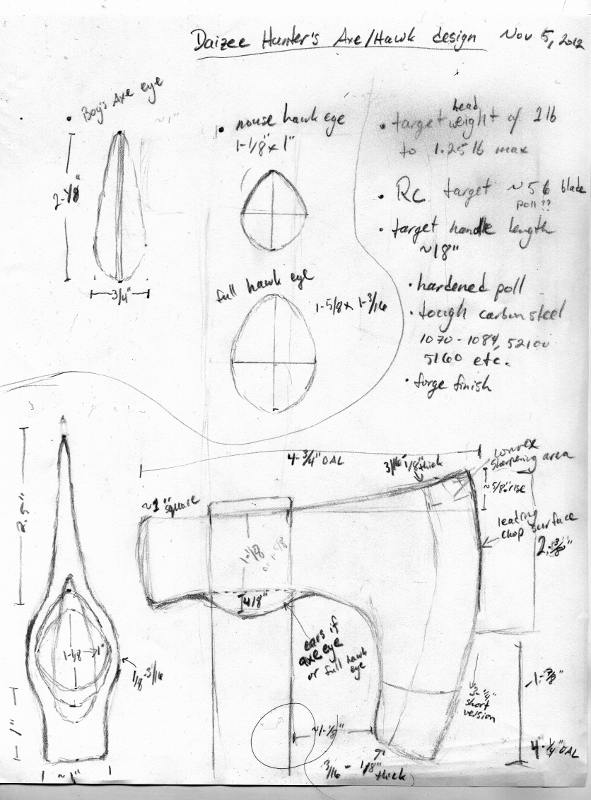

I voted for a hatchet. Several years ago I posted this drawing to this forum. Since then, I've perhaps been persuaded that a hatchet eye would be better:

The bevels are way too close to the bit. If I recall that was the largest complaint about the woodcraft. Here is where hands on experience and testing come into play.

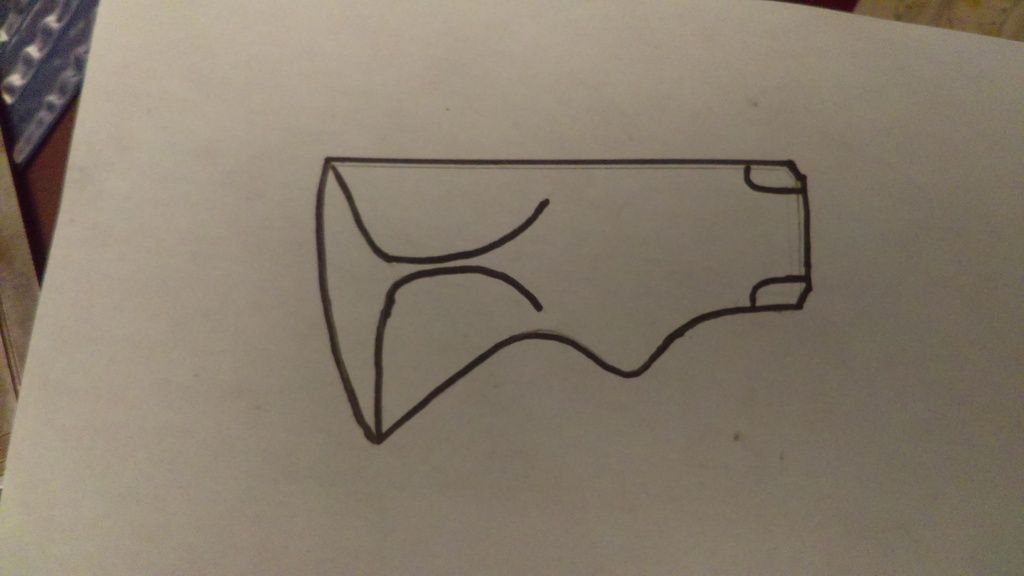

that's a damn decent lookin head. at first i wasnt so keen on the idea of another backpack size single. i love those glassport style bevels. i saw a few people talking about handles, the thing is i was just thinking about making the head to keep price down. now, slip fit and wedge fit, the only difference i see is eye size and the taper of the eye. so why not both. oversized eye for slip fit and just have a shoulder and a kerf for the wedge handle. sure we'd need to make our own handles but... we're kinda already doing that.
we could a have a handle that's slip fit but with a shoulder, so if you wanted slip fit, take the shoulder off, if you want wedge fit, take the, the, the... "top" of the handle down until it'll take a wedge and crosswedge
For reference, the design iterations that I've posted don't have "phantom bevels" in the traditional sense. The bit has a consistent cross section with a high centerline that tapers towards the edge. The bevel shape is the result of applying a bevel to that cross section. This is more like the way that the chip breaker ridge on a broad axe is done, not like phantom bevels. Phantom bevels will "wear out" as you wear through the thicker region between them and the edge, while a full-length tapered ridge line will remain correct no matter how far back you grind it. If you're familiar with Scandinavian-style splitting axes they use a similar kind of a grind where the bit is given a diamond-like tapered cross section and the edge bevel ground into that.

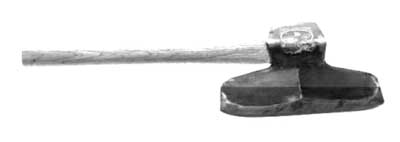

You actually don't need a shoulder to wedge-fit. It just makes the job easier. But having a short, extended, removable shoulder region would allow for increased ease of wedge-fitting. Slip-fit eyes taper in all directions, while most wedge-fit eyes only taper side to side, so cross-wedging is typically necessary to fill the top of the eye. I usually use a "‡" double cross wedge. Here's a little 250g Rinaldi "Sicilia" axe I'm making into a shepherd's axe.
It's a matter of how strong the hollowing would be. Bringing it to a hard line shows the ridge clearly, but in practice it wouldn't be so sharp and would transition into the thin cheeks gradually enough to keep it from biting in, but the majority of the hollowed regions would be nice and thin, and would have to be to keep that broad and deep of a bit without turning into an anchor. :D
Your initial description of the bevels leads the reader to believe they will be deep to save weight and "bowl" shaped causing a problem if too close to the bit. This new description does not save on weight and answers the sharpening issue. Which one is it?
Phantom bevels when done correctly do not have that issue because you run out of hardened steel right around the same time that you would encounter an real issue.
And this is what one thinks of with your initial weight saving description and picture. As you can tell to close to the bit would be a bad idea.
Your new description seems like just a pointy high centerline. With perhaps an ever so slightly concavity.
For the record, the new rendition by 42 with glassport bevels and ears and beardless, as phantomknives pointed out and hardened poll looks nice in profile. If you moved the bevels back to the temperline it would solve the sharpening issue. And allow for deep bevels to save weight.
