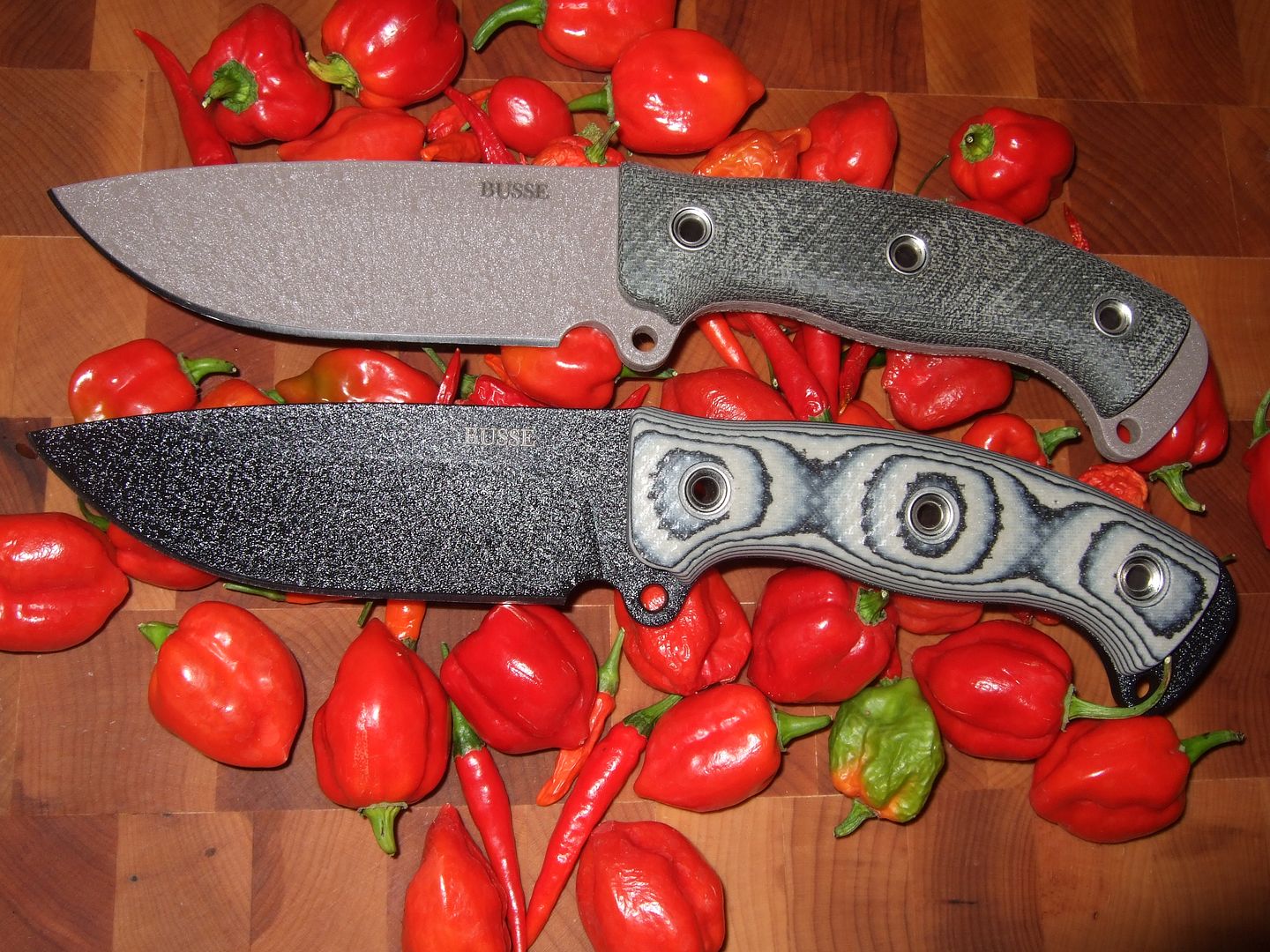

Mine came on Thursday, but I didn't get around to opening the package until today:
I like 'em, but I'm afraid the ergo handles might be just a tad small for my hands.

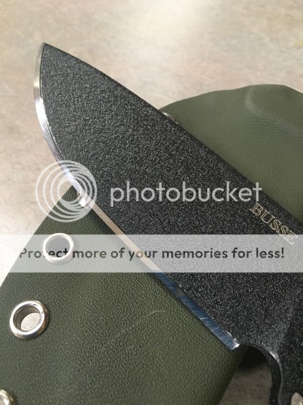

Just spent a couple hours on the WE. Found the factory profile but still needed a little reprofiling. 22 degrees on left side and 24 degrees on right side. Have to add a couple to the one side to make up for the jaws only moving on one side. I was very happy with the edge when I hit the 400 grit stones but kept polishing out all the way to the 1 and .5 micron strops. She now pops hairs like they are not even there.Still not getting a perfect mirror edge I guess because I am using 1500,2000,and 2500 sandpaper between the 1000 grit stones and the strops. Can't wait to see how the edge turns out when I get the ceramic stones.
Thanks,it looks better in person. Those scratch looking marks on the edge are reflections from something. Not there when looking with the naked eye. The darker area toward the back is the reflection of my phone.
Little better shot of the edge. I guess it is more mirrored than I thought.
