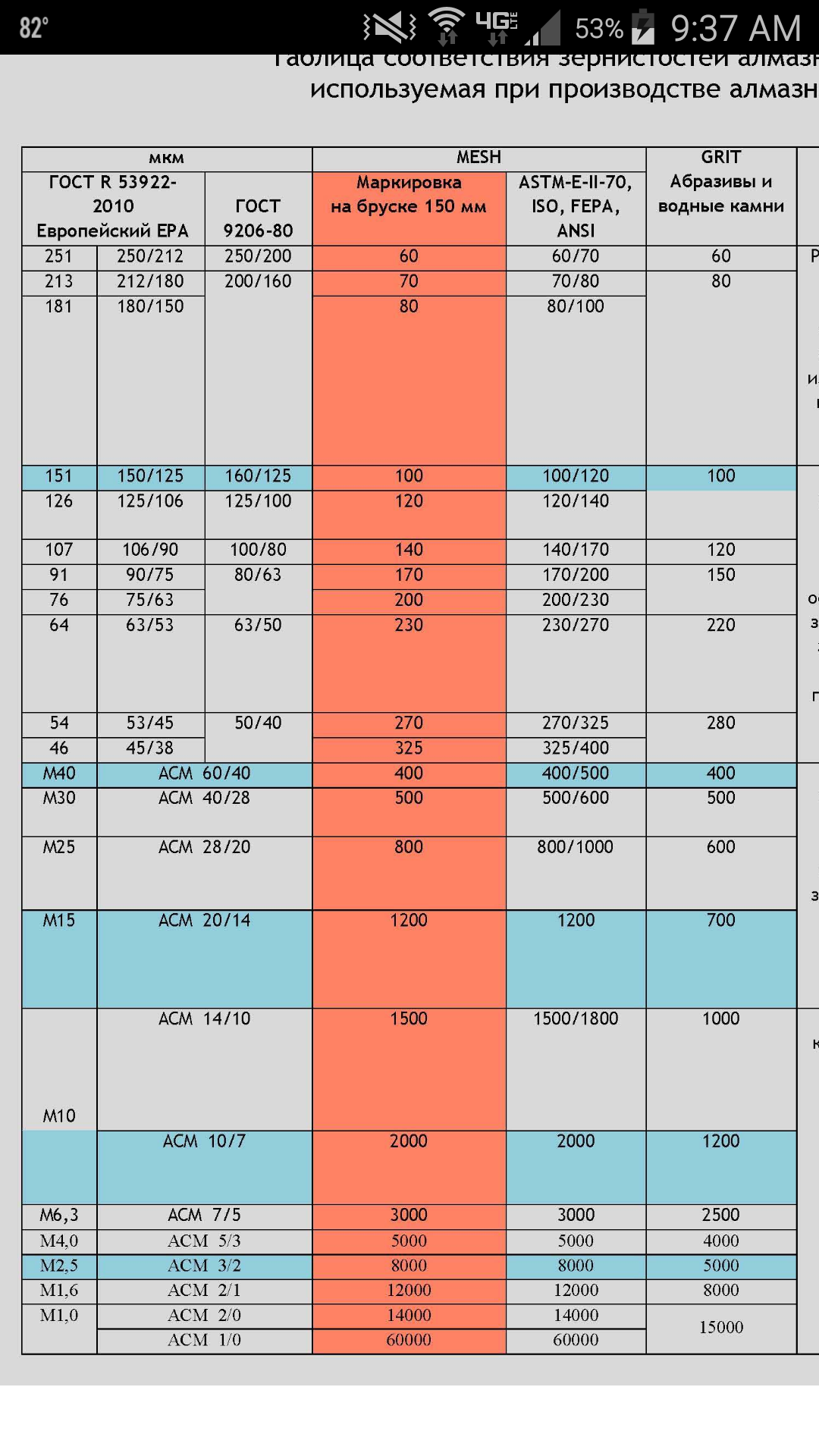

Bodog, can you help translate what that page is saying about grit sizes? I used the google translate, but I have no idea what a given diamond plate they sell has for a micron rating. For example, the stone priced at 1810 rubles, the micron rating given is 200/160-160/125. What does all of that mean??? 200micron? 160? 125? Another example, the very top left stone on the list, it says 3/ 2-1 /0. I have no idea what means.

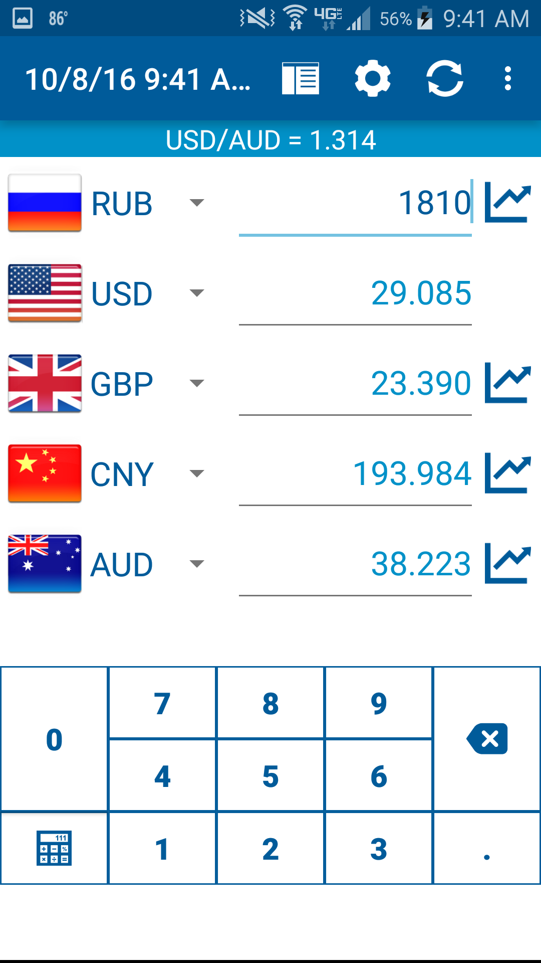

There's a grit comparison chart under helpful info and I had to download a free currency converter app on my android. I've used it multiple times to order several things from that side of the world. As far as the grit sizes I had to write things down to remember and once I got the stones I wrote the grit size on the end of the bar with an arrow pointing to the relevant side so I could refer to it later without needing to look at the chart. Makes it easier for me. The size they're using is the third column from the left until the finer grits and the columns combine.
Also, the lengths are listed like 230h60h20. That's basically saying 230 mm x 60 mm x 20 mm
And here's 1810 p (which is like the dollar sign for rubles)

And they're double sided hones so 200/160-160/125 would be 200/160 (80 grit) on one side and 160/125 (100 grit) on the other. I think that most of their hones are a little more sensibly spaced out than the one you're referring to.
3/2-1/0 would be 5000 grit on one side and 15000 on the other.

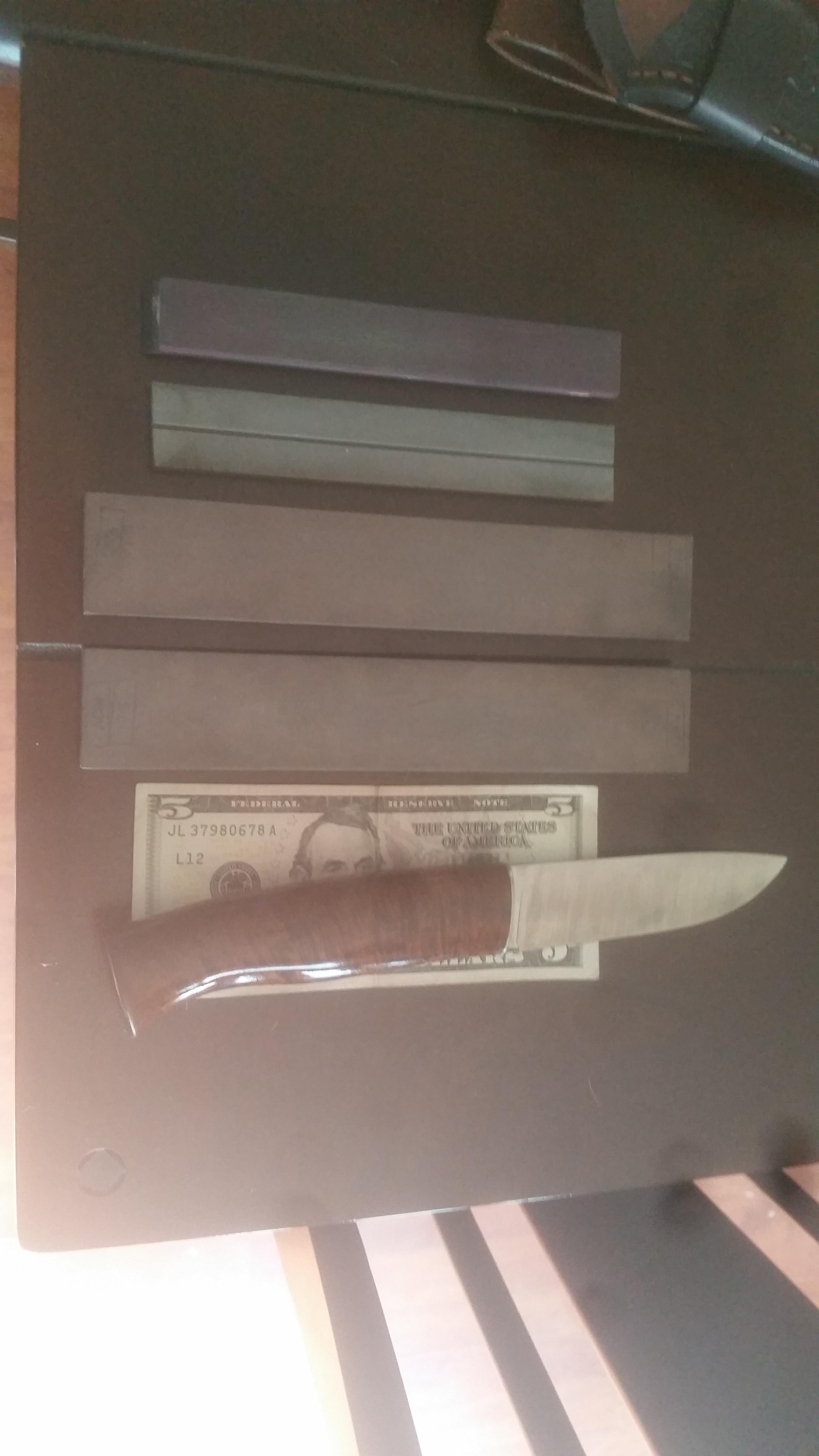

Here's what I have. Edge pro sizes on the left (Chinese stone on the far left, ez lap next to it, and two double sided vid hones on the right.
I've use these to put the edge bevels on 15V, K390, Rex 121, and Vanadis 10 knives. For anyone who knows these are some of the most wear resistant steels out there, let alone regular knife steels. And when I say I put edge bevels on, that's what i mean. Not reprofiling or whatever. As in the blades didn't have an edge at all and these stones put one on them. That's a lot of steel to remove. The knife pictured was one. That's 15V at 62 RC.
