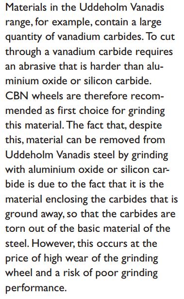

I've never doubted either of your abilities to sharpen knives. My point was that there's a finite limit to how far SiC or AlOx will go in refining vanadium carbides within the steel (which are way harder than the steel matrix's 64RC; Crucible Metals listed VC at 82-84 HRC). Polishing the steel (in aggregate) and producing sharp edges with a somewhat softer abrasive is one thing, and will go as far as the carbides in the steel will allow. Going further in abrading and polishing the vanadium carbides themselves is another, in using material that isn't hard enough to do it in the most literal sense, limited by it's physical properties at the molecular level; it's impossible when the basic physics of the abrasive material won't support it. This is (still) the point I'm emphasizing, and is something worthwhile to consider for someone looking to maintain, refine or polish to levels limited only by their own preferences and abilities, and not limited by the materials or tools they're using.
From Uddeholm, on the topic of grinding high-VC tool steels (yes, with powered means, and they recommend CBN for that; basic physical properties/hardness of the materials still apply, and won't change when used on stones by hand):
(text excerpted from .pdf document at site -->: http://www.uddeholm.com/files/TB_grinding-english.pdf )

OK, that all has some value in the Commercial grinding part of it all as tool wear can have a real effect on the whole process, and it would actually show up in the process as in tool wear in commercial grinding....
When sharpening a knife blade, and that's what this thread is all about about in the 1st place it doesn't really matter all that much when some dude is just sitting around and wants his knife to get sharp.
Things start to get over complicated when they really don't need to be as in it's not really all that difficult of a process to begin with.... That is making a knife blade sharp.....
So in the end people can over think things and get all technical about it all while complicating the heck out of it and use this media like diamonds or that media like CBN and put it all under a microscope and write all about how complicated they try and make it all out to be.....
Or....
They can just sharpen the knife with a SIC stone because in the end the result will be the same, the knife will be sharp.... And then cut stuff.
