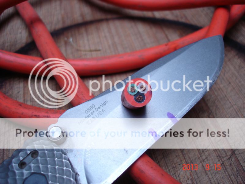

I reprofiled the Elmax blade on my 0560 to 30 degrees inclusive, which created a wide edge bevel on such a thick blade. For what it's worth, I just now used it to cut a three-wire, 12 gauge electrical cable in half. No loss of sharpness. No edge damage.
Did the same thing with my Rukus in S30V with same edge angle. Same result.

I looked on the KAI website and it isn't specific. It says the edges are 18 - 22 degrees but not whether that is included or per side, which makes a big difference.
So do you believe the factory edges are weak and you had to re profile to a different angle to get a stronger edge?
I honestly find that more believable than all this nonsense of burnt edges.

I reprofiled to 30 degrees inclusive because the factory edge was too obtuse to be a good cutter, especially on such a thick blade. I've had no problems with the steel, but I did have to grind away quite a bit of the factory edge to get to a 30-degree angle.
