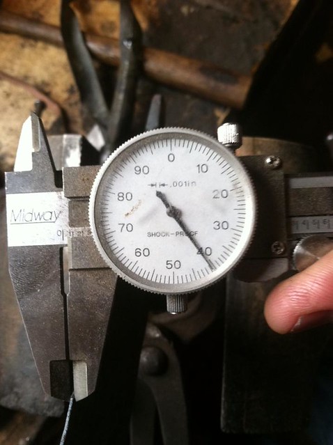

Also for those that keep saying "your steel is already forged from the factory"..... well, maybe hot rolled, but I wouldnt necassarily call that being "forged". When I forge a blade it is within 1/16" from any measurement from the final shape. The edges are forged thin enough to be sharpened right off the anvil.
Here is an edge thickness photo, from an 11" Bowie, right off the anvil....
