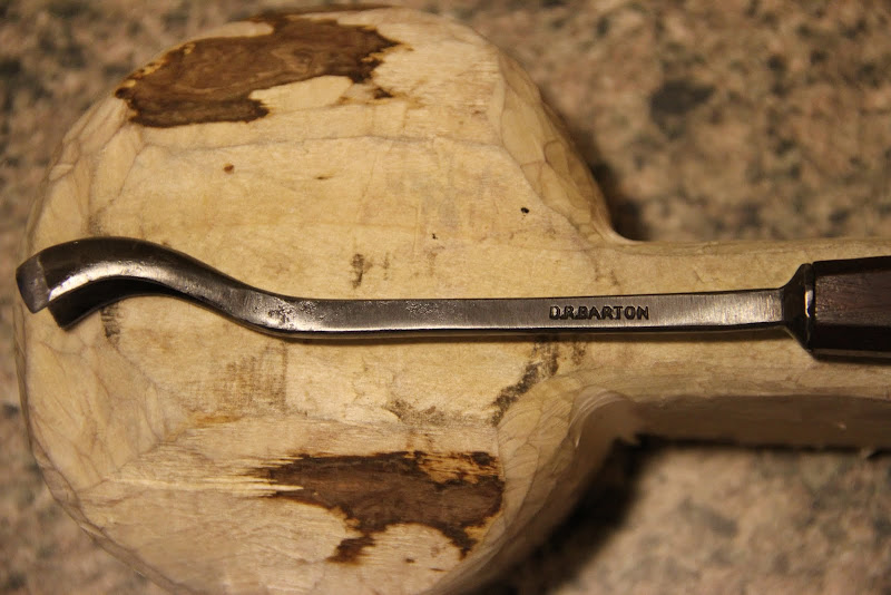

How about a bowl gouge?
This is my "new" old bowl gouge. This is my first project with it and I love it so far. If my research is correct this gouge cannot be newer than 1880. Crazy, huh?
Needs a little more fine tuning. The edge is a little wavy. Do you fellas find it worthwhile to make the edge perfectly straight or just roll with the waviness?

Cool. Tough to sharpen those buggers, ain't it? Got a slip stone yet?
I try to get the edge as straight as possible but I never get them perfect.

No, I don't. I've thrown out a couple bids lately on big lots of sharpening stones, slip stones, strops, etc. but the lots have all gone for WAY more than I have ventured. I'll keep at it, though.
And I forgot to say, that's a nifty piece of carving work. Gonna sand it and finish it?
Thank you, Pegs! I will definitely finish it up. I'm just trying to decide the best way to patch up my mistake.
New slip stones are available at modest prices. I found an old Norton in it's original box at an estate sale for a buck.
Titebond III?
Titebond III?
I have some of that, and it works amazing. I'm just wondering about food safety. I was planning to use this kuksa. I'm thinking I might use clear epoxy, maybe mix in a little fine saw dust. What do you think?
If going that route I'd go with straight epoxy. The wood flour just gets in the way. After the crack has been glued you can fill any remaining cracks with wood flour cement (sawdust & epoxy).
Titebond III website
Titebond III is non-toxic, solvent free and cleans up with water - safer to use than traditional waterproof wood glues. It provides strong initial tack, sands easily without softening and is FDA approved for indirect food contact (cutting boards).

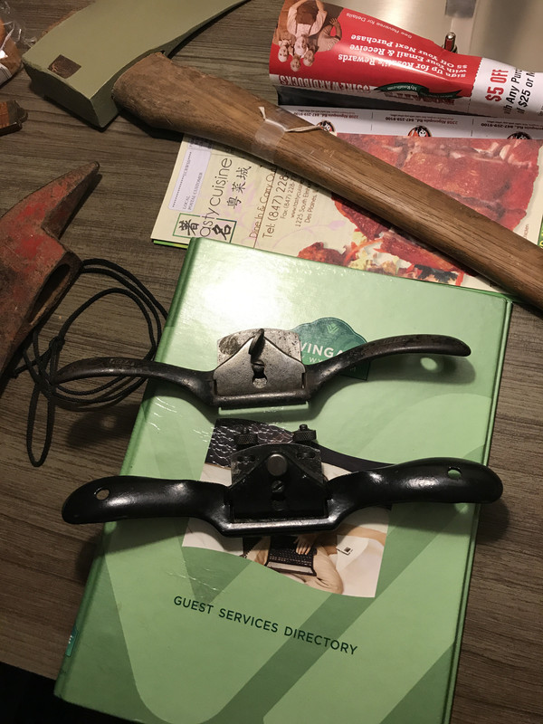

Stanley 51 and a KeenKutter 91.

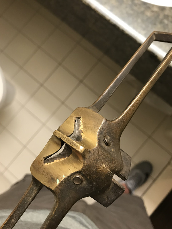

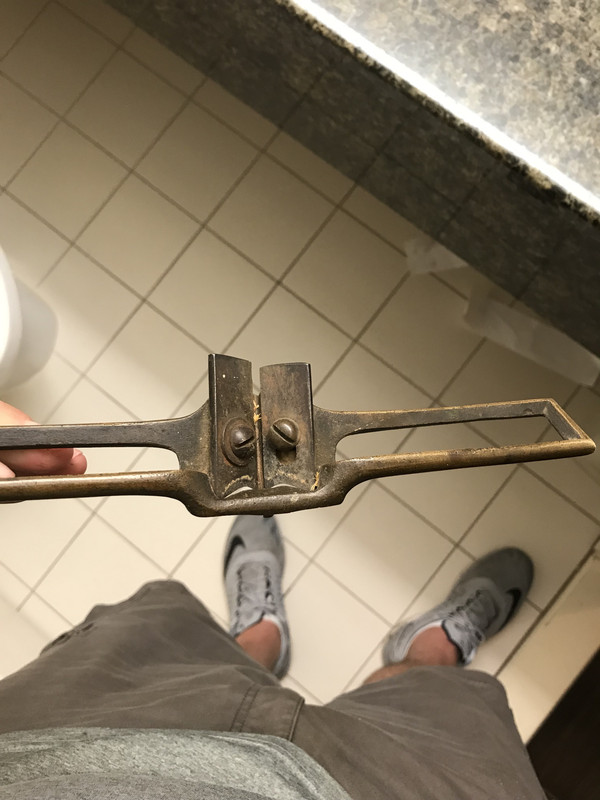

Carriage makers brass chamfer shave.
