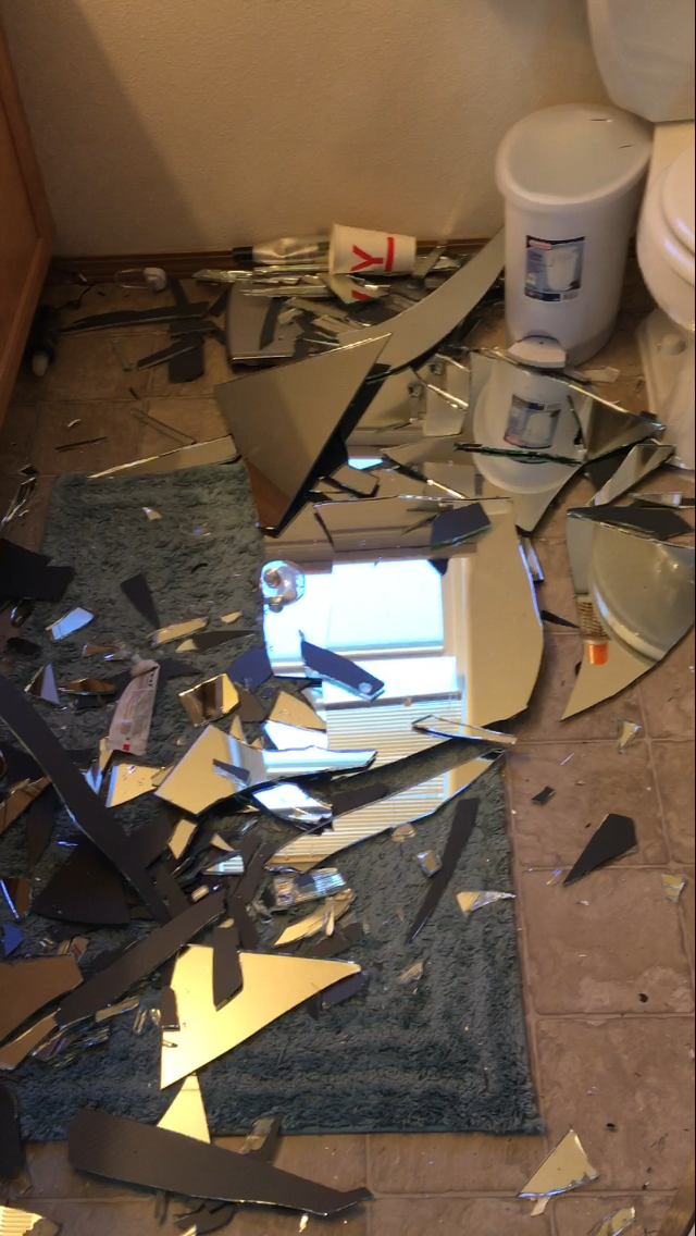

I meant to post more of a response earlier but had to take care of something else that will need to be rehung -

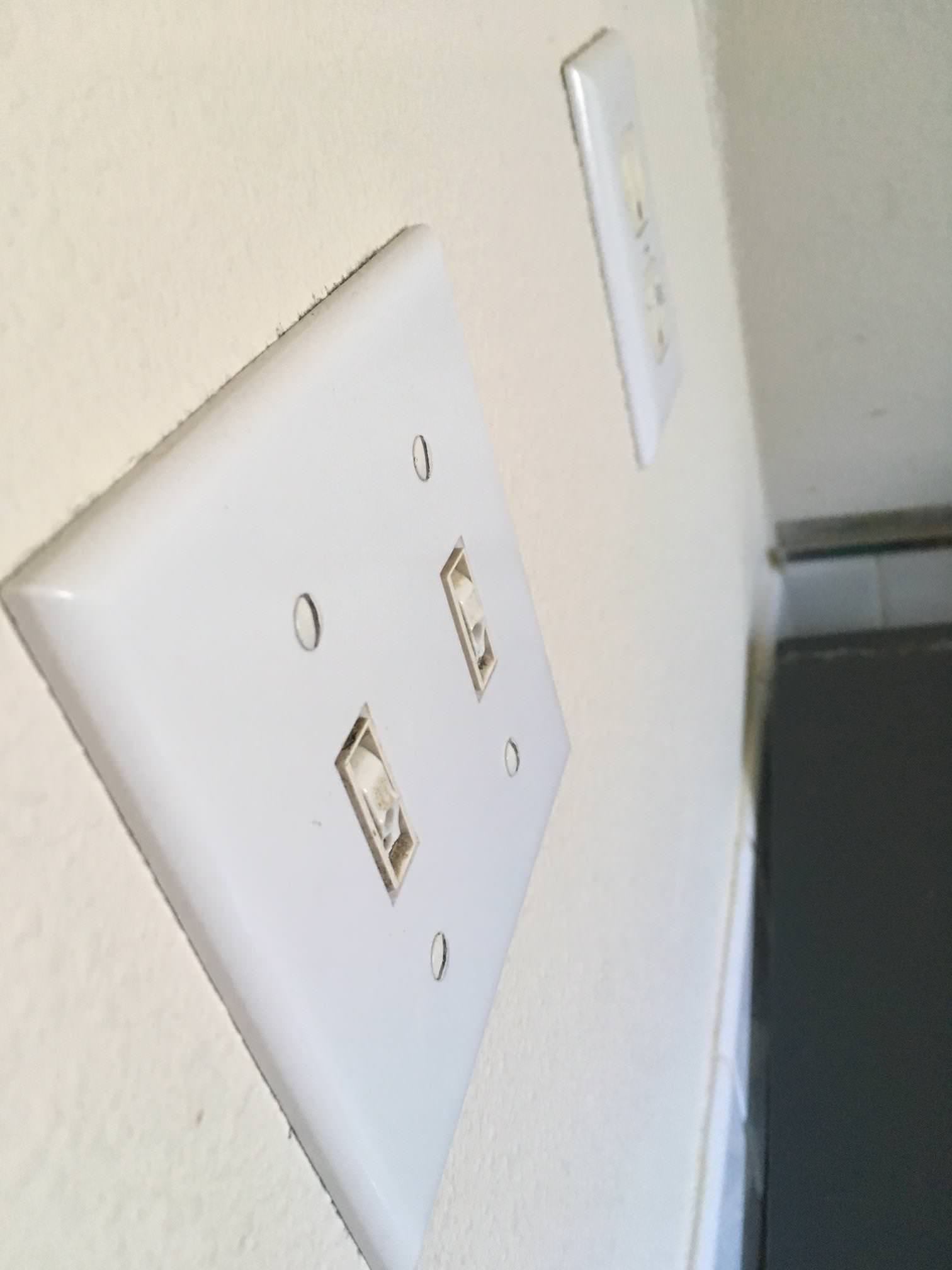

Sheared the light switches off - plenty of edge(s) left on that one lol.
Lol. I was asleep when that thing came down (delayed reaction from the last look maybe). It was almost 6" across and about 5" tall. Took me three loads of glass in boxes to safely get it downstairs. Deaf cat didn't move - "There's something wrong with his medulla oblongata".
