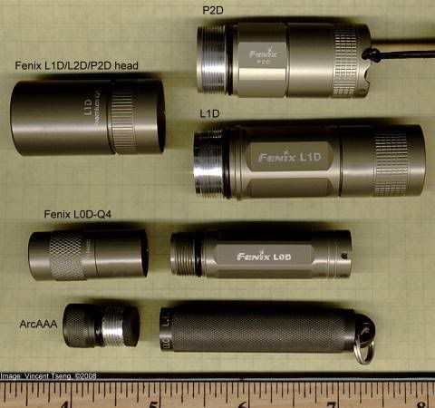

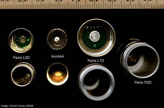

Bodies and heads -
Note my Arc-AAA (circa ~2003) uses a foam doughnut around the +ve terminal on the head to prevent rattling - this is effective but crude, and a known battery crusher - in comparison to the spring in the bottom of the Fenix body tube. see how thin the Arc-AAA tube is - it is indeed a marvel of engineering - but any of the Fenix bodies are noticably thicker.
I would hazard to say in normal usage there isn't going to be much practical difference in durability and toughness between the Arc-AAA and the 1x AAA Fenix L0D -
and probably either the L1D or P2D are likely to be tougher - just due to sheer bulk of material alone.
However when it comes down to it - it's the light that they produce that should matter - and this is where any of the Fenix are streets ahead - not just in sheer brightness alone - but the beam smoothness and quality -

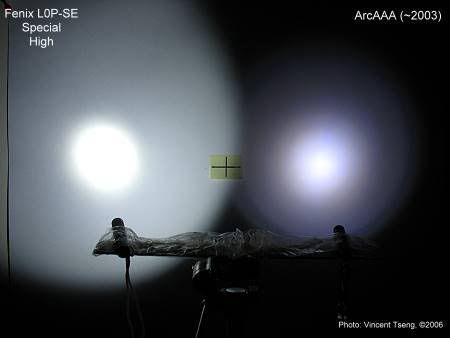

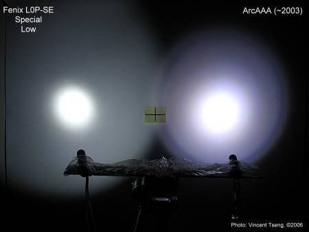

Comparing a Fenix L0P-SE Special with my Arc-AAA
High vs. classic ArcAAA (circa 2003)
(I know, I know, this is pretty silly...)

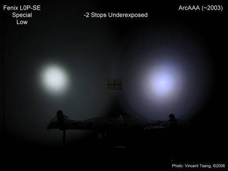

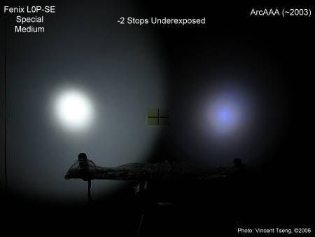

The above was an UNfair comparison - so for closer to the same brightness levels -
Low vs. classic ArcAAA (circa 2003)
At more comparable levels one can easily see how much better the beam quality is in the Fenix over the Arc-AAA.
Also remember this Fenix L0P-SE Special is slightly older technology based on the Luxeon 3 - which is noticably less bright than the Cree-Q series or LumiLEDs Rebel series -

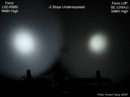

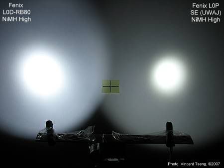

Direct comparison between a Fenix L0D-RB80 and that Fenix L0-SE Special
vs. Fenix L0P-SE Special both using NiMH and on High -
so even the Rebel 80 is noticably brighter than the Luxeon 3 in that L0P-SE special - so a Q4 or Q5 Cree is going to be substantially brighter.
