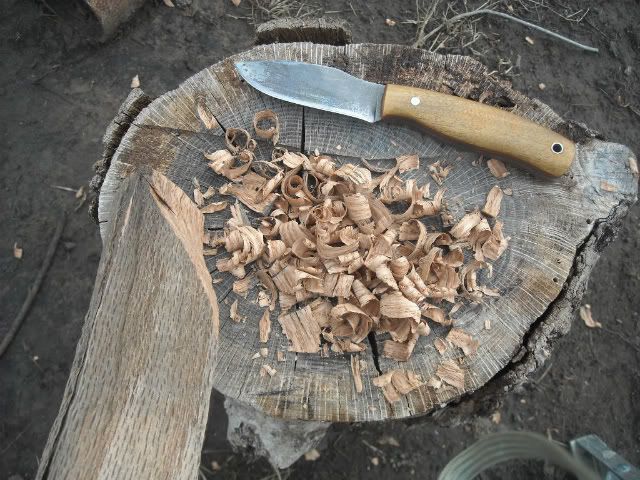

I started out with a piece of white oak that has been seasoned in my wood pile for at least 3 years. This stuff is very hard and I wanted to see how the knife would perform. I nearly whittled the end off this piece of wood. When I got done the blade was noticeably duller, but it would still shave hair.

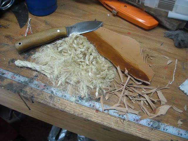

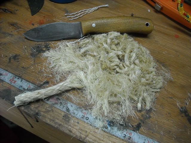

Once I tired of whittling (there was some had fatigue involved), I went in and found some sisal rope about 3/8th dia and proceeded to cut it at 90 degree angles. I soon tired of that and then went at an angle shaving individual threads of sisal off of the rope. After that the blade would not shave hair even though the edge still felt good.
So I started whittling on a piece of scrap leather and it would slice off some thin slivers. I then skived smaller slivers off of the leather and eventually the blade dulled to where it was obvious that the blade needed touched up.
So I grabbed my Razors Edge System stone and hit the blade about 15 to 20 licks and a nice hair shaving edge reappeared. After it was sharpened, I started fooling around seeing how small of a sliver of leather I could cut...
