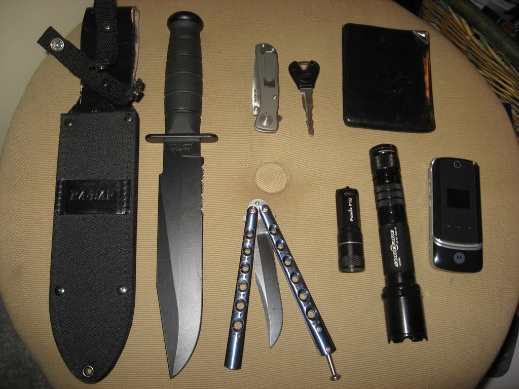

Ka-bar(a joke with my friend, I came into work with it attached to my thigh on the inside of my pants, I had cut a hole in the pocket so I could pull it out. I said to him "hey check this out" he didnt even know I had it)
Benchmade 43(home anodized blue)
SOG Twitch 2
Fenix P1D
Sureire 6p defender (upgraded lamp:380 lumens,gets really hot I can melt plastic with this spotlight)
Motorola krazor
wallet
key
