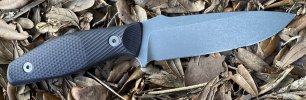

The knife I know, of course, and I'm glad to see you hung onto your PJ Inkosingo. It's such a great knife and you might have just gotten me to carry mine again as we head over the RI line today to see our son and GF's new house that they bought and just moved into. :D

Yea I’m glad I kept it also. It was my first Inkosi and insingo. It has snail trails galore all over it. There’s some good pics of it over in the well worn/weathered CRKs thread.
