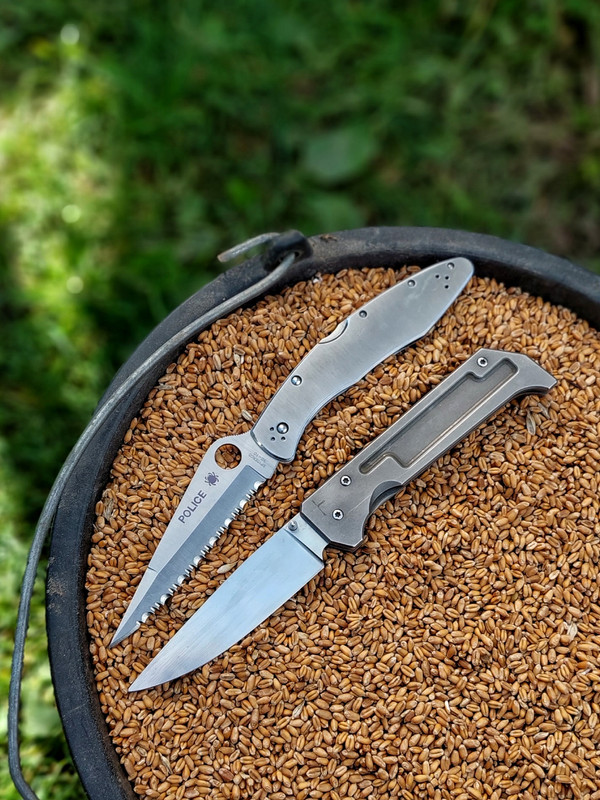

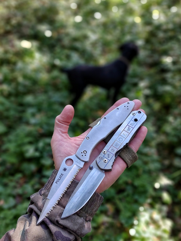

I went with an old favorite today that I acquired some years back for a very reasonable price after it was discontinued. I haven't carried it for a little while and I gave it a touch up on the SharpMaker as its toothy factory edge seemed to have lost its bite. I was surprised that it was sharpened at 15 DPS and swiped it at 20 to give it a nice little micro-bevel using just the stock browns and whites. The action was a little gummy too and I was additionally surprised to discover the knife ran on nylon or teflon washers after lubing with W10 NanoOil, so I flushed it out with isopropyl, gave it an overall bath with Dawn and warm water, then re-lubed after drying it with liquid TriFlow from a needle dispenser along with my usual dab of FinishLine on the detent ball. The action's smooth and free again and the 4 mm thick VG10 blade is pretty damn sharp.
