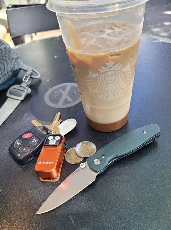

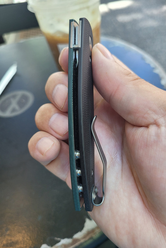

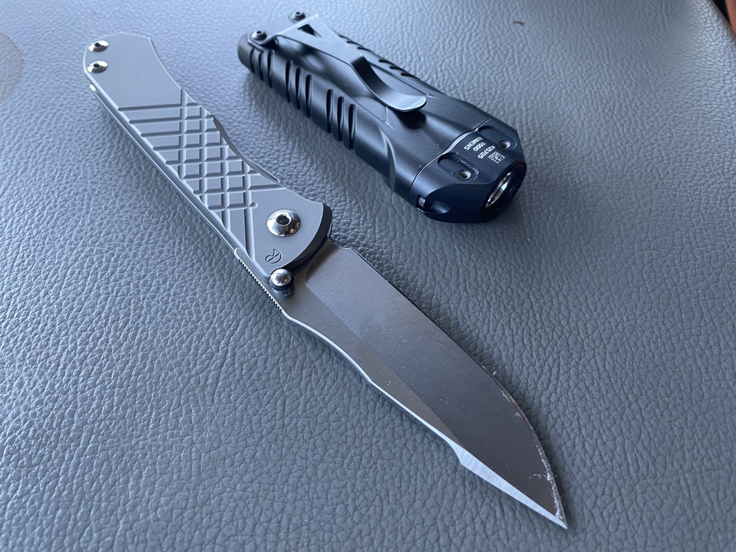

I asked @palonej what degree edge he put on his knives? He said 18°. I asked why? He said because it's Sexy...
I re profiled my EDC Gossman from 22.5° to that SEXY 18°.
I use shapton glass stones on my Hapston R2 black.
Started with 220, 320, 500, 1k, 2k, 3k, 4, the. Ended with 6k. I have 8k 10k and 16k left. But I already spent an hour and need to stop. Beautiful edge indeed. 20250729_121939.jpg20250729_122108.jpg20250729_122125.jpg20250729_122245.jpg20250729_122304.jpg20250729_122324.jpg20250729_121933.jpg20250729_122403.jpg
