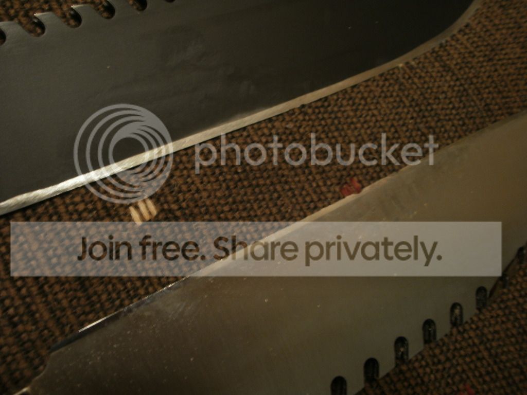

It's a difficult thing for manufacturers to get right it seems. I've seen all sorts of bizarre geometry on a factory edge.
Had a Blur that was at about 8 degrees with an extremely tall bevel on one side and probably 35 degrees on the other. Almost a chisel grind.
Just recently I had a knife the was so obtuse the Wicked Edge guides actually didn't allow enough travel to match it. Spent an hour back-bevelling just to get it to 25dps, which still would've been a bit too thick by my standards.

Here are a couple of my ugly ducklings, (as a beginner, I liked regrinding hollow ground blades to thinner flat or high-saber grinds the most because it's fairly easy):
