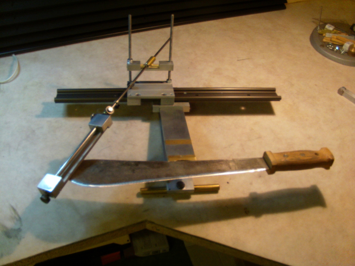

Another question: according to Vadim @wootzblade the best blades' angle is 12 degrees no matter what steel. Do I need the angle to be adjustable or I can do with a simple set up for 12 grade since then it will be very easy to make DIY machine of few pieces of metal scrap but invest in a better stones?
The angle only changes if the blade is curved. As most are. So, even with that system the angle changes at blade tip.Now I understand where the Ruixin copied their clamp design from... blatant rip-off! BTW, the channel that allows to maintain the stone perpendicular to the edge totally eliminates the problem of changing the angle as you move from the middle of the blade to the tip or ricasso area. Genius! The trade off is that the system is quite bulky but... other than that, I like it a lot. EZESharp you said? Of I go to find one!

The mobile pivot unit is way worse than the fixed one for sharpening angle consistency. The fixed pivot unit creates a constant sharpening angle on a straight segment of the blade. When you move the mobile pivot unit, the angle will change unless the straight segment of the blade and the pivot unit rail are aligned to be parallel in 3D with extreme precision.BTW, the channel that allows to maintain the stone perpendicular to the edge totally eliminates the problem of changing the angle as you move from the middle of the blade to the tip or ricasso area. Genius!
And the way they hold the stone introduces many inaccuracies when it is flipped from coarse to fine. So much work in the body but then they hacked the stone holder, what, did they run out of time?The mobile pivot unit is way worse than the fixed one for sharpening angle consistency. The fixed pivot unit creates a constant sharpening angle on a straight segment of the blade. When you move the mobile pivot unit, the angle will change unless the straight segment of the blade and the pivot unit rail are aligned to be parallel in 3D with extreme precision.

Looks like you're all in agreement, on the straight part the angle doesn't change, but for the curve/tip the angle changes, gotta find sweet spot, unless you move the pivot..fixed point is a chimney at a roof...
Every time you move the pivot unit horizontally, the sharpening angle changes. Not only curved parts but also straight parts - zones of the constant angle for fixed pivots. To keep the angle the same when you move the pivot horizontally, you also need to move the pivot vertically. Finding the sweet spot when clamping the knife takes time, but it should be done only once as part of the preparation of the sharpening session. With the mobile pivot unit, you will spend the same amount of time to align the blade in clamps to make it parallel to the horizontal rail. And everything you get is a pivot-independent constant angle for one straight segment (like your nice pictures show). For all other parts of the blade, it's better to secure the pivot at one point and forget about mobility. Because otherwise, it's a nightmare.Looks like you're all in agreement, on the straight part the angle doesn't change, but for the curve/tip the angle changes, gotta find sweet spot, unless you move the pivot
