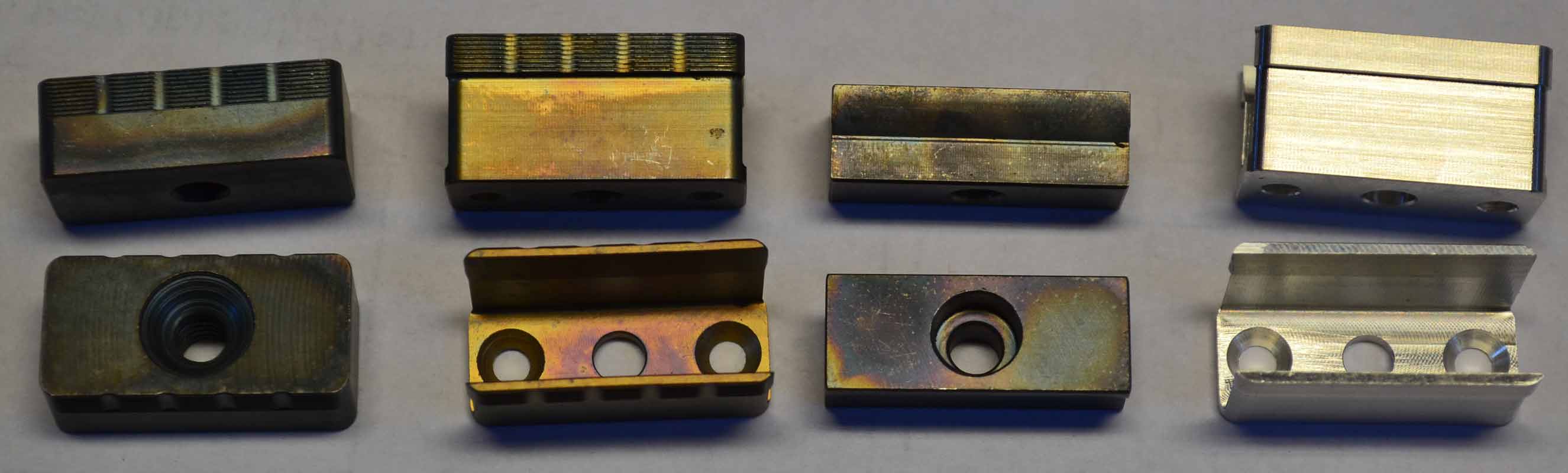

Since you are a programmer and machinist you may be interested in the clamps and stops I am making to hold the parts. They are hopefully a new product I will be making to sell but if that doesn't work out I still need several hundred in the next few months for the fixtures I need to make for a bunch of new parts I have in mind, such as Blues idea of a Sharpmaker that uses EP mounted stones and the aluminum backs for my upcoming bench stones. Here is a photo, part on the right is an aluminum shell for the second op parts. This is my take on the wedge clamps that Miteebite sells as Uniforce. Over the last 20 years, I have always wanted to make some changes so a few years ago I started to, here is kinda the culmination with a few rough edges left.

Since you are a programmer and machinist you may be interested in the clamps and stops I am making to hold the parts. They are hopefuly a new product I will be making to sell but if that doesn't work out I still need several hundered in the next few months for the fixtures I need to make for a bunch of new parts I have in mind, such as Blues idea of a Sharpmaker that uses EP mounted stones and the aluminum backs for my upcoming bench stones. Here is a photo, part on the right is an aluminum shell for the second op parts. This is my take on the wedge clamps that Miteebite sells as Uniforce. Over the last 20 years I have always wanted to make some changes so a few years ago I started to, here is kinda the culmination with a few rough edges left.
Nice clamps, I've used ones with a similar design in the past when running production. Used to make a lot of fixtures before I went into just programming. What kind of mill do you have?
