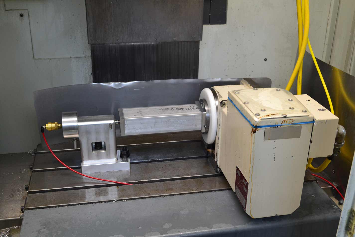

My Kitamura is in a weird position. It has a 15k spindle and 2000 ipm rapids but is an 8,000 lb box way machine with large fine pitch ball screws. My machine is special, the spindle is ready for a rebuild so the previous owner set the spindle drive to max at 6k to prolong it's life. The meter still reads programmed speed so it took me awhile to figure out what was going on. Even though it is a 30 taper is will run chip loads any other machine I have ran would complain about, I do love box ways! Even with a max of 6k for the spindle I can get it to run parts as fast as I can swap them out in the pallet.
I have spent the last few days doing all the programming and have about a10 more days before I have to do other production so hopefully I can get the parts done before then. The first items on the list are to finish machining all of the fixtures. Here is the photo of what they look like now,
how they are held to machine,

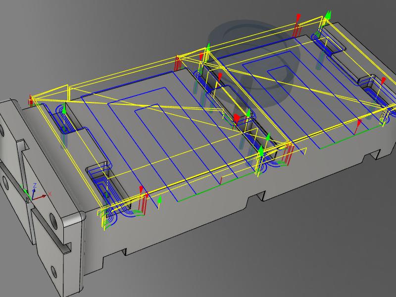

and the cad model showing the tool paths and what one of them will look like when I am done.
To be continued...

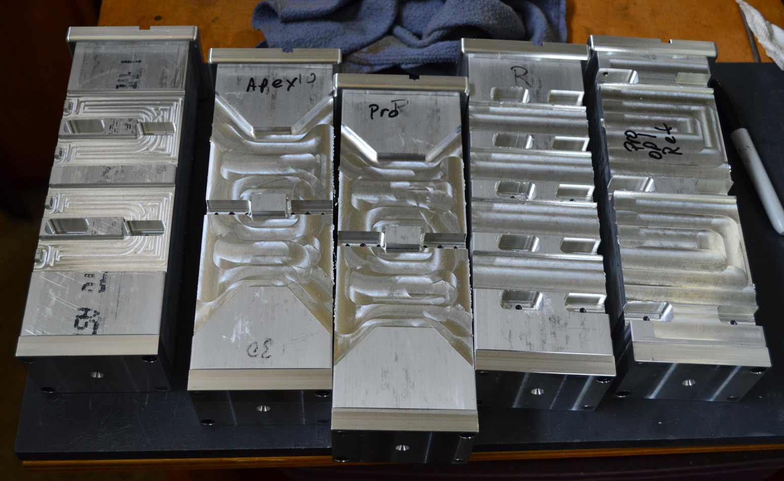

Here are the fixutres roughed to +.004" then left overnight in case they move at all. The aluminum bar is stress relieved but they can move some after machining. Being fixtures I try to make them as accurate as possible.

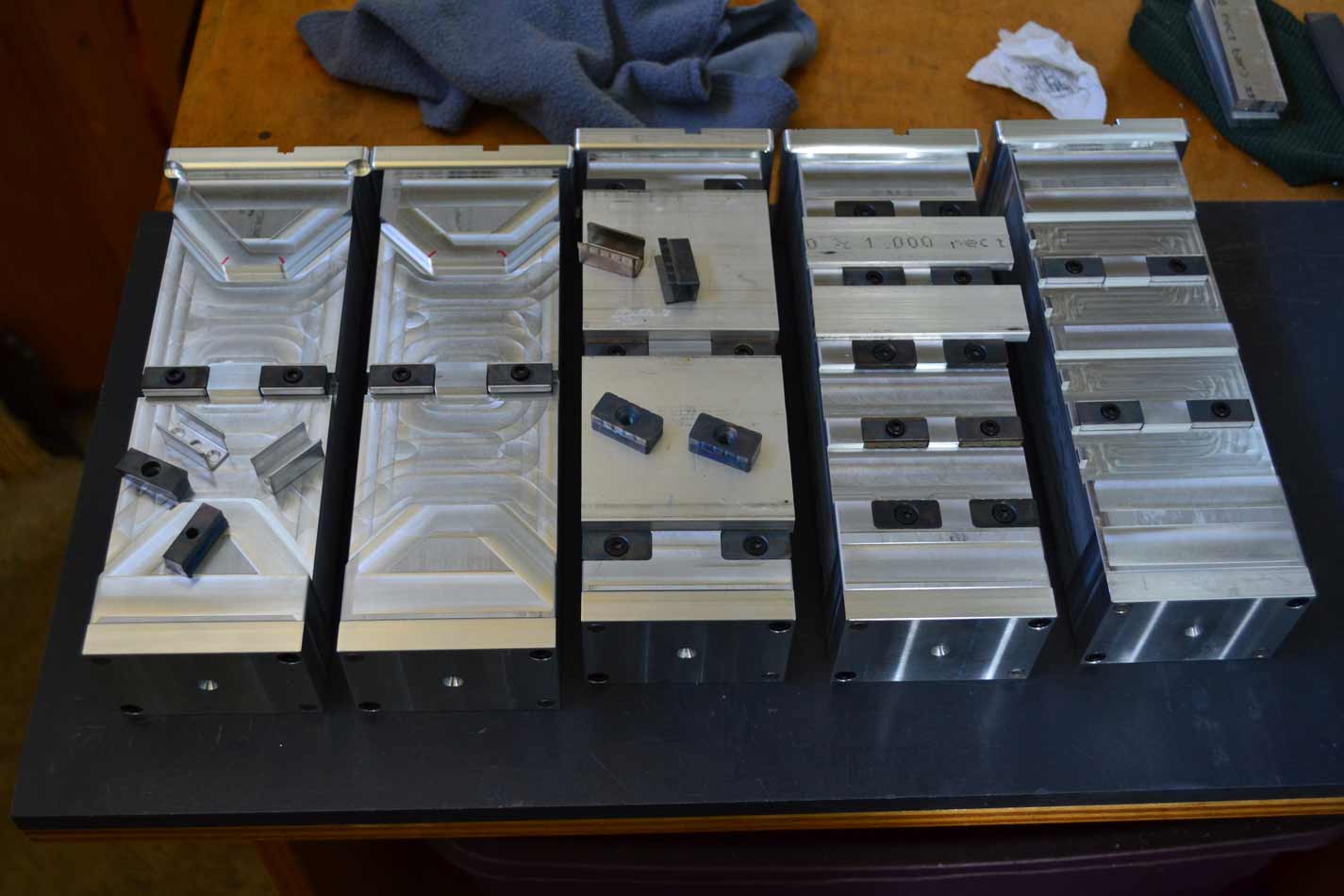

Here are the almost finished fixtures. While double checking things for about the 90th time I caught some radiuses that did not update before I machined the second op body fixtures. The red lines on the two fixtures point to the radiuses than I have to fix. Since they should be larger I have to remove material. In fact for the fixtures they should be clearanced anyway so this gives me that chance to fix another missed detail that I just caught. It's amazing how many details are involved in stuff like this. So the fixtures,

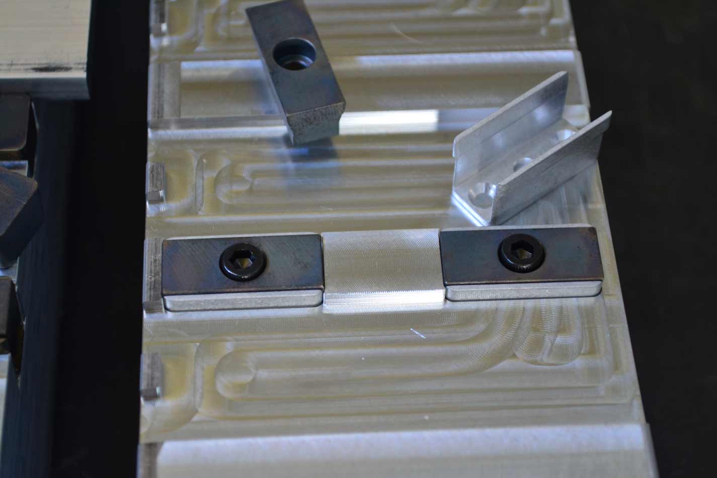

The almost finished fixtures with all the stops and clamps installed. I made all of those too, every detail about them is exactly what I want to hold parts like I am holding.

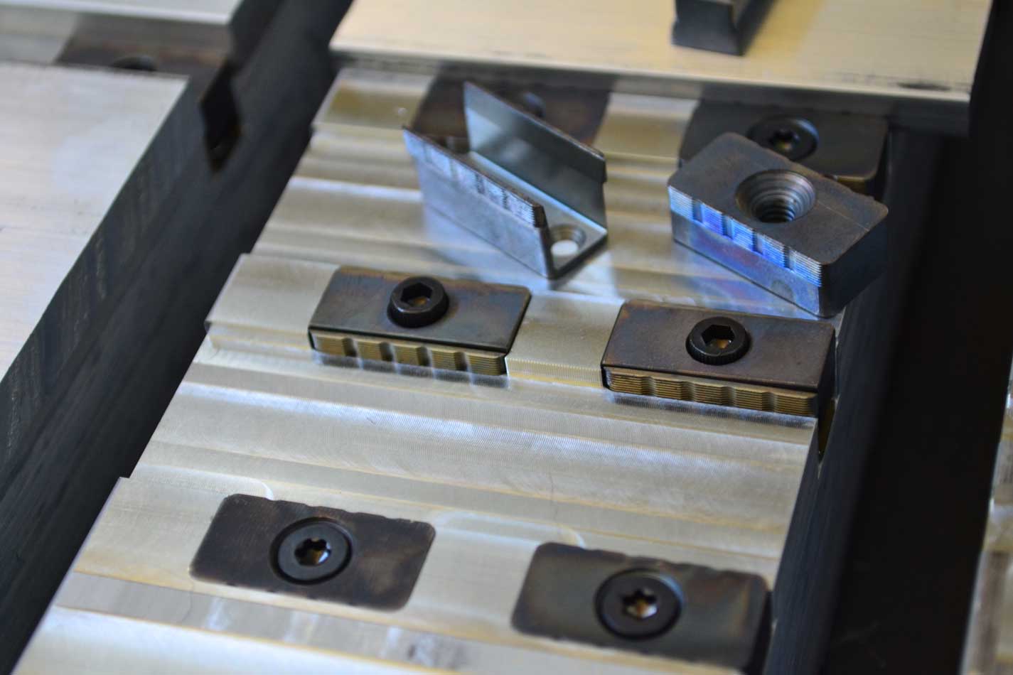

Close up view of one of the first op fixtures with a loose clamp shell and stop. The first op clamps and stops have teeth to bite into the aluminum so I need much less clamping force to hold the parts. They are also hardened to 54hrc so they should last.
The second op fixture has the clamping surfaces cut right into the fixture body both for accuracy and so it is nice and smooth so the parts don't get marked up. The clamp shells are a smooth aluminum surface so they don't mark the parts when clamping. I can't machine as agressively when holding the parts this way.
Forgot to mention so far that the fixutres are double sided so they hold parts on both sides. Because of the wedging action of the clamps if I don't do this it can bend the fixture bodies and I get to make twice as many parts per cycle. I am set up to make 4 bodies and 8 centers per cycle.
