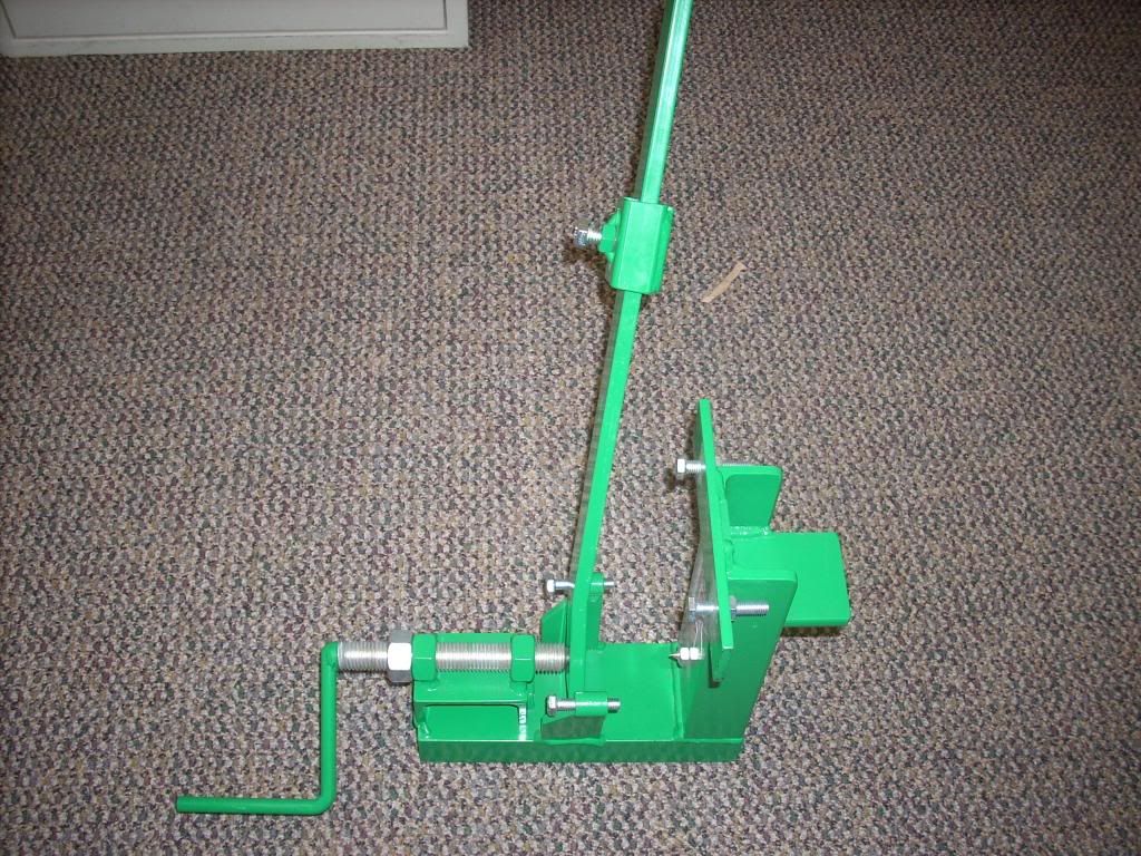

As a machinist/ tool and die maker since 1974, I'm particularly intrigued by moosecreektrail's axe sharpening fixture displayed in post #3...

The radius finding method is totally arbitrary and only serves as a means of creating a pivot location for the jig, whether this is used in the USFS approach or that in the OP. Not all axes will have a bit curvature that's based on a circle with the central point lying on the head. Many will have that point located somewhere out in the space well behind the poll, but it's not as convenient to use such a long arm on a jig. ;)

I just ran across the USFS pamphlet showing the mod for Moosecreektrails belt sander rig. Alas, I'm in the middle of moving and I can't remember which box it's in or if I even saved if from the trash. I'm sure you can obtain it from the USFS if you emailed them. Always wanted to try it. Cool to see it in action!
