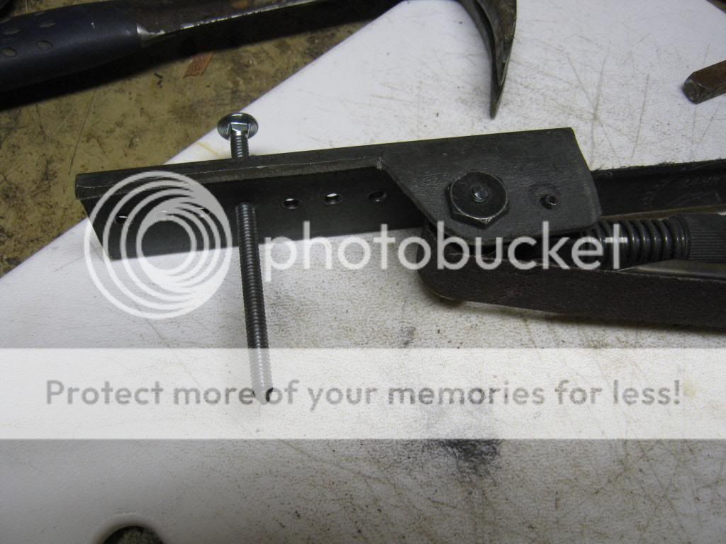

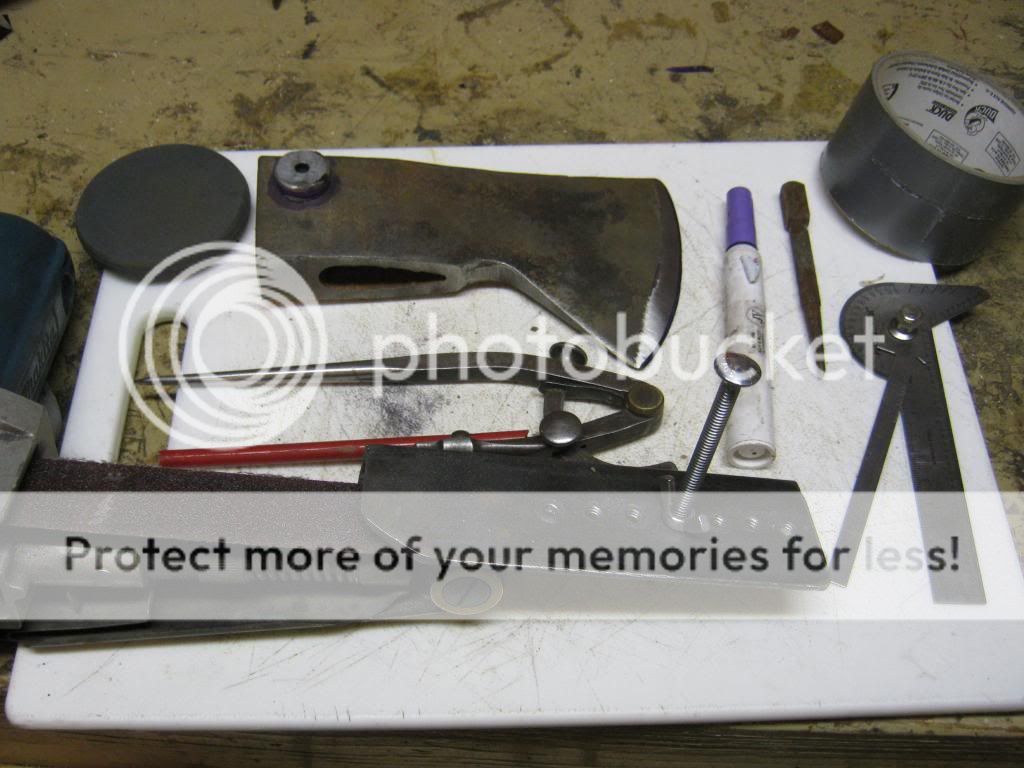

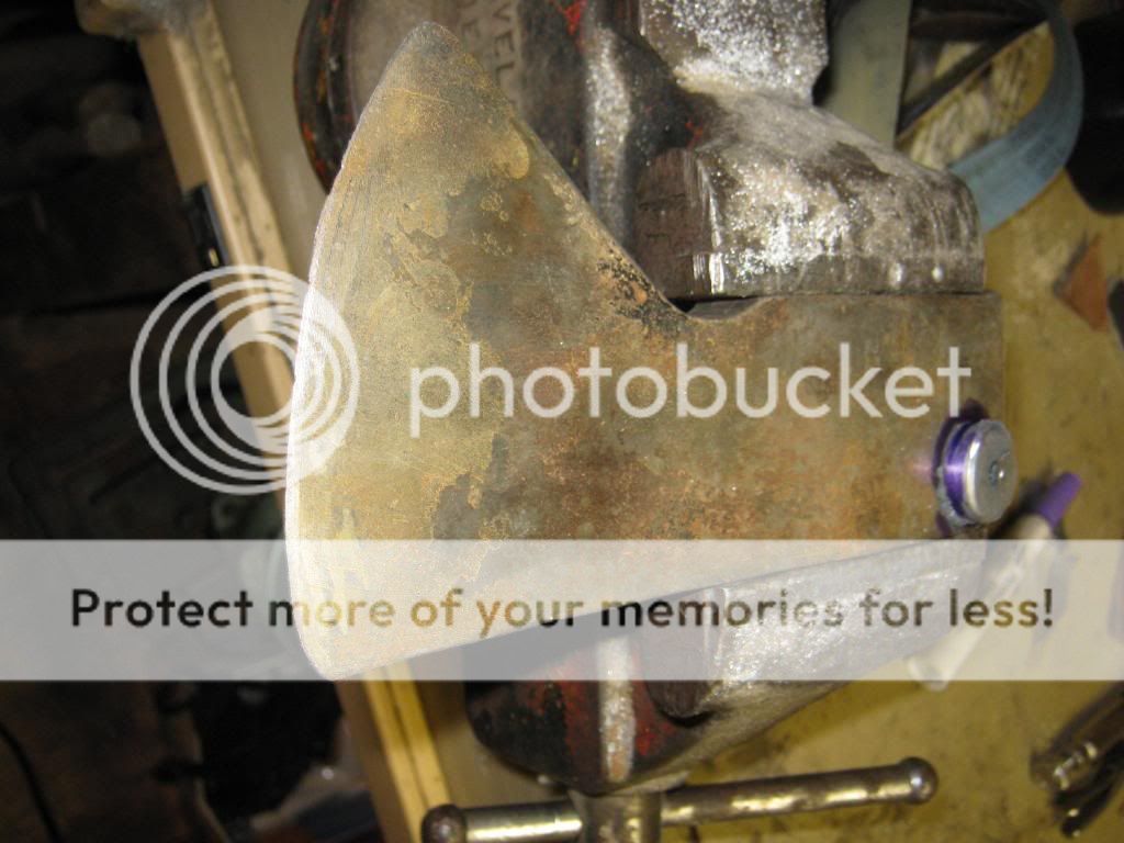

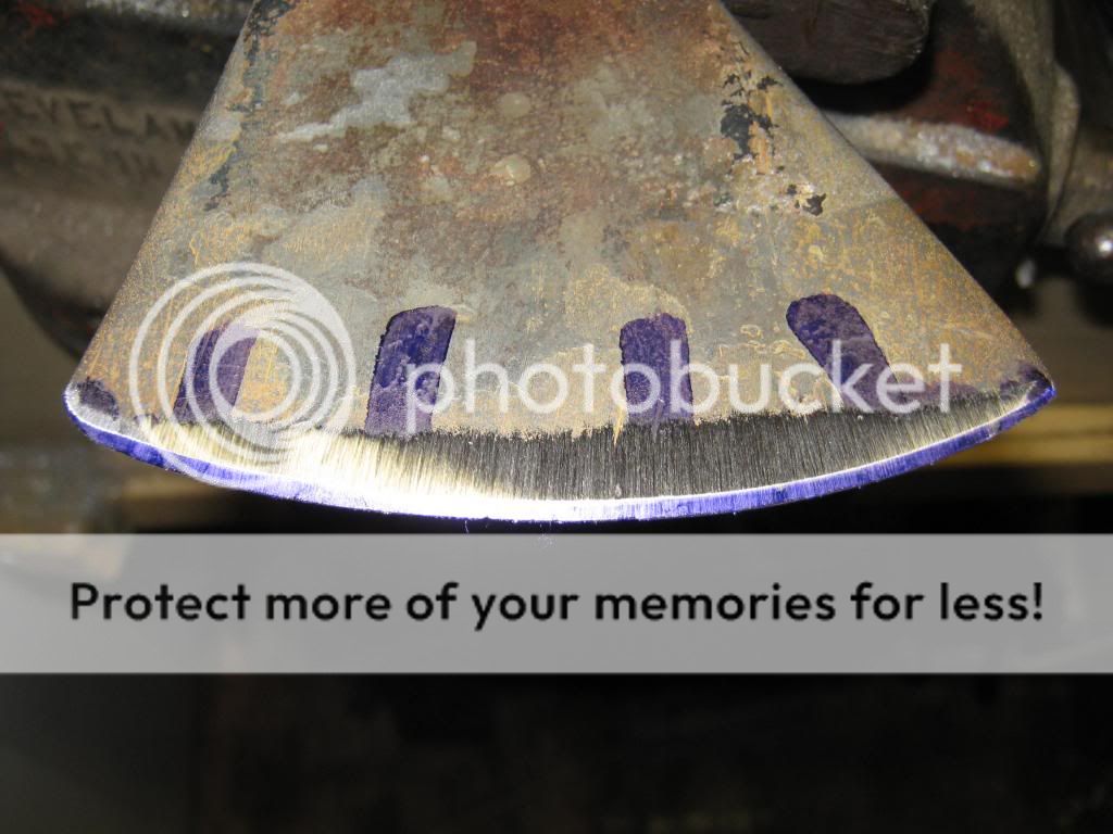

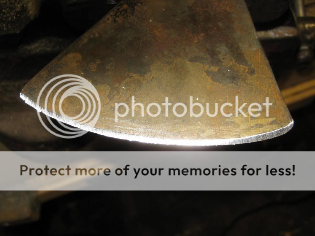

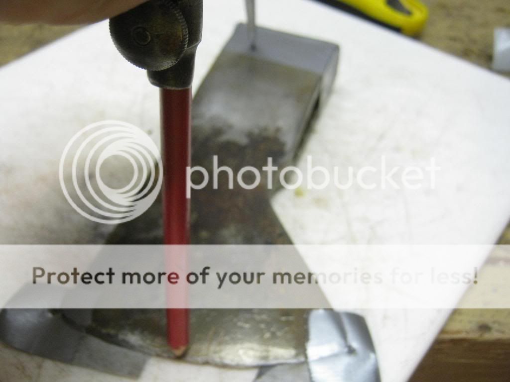

Couple of things I do Different, FYI
1, Make the bracket adjustable,If you make it like the pub,on larger axes the edge is sometimes off the plate.
2,Tape your corners,so when you do the other side you are in the same spot.
3,I use the rare earth magnets(thanks AT sawyer for the idea)so I usually just center punch the spot.
