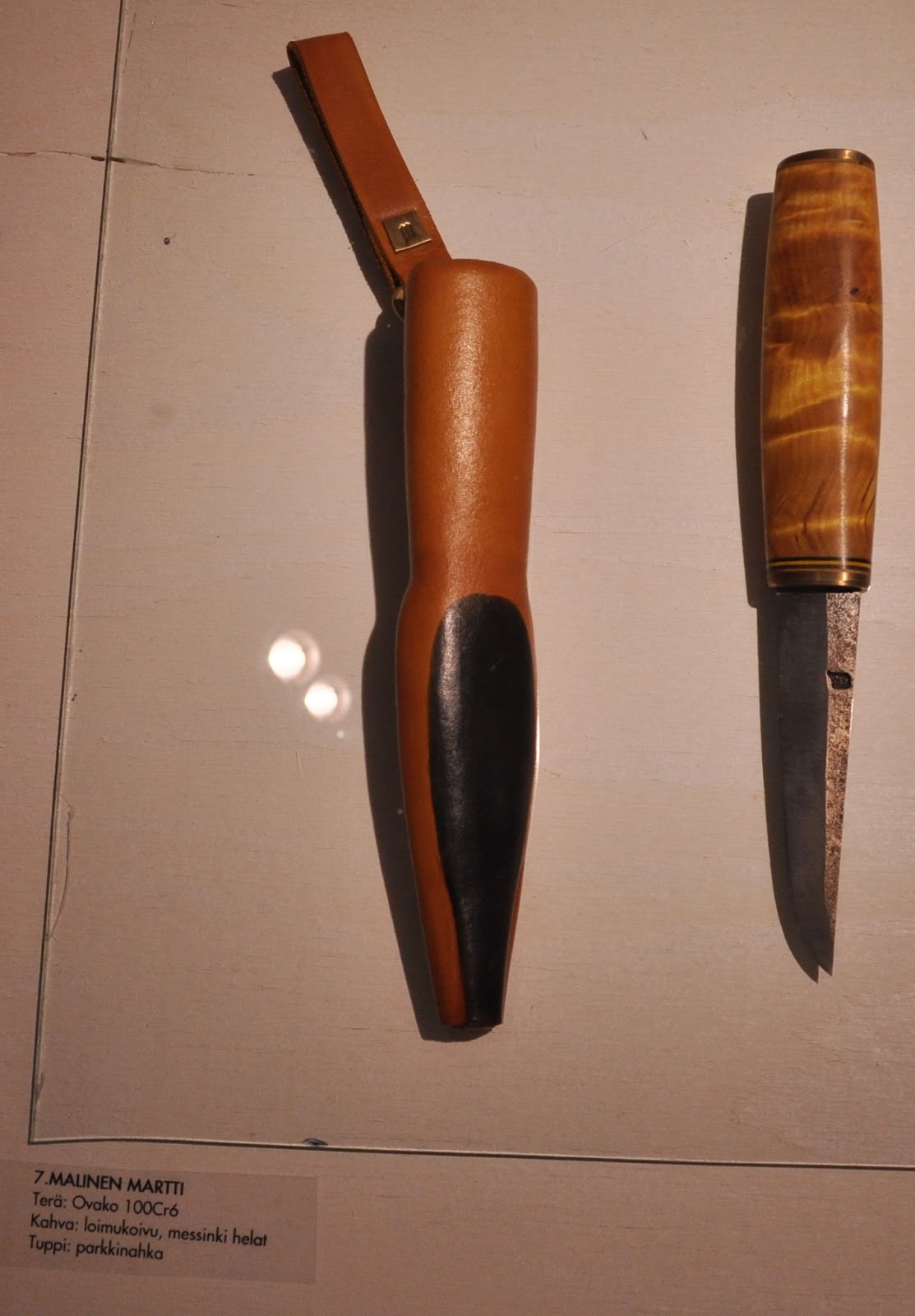

Looked at Martti Malenen and saw a review of one of his knives forged from Ovako "100Cr6." https://nordiskaknivar.wordpress.com/2014/05/24/malinen-koivumaki-puukko-review/
That steel turns out to be:
"Through-hardening bearing steels
Ovako specialises in high-strength through-hardening bearing steels. These grades exhibit high fatigue and wear resistance, good machinability, high hardness and good dimensional stability. A hardness of 60-65 HRC can be achieved through martensitic hardening and tempering, making these steels ideal for bearing products. This distinguishing property package is also suitable for other market segments and applications that have the same high quality requirements as the bearing industry.
100Cr6 type (SAE 52100)
Used mainly for small and medium-sized bearing components.
The 100Cr6 steel grades have high fatigue strength
and hardness, and good wear resistance. There are several
different versions of this grade."

Malinen is first and foremost an axeman, he once said to me "I could leave for the woods without a puukko, but not without an axe. That's the real bush tool". Some even consider him to be the best axe smith of Finland.
As for the 100Cr6 he chose it not only because it was the easiest to get, but since he had used it with satisfaction for many years and, being able to get it in 50-70 mm bars, he can use it also for axes.
He has also participared in the creation of HardeniteV steel
http://brisa.fi/steel/hardenitev.html
which aimed to be an improvement of the old 0,8% C german steel. He calls it a nice steel, but prefers to stick to 100Cr6.
He has been the forging teacher of at least two other smiths that I know well: Pasi Hurttila and Ilkka Seikku.

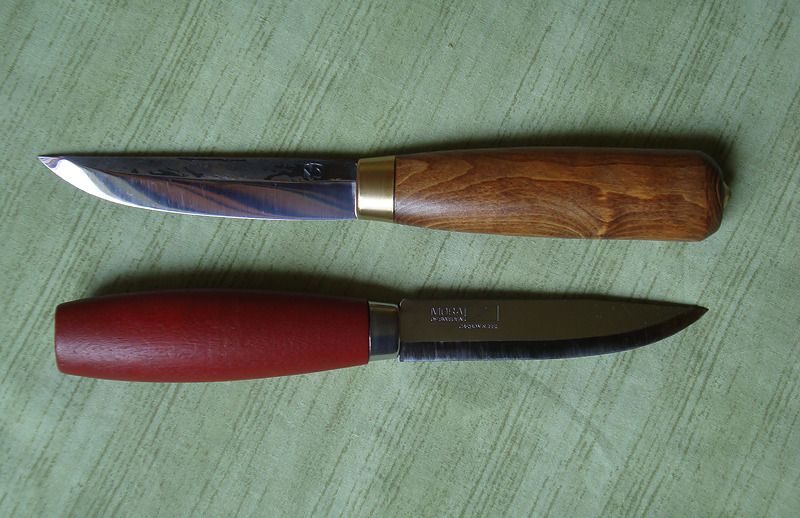

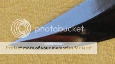

Moras are Swedish and aren't puukkos; if you've tried only factory made puukkos with flat section blades I agree you can't tell that big difference.
To undestand the big difference in cutting and preciseness you don't need to go straight to customs. A YP-Taonta is more than enough and goes for less than the Aito.
Frederick, so you are saying that if i tried cutting/carving wood with the 2 knives you show, the YP would cut with less pressure and more precisely than the Mora ? If so, Why, as both will start off being shaving sharp ? Is it the higher grind line on the YP that makes the difference ?
kj
As for the bite, it's the combination of higher grind and slightly more acute edge. As for the preciseness is a matter of blade section: rhombic really does the difference when carving hollow surfaces, but generally I've found it more precise in the amount of wood to be removed.
It's a bit difficult to explain in words, but plain clear once tried.
Maybe I've found better words to explain what I mean. Moras and flat section blades ae "biters", rhombic puukkos are "gliders".
On soft woods with the biters you actually feel the blade going into the wood and separating the fibers. With the gliders you can't almost feel it, the blade just skates into the wood and there goes the curls.
On hard woods both geometries can be felt biting and separating the fibers, but with the same different manners.

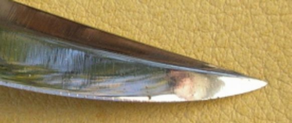

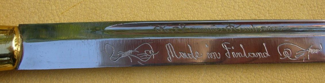

Juho Lammi is one of the most famous and influential Finnish knife-smiths. His son, Kustaa Lammi, 1901-2001, became equally influential and revered. There is a bit of information about J & K Lammi here: https://nordiskaknivar.wordpress.com/2013/05/13/kustaa-lammi/

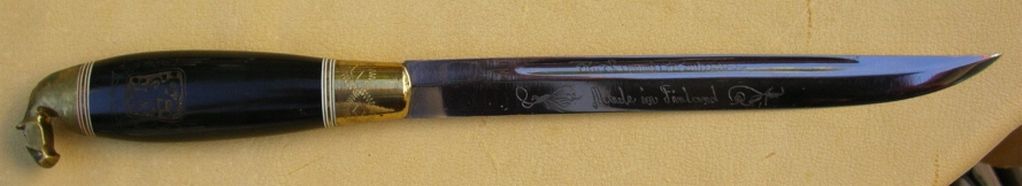

I recently acquired the largest Puukko i have seen and it was made by Kustaa Lammi. The overall length of this knife is 12 3/4" with a 7 3/4" blade. Large Puukkos such as this one are not strictly traditional as locals preferred blades up to about 5", but were made for export as others, particularly North Americans, like big knives.
Finnish blade-smiths have been taught how to sign their name in such a 'loopy' script that it is often impossible to read. Then they scrawl this curvy scribble into a very narrow fuller to further obfuscate.

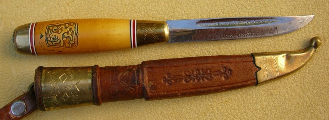

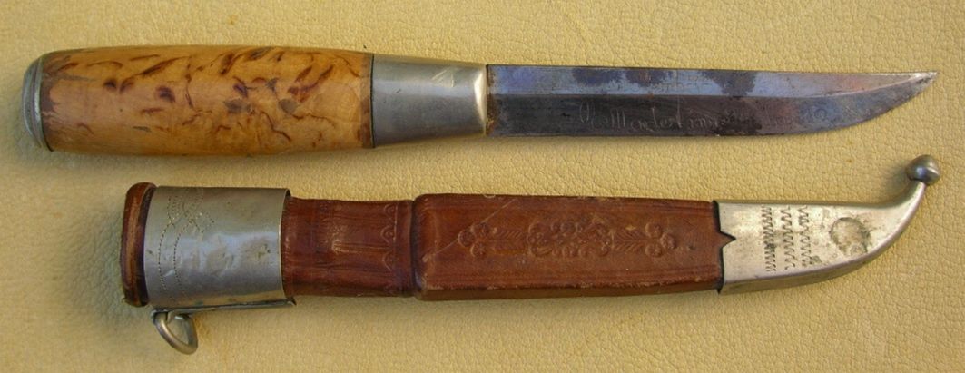

I am showing this large Puukko with 2 others. The gold color one is 5 1/2" OAL and is also a Kustaa Lammi knife.
The 3rd knife is another very traditional Puukko pattern referred to as a "Tommi" with the blade having a rhomboid cross section, along with a Birch wood handle oval in cross section, and no guard. It is signed on the blade flat just under the spine but i cannot read it.
edge is finished to the very tip which is very Finnish !

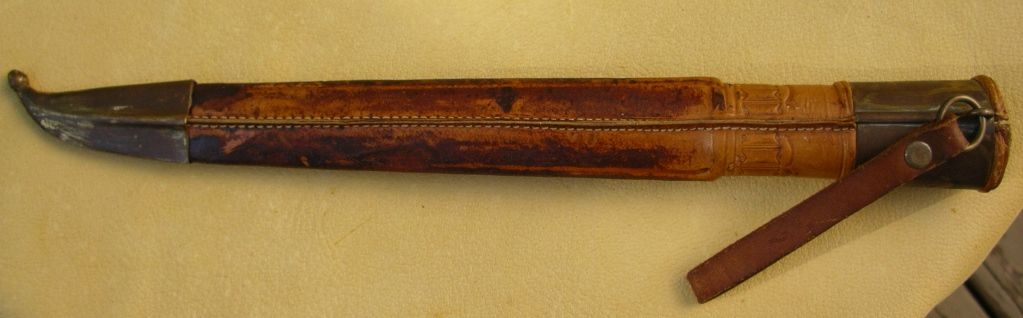

Here is the backside of the sheath which is 11" in length. The leather is very dry and rough feeling.
5 1/2" K. Lammi:
7 1/2" Tommi Puukko:
I hope the Puukko fans chime in with any additional info relating to these knives or to correct anything might need it.
What can be done to help prevent further deterioration of the sheath ?
thanks, kj
All three very nice puukko. I have all three of them (along with about 300 others). But, the bottom one is not a Tommi, wrong style. It is most likely a Jarvenpaa or one of the other many makers working circa 1930-70's. Here's a link to the Tommi page. Notice the major differences in style between yours and the true Tommi style which has been basically unchanged for a zillion years. Tommi, I believe, have only been signed with the initials of the maker hot stamped on the blade. Yours is signed "Made in Finland" on the lower blade flat and does have a signature (unreadable) on the top blade flat. (I copied it to my hard drive and enlarged it)
http://www.kainuunpuukko.com/index.php?page=1&lang=2
Still, all three are great puukko which anyone would be proud to have in their collection. For the sheathes, the only thing I can suggest might be a little Rem Wax or paste shoe polish.
