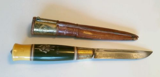

Puukko by Kustaa Lammi 1901-2001
https://www.youtube.com/watch?v=CsXmyKhIoAI
The handle reads "Helsiniki," possibly for the 1952 Olympics held there.
This illustration of another puukko my the same maker is a better illustration of the markings than I can capture:

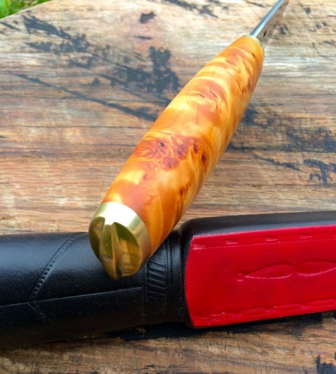

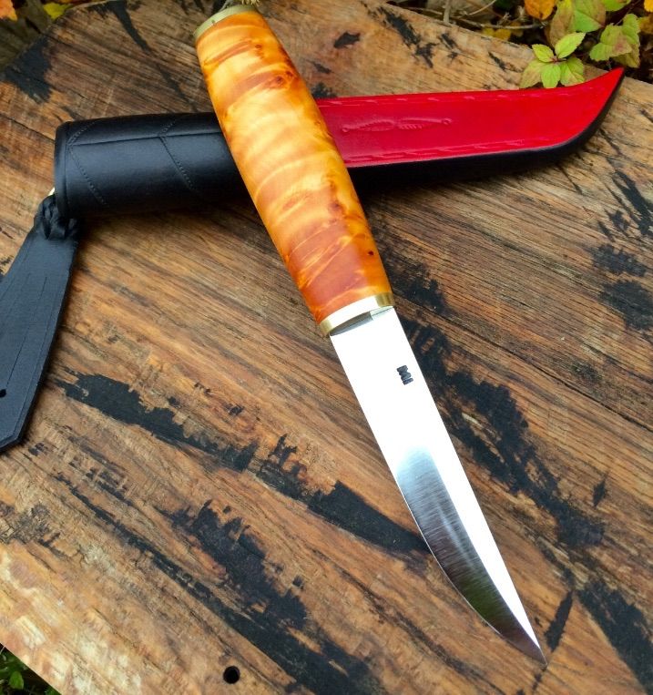

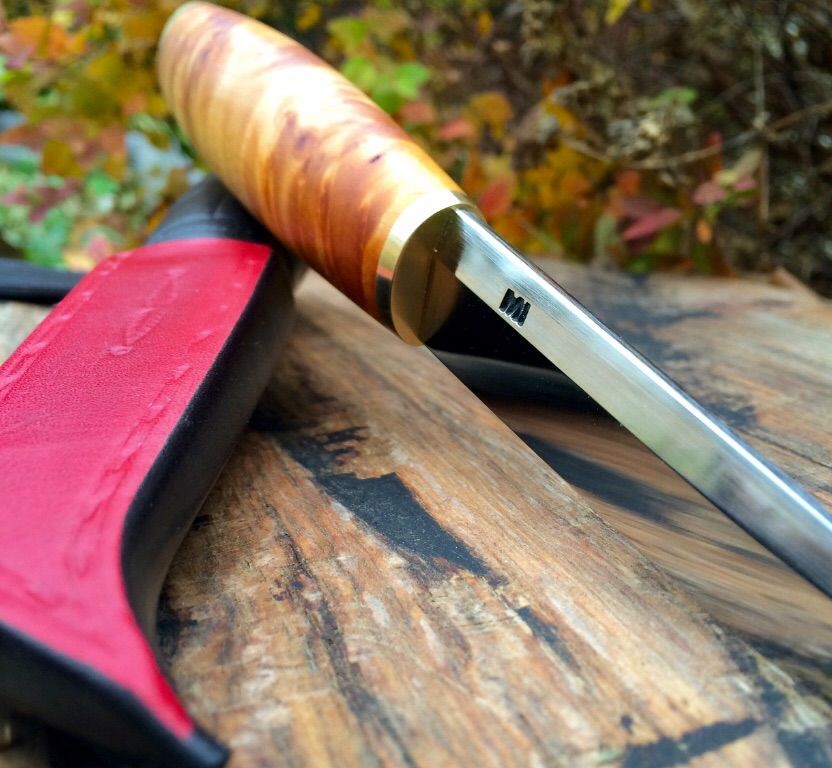

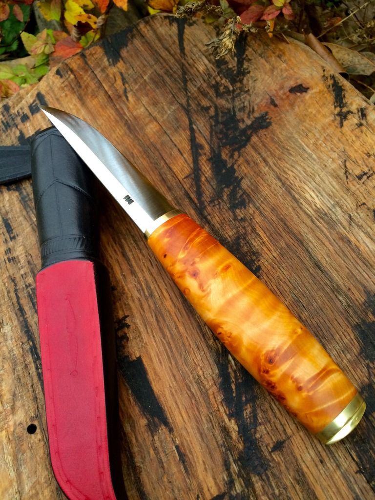

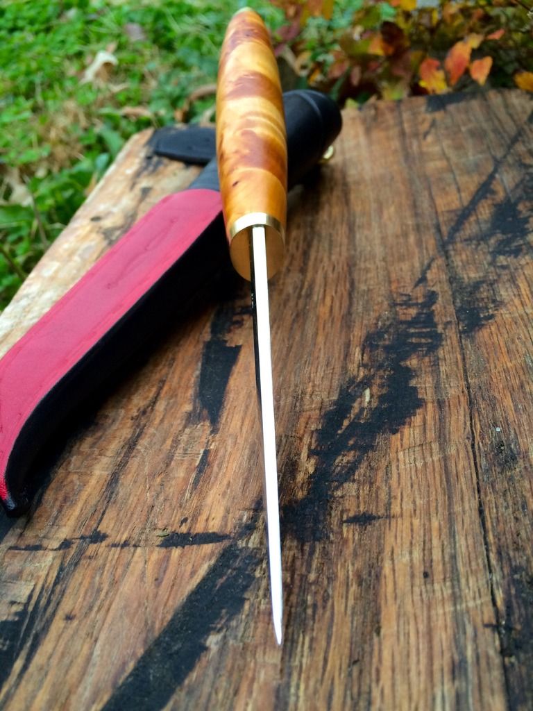

I’ve sold knives and had to say no to more than a few to get this one. Ordered it only 5 months ago and just got word today that she is ready to come home. My first Tommi. My first Puukko in fact. I’m pretty excited about this one. I appreciate the education received here on the forum before ordering one of these.

That is a real beauty, Brett, congrats. Pasi Hurttilla is forging me a damascus puukko that I am looking forward to.
Brett, the attention to detail is astounding!! I hope to see more of this beauty and hear how it performs. Thanks for sharing.
Good call on the Inkeroinen.
