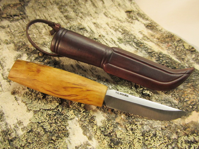

I made a couple eleven years ago with blades and stock materials and believe it or not, at that time, it was a lot harder to buy a puukko here in the US. I saw a great puukko for 300 bucks, the kind I wanted, but I'm not going to pay that kind of money for a hard use knife. So I went to the source for materials in Finland and was able to make the big one on the right for 20 bucks. It has a legendary Lauri carbon blade and that knife has been used very hard for the last eleven years, holds a great edge for a long time. The smaller puukko on the left cost a whole lot more to make, a whopping 35 bucks. It has a forged, rombic blade from Yrjo Puronvarsi and is wicked sharp. These two have been beaten through lengths of medium hard wood over and over, carved up slices of tinder and pretty much live on my hearth. Or you can spend a bunch of money for about the same thing. All you really need is a few hand tools to do this. Note the prices have gone up some in eleven years but still a major bargain. Extreme curly birch is harder to find too. There is a site in the US now that has a kind of mirror of the Finland site, just a bit more limited and more expensive but not bad at all.

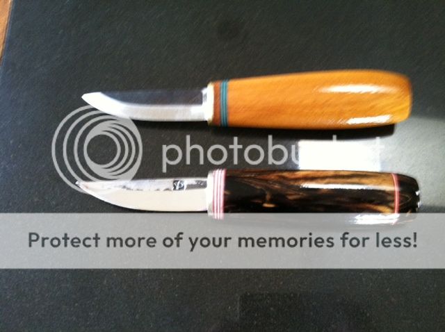

Here are two that I built. The top one is a Rosselli Carpenter's blade and the bottom one is a YP blade. I think I paid 56 bucks for the YP blade.
The thing I like about making your own is that you can use any kind of wood you like. The top knife is Hawaiian Koa and the bottom one is Black and white Ebony. I went trough 4 drill bit while drilling the Ebony. It's almost as hard as the steel.
Very nice knives SwiftDream. Beautiful work! Did you glue and peen the handles to the blades or just peen?
Thanks
Jim
They are both glued and peened. The tang hole in the handle is shaped exactly for the tang with those mini wood rasps so it has a fit like a glove, so tight that they were very hard to get back off to apply the glue.
You have a couple of nice ones there too. It gives you a high appreciation when you do the work like that. Saves a bunch of money too and gives you a using knife you are not afraid to really put through the years of hard use.

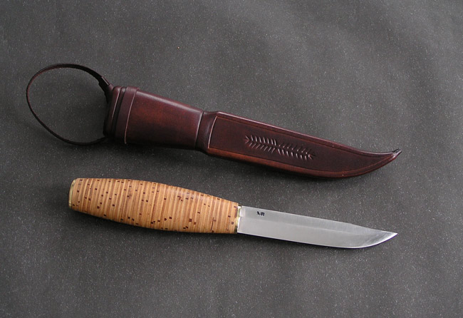

Tuohi puukko/tuohipää puukko, generic names used to call puukkos with birch bark handles.
One of the oldest, probably as old as maasepän or so. Sure is that birch bark was used for knife handles already during Viking Age.

That birchbark sheath s fascinating. Does the sheath's grip on the handle prevent the blade from cutting its way out of the sheath?
