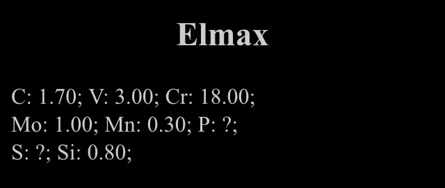

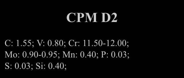

The main benefit Elmax has over CPM D2 is corrosion resistance so if you're planning to use the knife around salt water then go with Elmax, if not get the composite Leek and save yourself around $25. Another thing to consider is that the composite Leek is a frame lock and the Elmax Leek is a liner lock which doesn't matter much for a small light duty folder but I figured it was worth mentioning.

I don't believe the Leeks are CPM-D2. When looking at standard D2, Elmax is a better steel.
If they are infact CPM-D2, then I'd say go with that instead.

elmax = cpm d2.
either way though d2 is my personal preference, but I dont like either.

Elmax is a superior steel in all areas. Not a good comparion

Per an image from an old BFC thread, Kershaw DOES use CPM-D2 in the composite.
I've seen other references and seen other pics of the blades that clearly show CPM-D2. However Kershaw's own website only states D2. Strange. I wonder, did they change it at some point?
