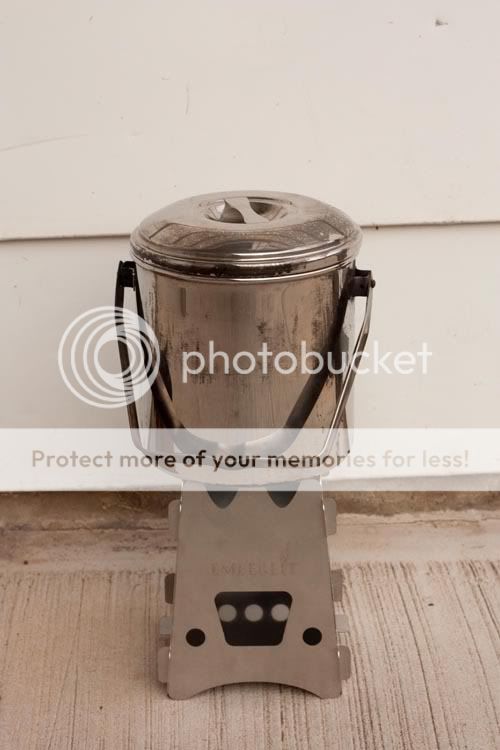

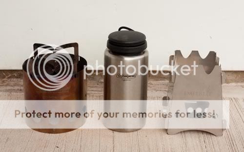

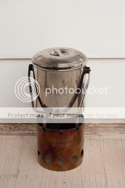

Just a quick couple of comparison shots.
I have to say the weight advantage goes clearly to the Littlebug, which weighs half of what the Emberlit weighs. I think a couple ounces could be saved if they went with a lighter floor-plate. I don't think it needs to be of the same stock as the walls will support all the weight. There might also be potential for deepening the arches on the base to remove a little material, and I don't think it'd hurt stability. I look forward to burning with the Emberlit though. The Littlebug just devours fuel. It also doesn't burn too clean.

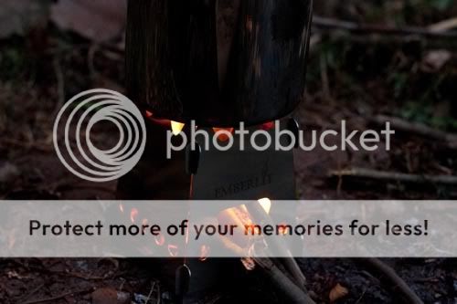

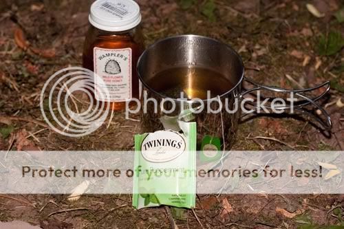

Took it out for a quick cup of tea...

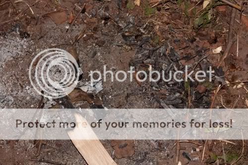

The Emberlit was relative cake for me to keep going (mind you this is my second stove fire.) The LittlebugJr. was constantly needing to be pampered if it was to keep burning. The Emberlit almost went out on me once. I was entirely to blame. I tried to jam a piece of fuel in too big too early and nearly smothered the whole thing. It took me 10 minutes to bring about 15oz of water to a boil. My tea was delicious. With any other stove this tea would have tasted like rancid milk mixed with motor oil. The last picture there the ashes from the Emberlit are on the left and those from the LittlebugJr. are on the right. I think it shows how much more efficiently the Emberlit burns the fuel. The Emberlit cooled down relatively quickly. However the LittlebugJr. due to it's thinner composition cooled off much quicker. Hope this is all of some use.
