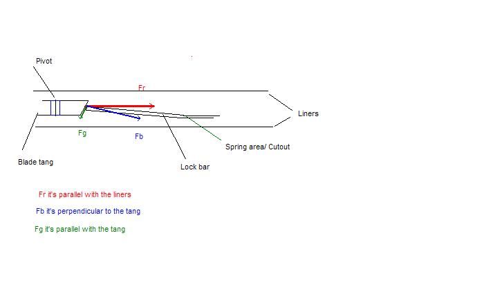

Ok, I'll try to explain this ( that, generally speaking, a liner lock will bend easier than a frame lock :) )
Take a look a the sketch, if I have a pressure on the back of the blade ( like trying to close the open knife ) the main force it's Fr ( which it's parallel with the liner- because the pivot it's perpendicular on the liner and the tang and lockbar have an one point contact, more or less )
Fg force it's parallel with the tang, and it's trying to disengage the lock
Fb force it's perpendicular to the tang and the opposite force ( plus the force generated by the lock spring ) will produse the friction force that will keep the knife open (hopefully).
If the knife remains open, the Fr force it will try to bend the lockbar (on the opposite place, on the spring area, because of the cutout geometry ( short ) we'll have a compression force) . Anyway, if I have 2 lockbars with the same cutout and different thickness, the one that it's thinner will bend first.
And don't forget that for a liner lock, the only force that keep the blade away from your fingers it's the the friction force (Fb' x friction coefficient between the two metals), a drop of water on the tang could be enough for a failure.

So are you saying that dry frame locks are much better suited for spine whacks? And where are these pictures of bent lock bars?
if the cutout has the same thickness as the spring/cutout of the liner lock, same material ( and tang geometry), both will have the same lock strength, but if the lock will not fail, the liner lock will bend easier than the frame lock, if you'll put enough force. But in normal use, you reinforce the lock (I mean a frame lock ) with your hand - more friction force on the contact point and force against disengaging the lock, so you have a much stronger lock than a liner lock.
