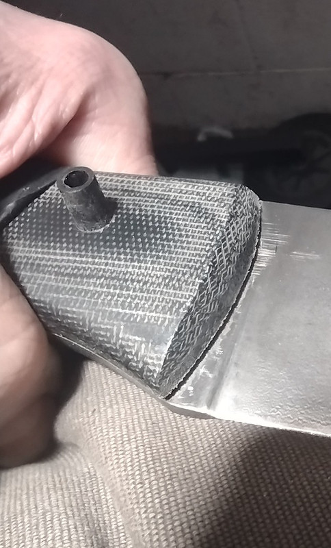

What should I be looking at in this picture ?
It's a long beater/chopper. Thin blade.
all that chopping applies alot of torque and twist, and vibration.
With only it's straight tube fittings the epoxy let go.
I was flexing the blade some to show the gap and forces that can get applied. Especially with such a long lever arm.
(pin/tube popping out & gap between the scales and the tang)
What was that black behind pin , is it one piece scale or ..... ? Handle is not glued ?
Handle was glued..... I will have to rehandle it someday. I haven't yet. I'll put actual fasteners on it then.
I think the black behind the pin you are asking about is the silicone tape that I like to use for a hand wrap. It makes the handle grippy. With enough wraps, it can fill the handle out more, for comfort. i use it on knives that i want the handle to feel different/bigger.
Currently the tape is what is keeping the scales on
Are you sure about that ? I don t see any sign of epoxy on scale ? not on front on scale , not around that pin ?
I haven't completely broke it open yet.
I have pushed that pin in and out a bunch, but I know what you mean, I'd Like to see more evidence of adhesive Showing. ....
Again, I didn't make this, but I generally know how he makes them. Once I pop off the scales during the rehandle job I'll see better.
Maybe what I'm seeing is "confirmation bias"
Seeing what I Want to believe.....?
