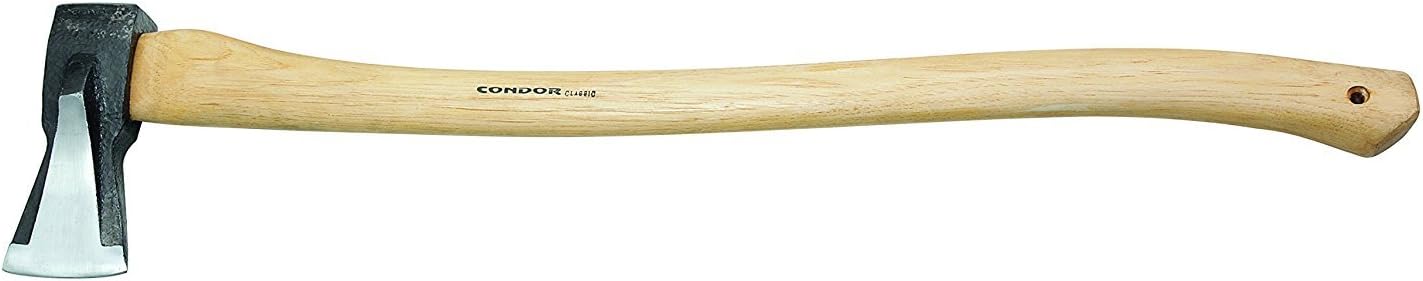

I would still be concerned about a low centerline. Again on eastern wood with a high moisture content you need a high centerline or a steep ramp or you will stick the axe in some woods and it won't rotate out very easily. This is the reason I suggested a Fiskars in lieu of a splitting axe because it will penetrate but it will typically extract fairly easily. Another option is a German style splitting axe with the sharp point and the ramping ears--these are available at Lowes or Condor.
