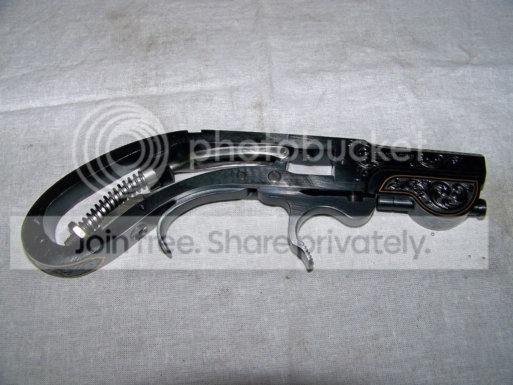

I'm really interested in this one.
I always rip stuff apart to see how it works.

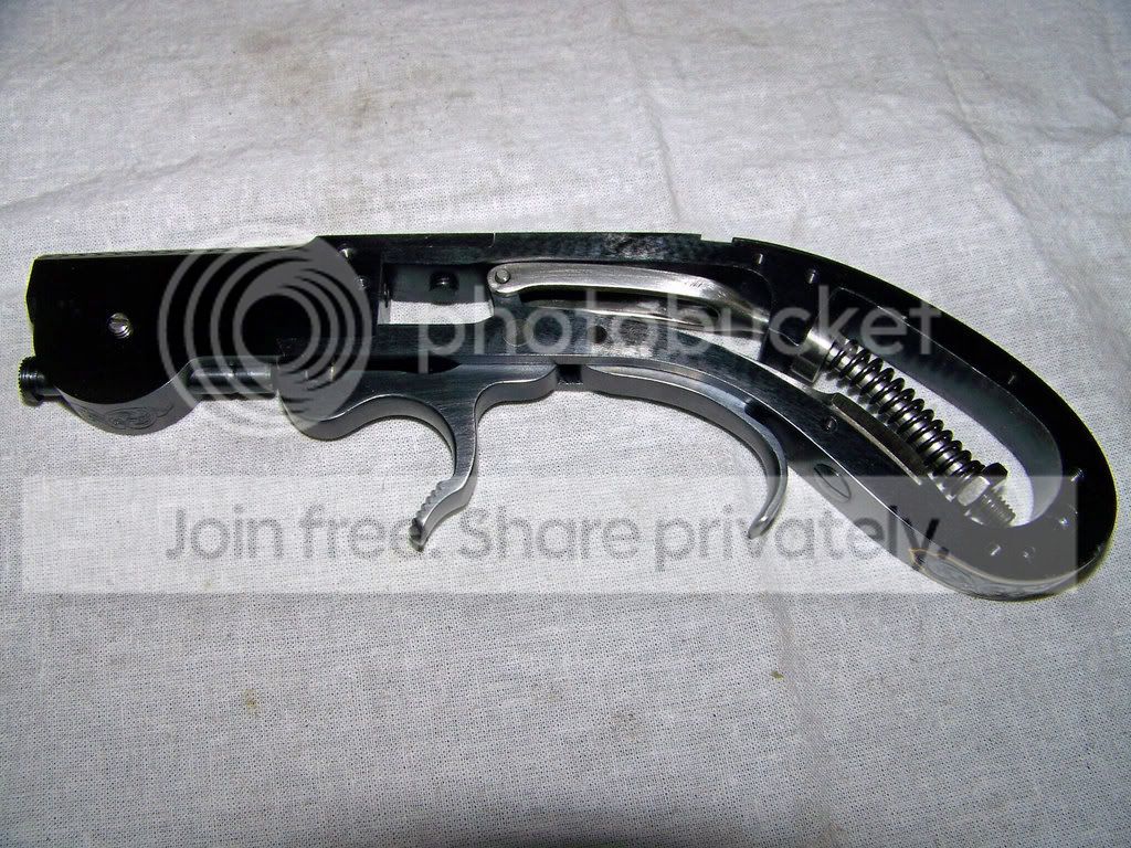

Now that you mention it, i see the lockback, and i see the coil spring for the auto.
Where - how do you fire the auto - where is that trigger ?
Im glad the pics work now. Images really confuse me.
The blade is fired by the lock. No complications, simply push it to fire and push it again to release the lock. I think Im the proudest of the spring. I made it myself. If you read in the Machineries Handbook it gives mandrel diameters and piano wire thickness for any size spring you want. I turned the mandrel on my lathe to the suggested dia. and wound my own spring. Aint that cool? The sockets are cut with the cutter from Knifekits.com but their spring would sag out so I used both their cutters to make the socket wider and made my spring with almost one more coil. Waullaaa. Maybe I can show it in a picture. See the liner with the big hole?...the spring is so wide that I had to relieve the blade, liner and bolster. I wanted the bolsters very thin (geez this thing is wide enough already) so relieving the blade also made sense.
I would never have guessed it! Nice spring! I happened to bring home a copy of Machinery's Handbook today from my school shop class for summer reading. Is that piano wire? I didn't know it was suitable for springs.

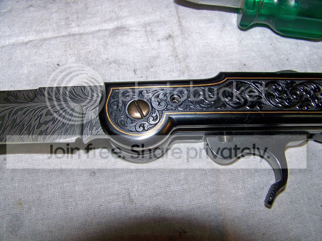

Wow Bruce ! Very nice work ! There are some really neat details on this cut-n-shoot. Double set trigger ? Or is one trigger dedicated to just the "cut" ? Great looking engraving and feather pattern damascus (my favorite) ! Lock back auto :eek: SWEET ! Outstanding job on the bluing too :thumbup:

What color pearl is that ?
Awesome job Bruce ! Your Master Smith experience is evident in every single picture that you post !!
Amazing Bruce !! What gets me is how you have the idea, and get it out of you head and into steel and make it work. Most can concieve ideas, but very few can make them work in the real world, I would say your at the top of that list. Keep them coming :thumbup:

Only one trigger, the other one is the hammer. It is an "Under hammer" It will make more sense when you see it put together. Its hard to tell what the heck when you see just parts scattered out.

The pearl is dark goldish colored. I dont know, Ive saved this set for 10 years. I dont have very good luck drilling pearl but it should be fine as an inlay.
