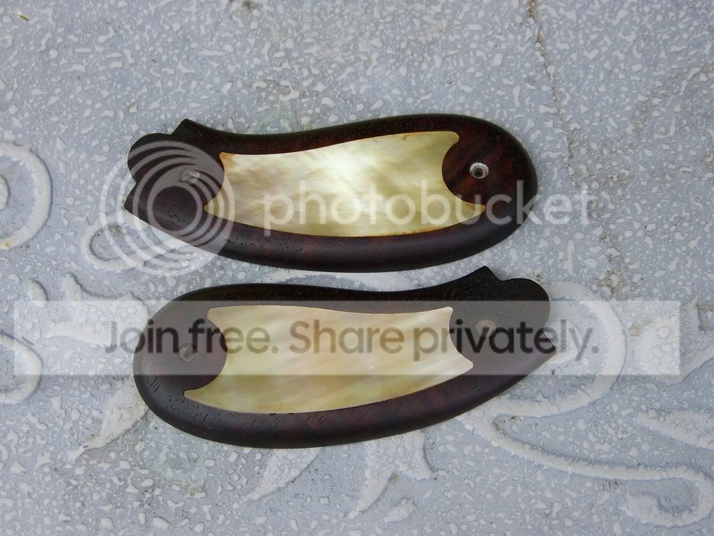

Here are the handle scales. I inlayed some mother of pearl in walnut but the wood was so light colored the pearl wouldnt show up well so I stained them with dark brown fieblings leather dye. Working on coats of linseed oil now.
I want to show the steps I used on the inlays on another thread. Actually these are the first for me and Im impressed with the fit.
Glad to see everything fit! Whoo Hoo!:cool:
David, The only thing I suggest next time is to waterjet the plates from 1/16" thick steel and cut them very very slow so there is no kerf at all. One side is perfect the other side is simply OK. The kerf on the plate added to the kerf on the inner plate makes a looser fit.
That and I can mirror the opposite side for perfect fit.
Perfect. I may make another set for this pistol. If so I will change the shape of the inlays. He may want a Vegas theme. I think it may look cool with Hearts, Spades, Diamonds and Clubs in MOP with Stabilized wood next time.
