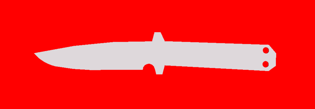

WAR line prototype idea.. first rough draft, I have about 20 minutes into this so far. None of the corners are rounded, that takes a while to do but my idea is layed out.
.227" S30V or 154cm?
Ooooo!!
I vote 154cm and possibly O1 or 1095 for carbon. I really like the .227 thickness of my rigger and depending on overall size would be awesome! I'm guessing right around the 8-9" range?

CPM 154CM. Not 154CM... or go with 10V :) Scalloped scales, and it really should have a nice knuckle guard :D

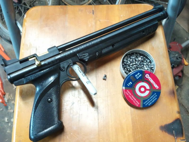

Just came in from rat hunting. Didnt get any tonight but I figured out why, when I first sighted the new pistol in I put just a few shots into the tree across the yard. I can tell pretty quick where I need to move my sights on a pistol, this gun was shooting left. Well the third shot landed where I thought it should after a quick adjustment, but tonight I still was missing the rats in the almond tree.
So I set up a rudimentary pellet trap in the garage and did a grid target to figure out what was going on. At 7 paces I put out two 5 shot strings at two different power levels, turns out this gun is shootng 1/2" high at 7 paces! The rear sight is bottomed out already so I have no more adjustment to bring my grouping down. I guess I am going to to be fabricating a new rear sight for this gun. It was holding nice 3/4" inch groups which ain't bad for offhand, in the dark and a completely factory stock $60.00 gun. The trigger is horrendous right now too. It severly needs work, the pull is close to 5 pounds and isn't very crisp either. Looks like that's next on my list. I think I'll fab up a new trigger and trigger shoe, too. I just love doing stuff like this!

Well I got the pellet pistol sighted in this morning. Dint have time before work to fab a whole new rear sight, that's gonna take some engineering first. But I did manage to modify the stock (terrible) rear sight to bring my shots on target where I wanted them. I also tore the gun down and did a trigger job. Stock was close to 5lbs (very heavy) and not very smooth. It is now at about 22oz, maybe a little less. Clean break, smooth pull and passed the bump test. The factory sear is stamped and they don't clean up the edges, at least its heat treated. The trigger blade is cast pot metal and painted. I polished all mating surfaces to 2000#, lightened th factory spring, which was just jammed against the sear. I made a new spring guide from brass and gave it a polished domed surface to ride the sear.

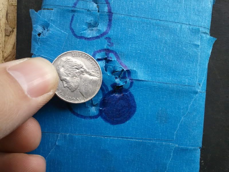

5 shot groups at 10 paces (320" or 9 yards), off hand, factory iron sights are grouping inside a nickel!

Evening men.Daniel that War project looks awesome!!! 1/4 inch thick blade and 7 1/2 inch long blade I will be all over that!!!!
