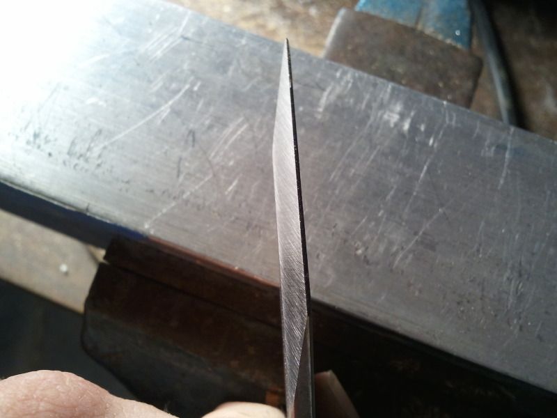

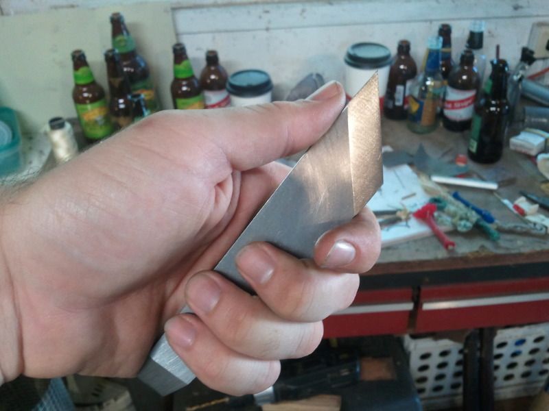

Then I started my kiridashi from steel courtesy of DFK. Kevin (flatblackcapo) and I sliced it down the middle at a 45* to make equal 6" kiridashi shapes. I ground the bevel, profiled, and put a screwdriver/pry bar end on the butt. It will have scales of some sort, I'm thinking some .070" carbon fiber/kevlar sandwhich laminate I have, or maybe some nice wood sliced super thin.
Pre HT edge is .025" it still needs some time on the disc grinder to true up the flats, its at 60# now.

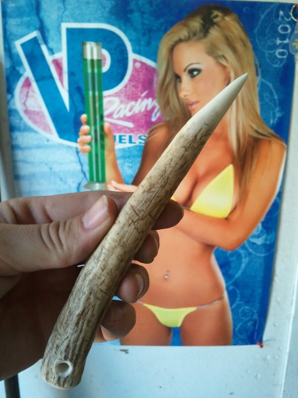

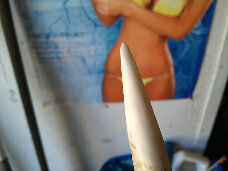

I also got a marlin spike made today to go with my rigger! Its a fid more than a spike, but very useful none the less! I even used it a couple times today to put constrictor knots on some split wood.

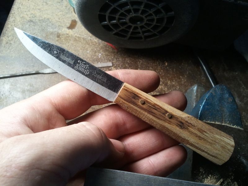

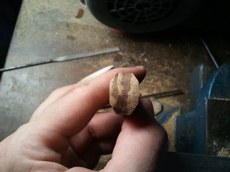

And here is a bamboo Wa handled paring knife. Its an old Imperial parer that I am rehandling just for fun, but its a decent blade too. The handle is stabilized flooring material scrap. I've used it a bunch and really like it!

Xander, nice kiridashi, what kind of steel is that?
.125 1084. I may send this out to be heat treated in a controlled kiln rather than my 2BF. Being an eutectoid steel it is very easy to do, but I would like less decarb to deal with on this. Daniel, you up for it? Do you have anti scale compound?

Xander, I don't use any anti scale, the 1084 is good about staying clean... of course there is a little decarb though. (and on a chisel grind it all must be ground clean) I actually soak O1 steel for 1/2 hour at 1500 and it comes out pretty clean. HT is tough to impossible without a kiln though, send it to me and I'll take care of it! :D

Yeah most steels do much better in a kiln than an open flame forge for heat treat. I don't like to use hard woods in my forge to reduce the atmosphere and limit decarb. I do 1080 and 1084 pretty easily my self, its just the chisel grind is why I would like to have it done in a kiln.
Good call on the refractory cement, I have maybe 4lbs of it and always forget about it as a slip coat. I do use it for a hamon on my minis, but don't slip coat them. I may try it with some other pieces, though.
