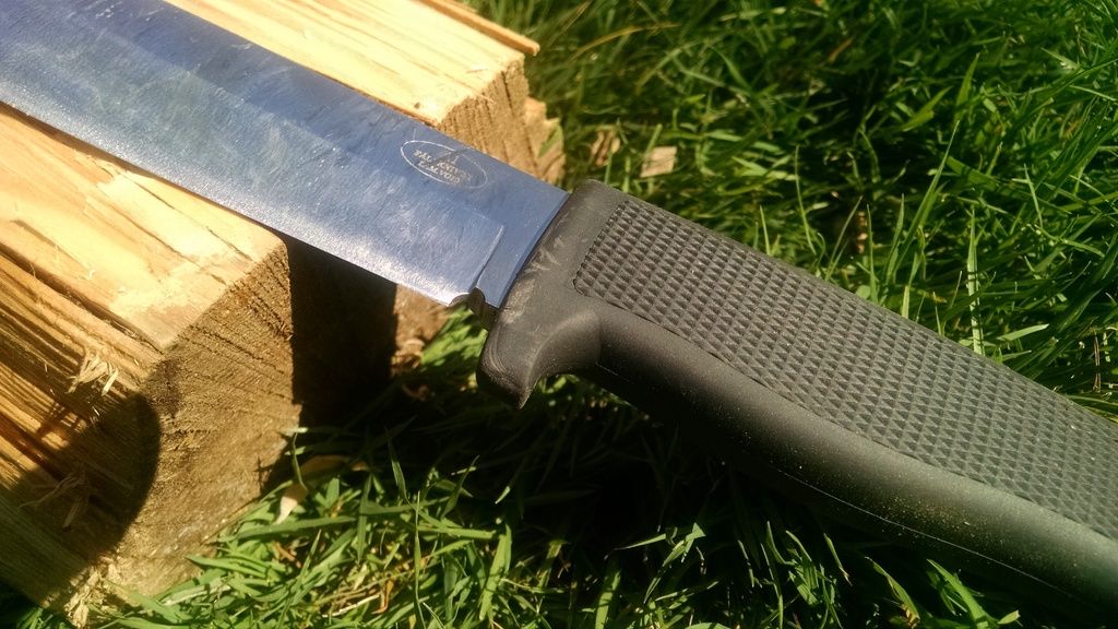

Weight- the knife weighs about 11oz, just under 1 lbs (16oz), which feels lightweight for a knife this size with almost a quarter inch spine. In the hands, it feels very nimble, yet powerful, there's nothing like it.

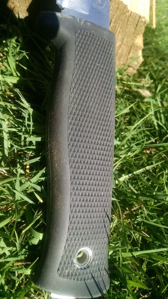

Handle- the handle is made of a hard polymer with a slight tacky rubber feel called thermorun. The difference between thermorun and kraton is that kraton has a more "gummy" soft rubber feel. The best I can compare it to would be the orange grip on fiskers x series axes and hatchets. While more durable than kraton it is not invincible and will gouge if beaten with a gnarly baton.
The grip checkering does its job without tearing up ungloved hands. I really only noticed its effectiveness when the handle was wet which is how it should be.
There is a subtle palm swell that is at the thickest at the center of the handle. There is also a very slight hour glass shape near the lanyard which is too small of an area to get a good grip on for chopping without a lanyard (I never use lanyards).
The front finger guard is comfortable and well contoured. The balance point of the blade, however, is directly at the finger guard. I can see why they did this as it brings the chopping performance on par with knives of the same size that weigh more. There is no metal from the tang protruding into the guard, so it could be cut off; however, it would remove the ability for the zytel sheath to retain the blade without the retention strap.
Overall, I like the handle for its K.I.S.S approach, but there is no doubt it was designed for the European hand.
My opinion is biased towards large handles, however, due to wearing large to extra large sized gloves. For me the becker bk2 handle fits my hand the best, but the fallkniven will due fine.

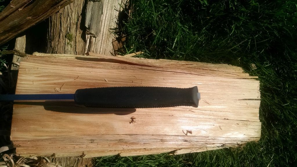

There is also an exposed tang at the butt of the handle. I really like this feature on survival knives as it allows you to hammer the knife into the side of a 1" to 6" diameter log to split it (I'll show the technique on Youtube later) or to hammer into a tree to rappel from...lol wat! SURVIVE! (No harm intended Guy, love your knives)

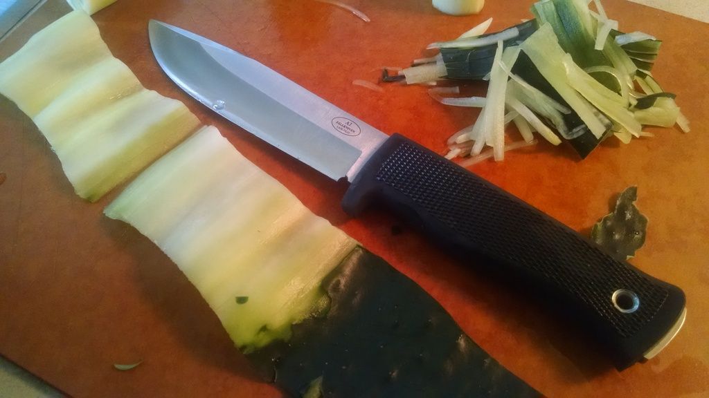

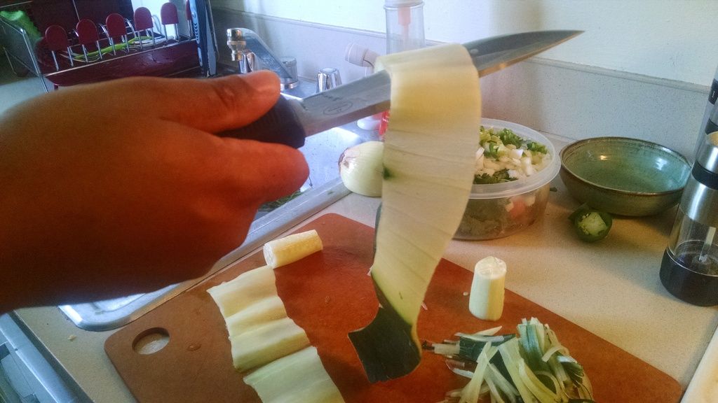

Fallkniven A1 in the kitchen. No sharpening or stroping after batoning, chopping and carving wood. Quite impressive for camp cooking. Maybe sushi too ;)lol
Fallkniven A1 in the kitchen? Finally an outdoor knife that cuts
Check it out
[video]Fallkniven A1 in the kitchen?: https://youtu.be/vhjsDhchLNE[/video]
I'll make another video on how well it strops back to razor sharp soon.

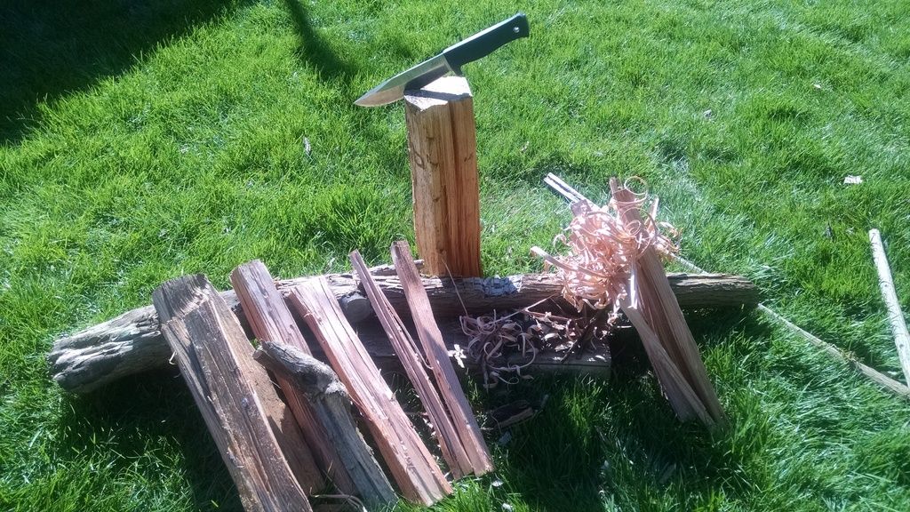

Blade- The blade is 6.3 inches long and is about .24 inches thick. Definitely a great size for a muti-purpose outdoor blade.
The design is a drop point with a swedge that serves to increase piercing performance at the tip while maintaining thickness for durability. It doesn't seem to chew up batons as bad as I thought. The swedge still has some girth to it and is not designed to be sharpened.
The blade height swells at the belly and tapers to the handle. I'm a big fan of this as it gives similar chopping power of a recurved blade without the difficult sharpening. (Like my schf26) The edge also very subtly has a continuous belly to the choil which makes the blade an excellent slicer and aids in carving feather sticks.
The spine is sharp enough for making fuzz sticks and shooting sparks off a ferro rod, yet at the swedge, I noticed it was not as sharp.
The convex grind is excellent, it really slides through the wood for carving yet has the durability for other tasks. It really backs up edge allowing for excellent edge retention everyday hard use.
