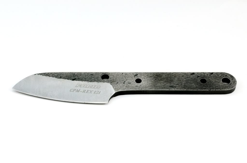

I got my mule today, if anyone is on the fence or wondering if they are worth the money, let me assure you they are.
My blade arrived scary sharp, extremely well packaged and lightning fast. The blade feels solid in your hand and is a work of art IMO.
I can't wait to get some scales on it and start using it as my EDC.
I could not be happier nor recommend Farid any higher. He is a class act!

Fantastic work my friend! Really impressed of the thinness behind the edge considering the steel (.022)
Got mine yesterday. Very well packed and shipped quickly from the UK. Put to work the fist day with toilet and vanity boxes and didn't need sharpening after work. Putting scales on it this weekend and will be used heavily next week putting in windows. Nice work and very sharp. What angle is needed when it needs touched up? Thanks Martin
Thank you,
To touch it up use DMT course, then finer and finer, finish the edge with a super fine stone, I have actually profiled my own REX 121 edge to a very thin edge and finished it to 10k and then to 20k.

Looks to me like the primary grind is just under 15 degrees and the edge bevel is mildly convex ending in about a 20 degree (per side) apex. Overall its not quite the laser you'd expect because its on the thick side but it just doesn't seem to dull. I'm thoroughly pleased. I did notice it didn't come super sharp. I mean it wasn't dull, that would be absurd, but it wasn't that stupid sharp I normally see in knives. No worries it was an opportunity to see how it sharpens. :) The answer is slowly, but not as slowly as I would have expected. I actually rather enjoyed it. Its quite smooth and creamy, not grabby like a soft steel. You do really want diamonds though. I tried lapping it down to .3 microns but it just didn't get it that sharp (barely hair whittling) and the polish just wouldn't come out. I switched to diamond compound on strops and managed to, without much trouble, raise something thats passable as a mirror edge. Its not air-bleeding sharp but it'll whittle hair and perform all the other silly super sharp cut tests we do no problem now. It still just looks kinda "hazy" its not that ZDP-189 mirror thats for sure.
