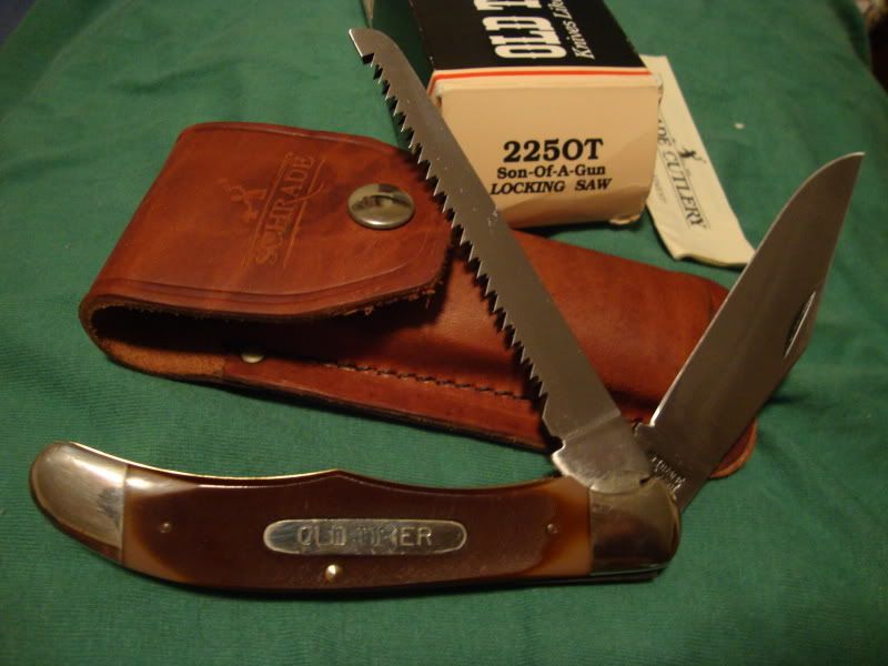

1990 USA Schrade 225OT Son of a Gun.
25 years and the 1095 well patinaed 5 1/4in clip blade is still going strong. The stainless bone saw is still razor sharp after Many elk and mulies breast plates.
Here is a picture of one, not mine but exactly the same.
