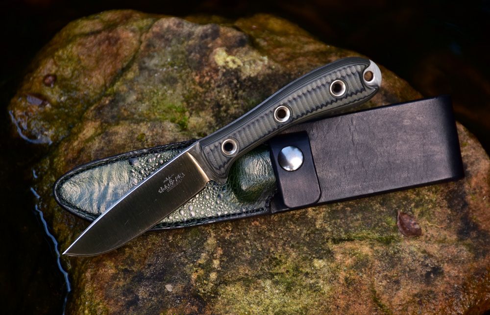

This came today as well..really impressed, news print slicing sharp and bigger than I expected..pleasantly suprised..I'll have this one a long time.
They are a nice knife !!! My M6 is the twin to yours !!! I am surprised how little publicity they get !
Such a great knife. I'm only on to Busse/Kin a few years..I've just recently became aware of the Mischief's..started w/ an M9LE. Now looking for a saber ground M9.
I think an M7, M7.5 would be a sweet spot for this handle config..full height grind and satin please..:)
