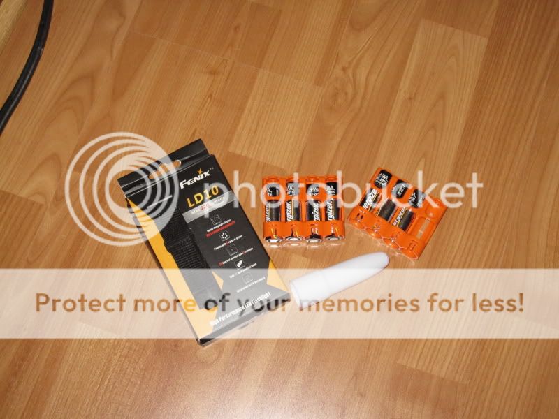

I just PMed Talfuchre to take a few batteries out of the package that is going around. Also, can everyone just insure it for $50 instead of $60. By removing a few few batteries and insuring for $50, it will save $2-3 dollars shipping for everyone (apparently over 13 ounces and insurance over $50 makes a big difference). If you have fresh AAs can you use those instead of the ones that are in the package? I figured if 3-4 of you have AAs lying around, it is worth everyone saving on shipping. Also, I put the batteries in a County Comm battery holder. Can you make sure that gets back to me? Thanks.

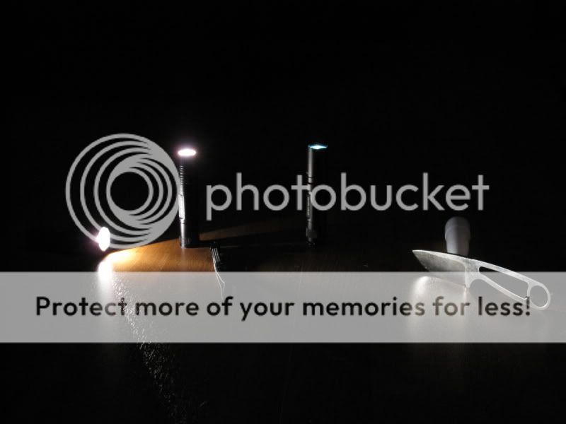

The light came in today!

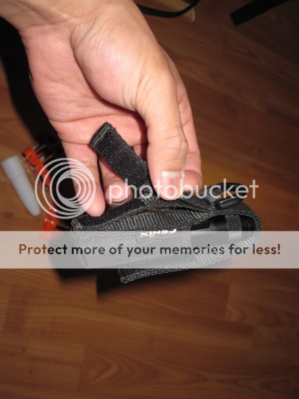

The pouch fits nice and tight and has 3 different places to attach to things.

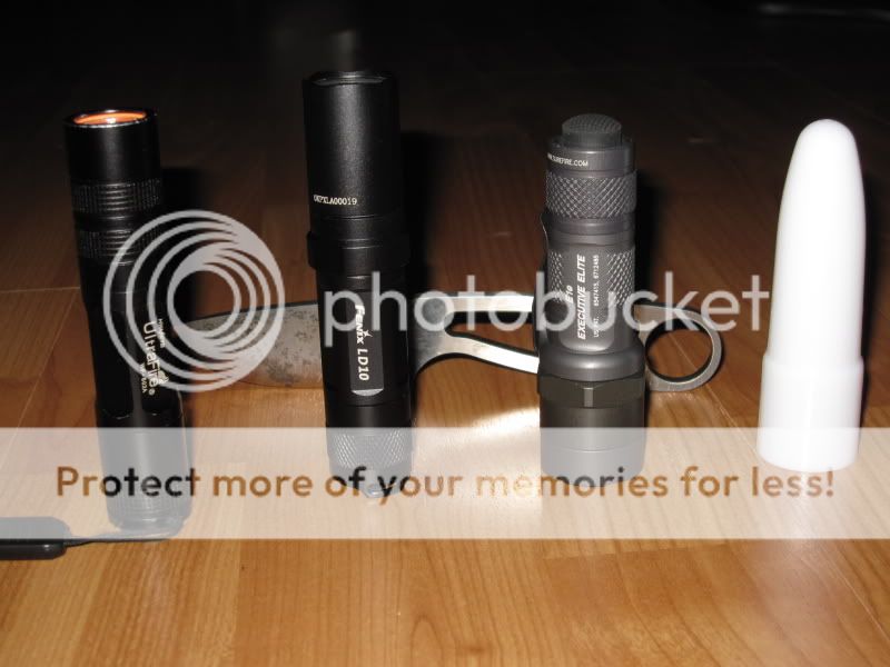

Lined up with next to my UF-602a (cheap fenix knock-off LED), Surefire E1e (incandescent) , and prototype RC izula.
The antiroll design is great, which my surefire has, but not my UF.

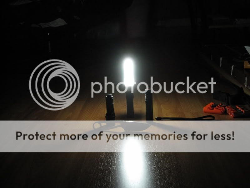

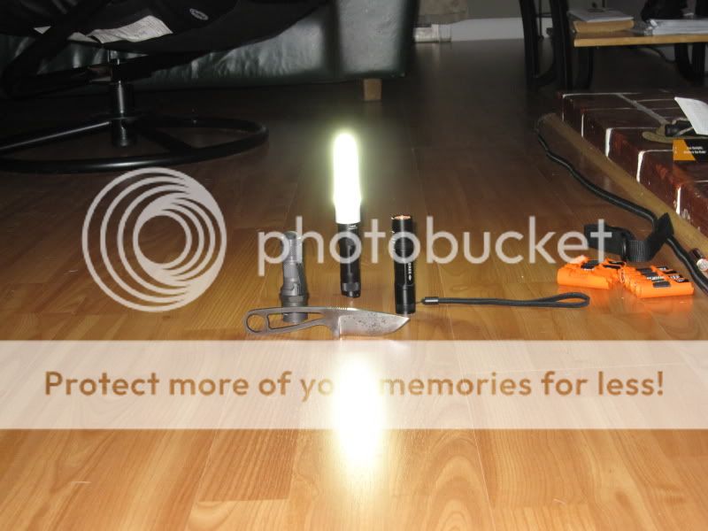

Candle mode! Great option for many situations. One of the things that sold me on the UF was the ability to do this, but the surefire cannot.
The other two lights matched the LD10 on medium, but on high and turbo, there was no comparison.
The LD10 is a great light, definitely next on my list. It combines all the features I like into one compact, bright, light. I was weary about all the different modes, but after a minute I got the hang of it and think it works flawlessly. I'm going to keep playing with it and give a final review in the end.
And thank you for the opportunity to try it out!
Thanks! The house just got the floor done so now I have a nice indoor place to take pictures now.
I played with it some more and the LD10 gives off a nice white hue. My fenix knock off has noticeably bluer tint, and since the surefire is incandescent, it gives off a warm natural light color.

Great passaround. May I ask what make and model the other flashlight in this picture is?
