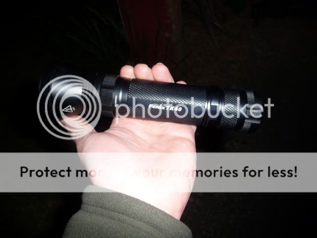

I was really excited about getting in on this passaround. My experience with decent flashlights has been limited to a few sizes of Mag lights, a SureFire 6P LED, a Brinkmann knock-off, and the Petzl line of headlamps. I’ve never used or handled a flashlight like the Fenix TK 40; opening the box was like getting a birthday present (and my 40th was on the 28th)!
At first the packaging for the light itself seemed like overkill but it ensures your new light comes to you with the bulb intact. I did not get a pic but it is a small plastic box that encases the light. It fit well in the side pocket of my truck door. The light itself seems of high quality. The threads were all tight, smooth, and consistent and it was easy to dis-assemble. The plastic battery carrier has some tabs on it that might be a bit suspect however.
The fit in the hand was comfortable for me, fat like a D-cell light. I too thought it odd that such a large light would have the switch on the tail but it was smooth in and out of different pockets. I’m sure it’s more waterproof and compact without a side switch but I’m no engineer. Adjusting the output with the clicky switch was unfamiliar at first, but the manual was helpful. I didn’t hook it up, but the supplied lanyard and shoulder strap are a nice addition.
