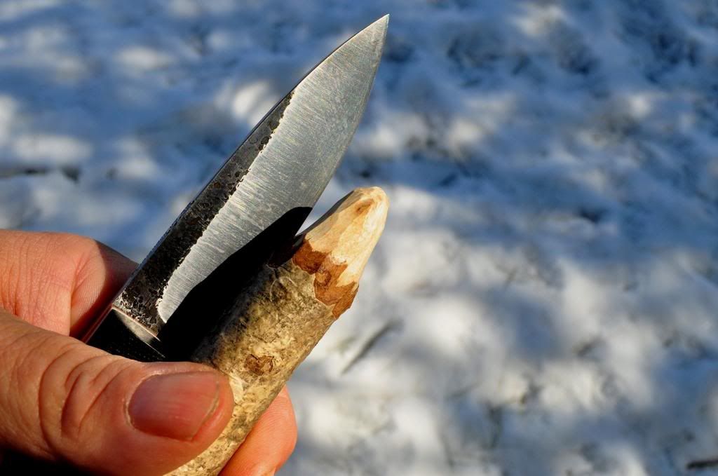

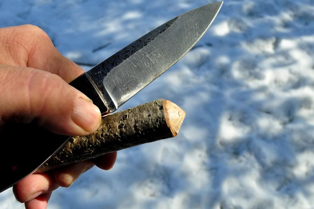

I've had the convex K.E.Bushie for a week today. Far from finished with testing, it's a long term test of the convex 1/8 / 3mm O-1 tool steel. Normally I use a knife in the kitchen first, then take it to the bush, but since I have used the convex 1/8 in the kitchen quite a bit, this time I hit the woods with it first.
The first project I thought of was inspired by the bitter cold and the snow covered ground. There is a method of using a bow drill called a two-stick hearth which, though more complicated to master than it at first appears, involves less intricate cutting and notching, works well on frozen or snowy ground, and doesn't require as much gathering of materials. All that is needed are something sharp to cut with (preferably a well made knife, as doing it with a sharp stone sucks :) ), some cordage, three sticks of soft-seasoned wood, roughly the same diameter, for the hearth and spindle, and a bowed sapling or branch for a bow.
This is the environment.

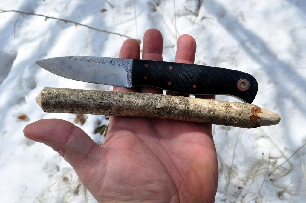

I try to find one branch, or small standing dead sapling, from which to make the heath and spindle. The wood needs to be dry, and softly seasoned, but not rotten. It should whittle into curls rather than crumble when you whittle into it, and it should be soft enough that you can dent it with your thumbnail.

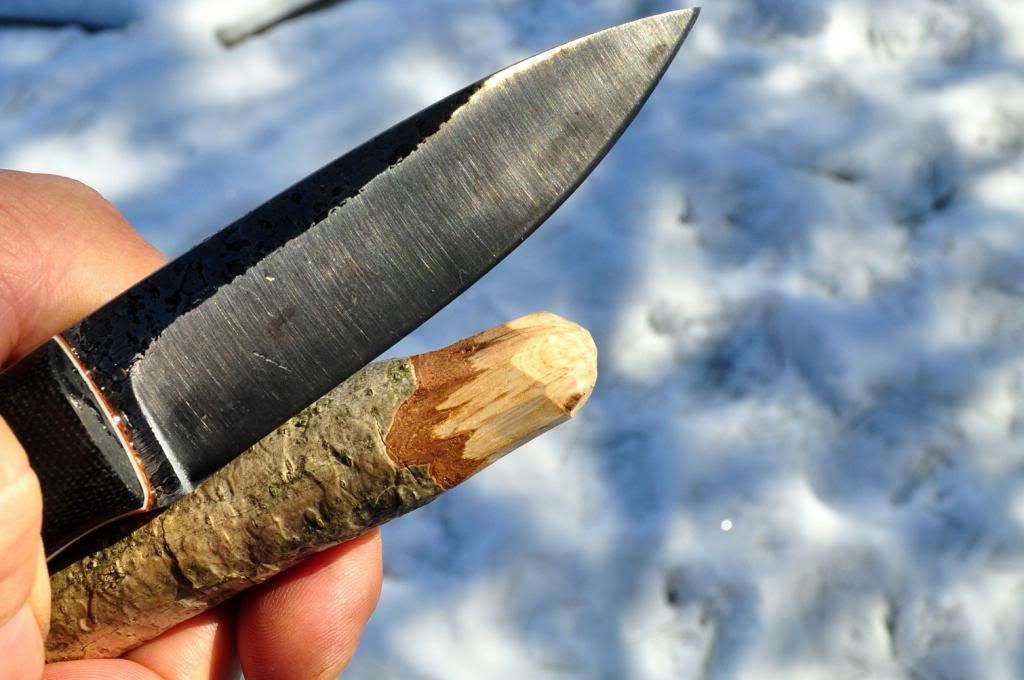

Small knives aren't much for chopping, but in smaller projects like this a good sharp knife will do fine. When I am needing or wanting a clean break in branch say maybe the size of my thumb and even larger, I use a method I call ring-and-break. I whittle a ring notch all the way around the branch to weaken it, then break it, sometimes using a tree to break it on.

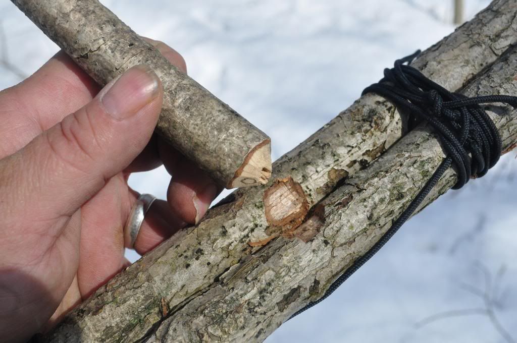

I usually make my spindles before the hearth-board.

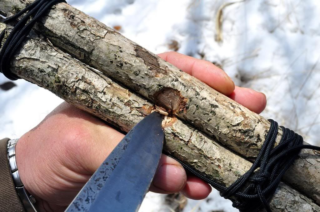

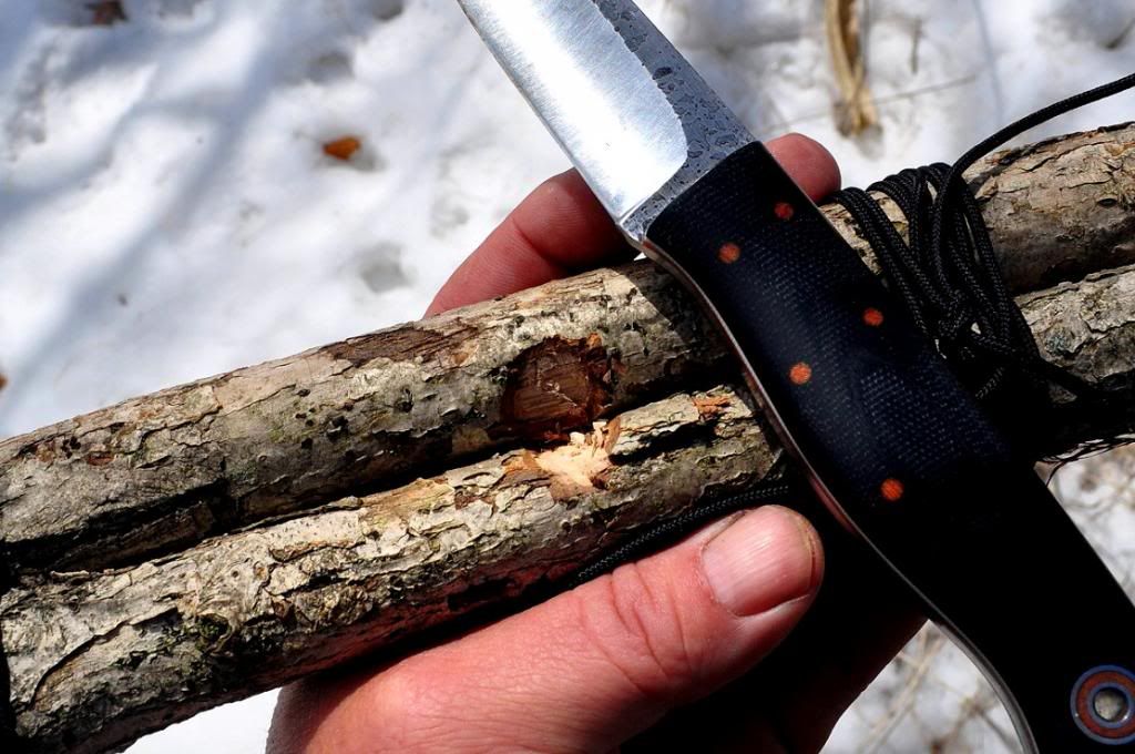

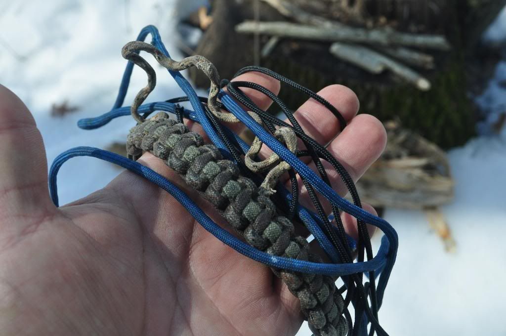

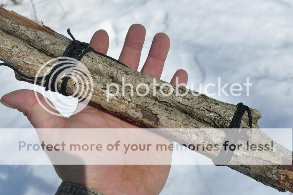

The hearth is fairly simple to make. Using whatever cordage you have on hand; a para-cord bracelet, a bootlace, strips of cloth from a garment, or natural cordage woven from vines or fibrous leaves, tie the two sticks that make up the hearth together. Then place the tip of the drill end of the spindle into the trough of the hearth, mark each side of the spindle with the tip of your knife, then cut a shallow semicircular notch into each side. This stops the spindle from just traveling back and forth in the trough, and will become the socket as you drill into it.

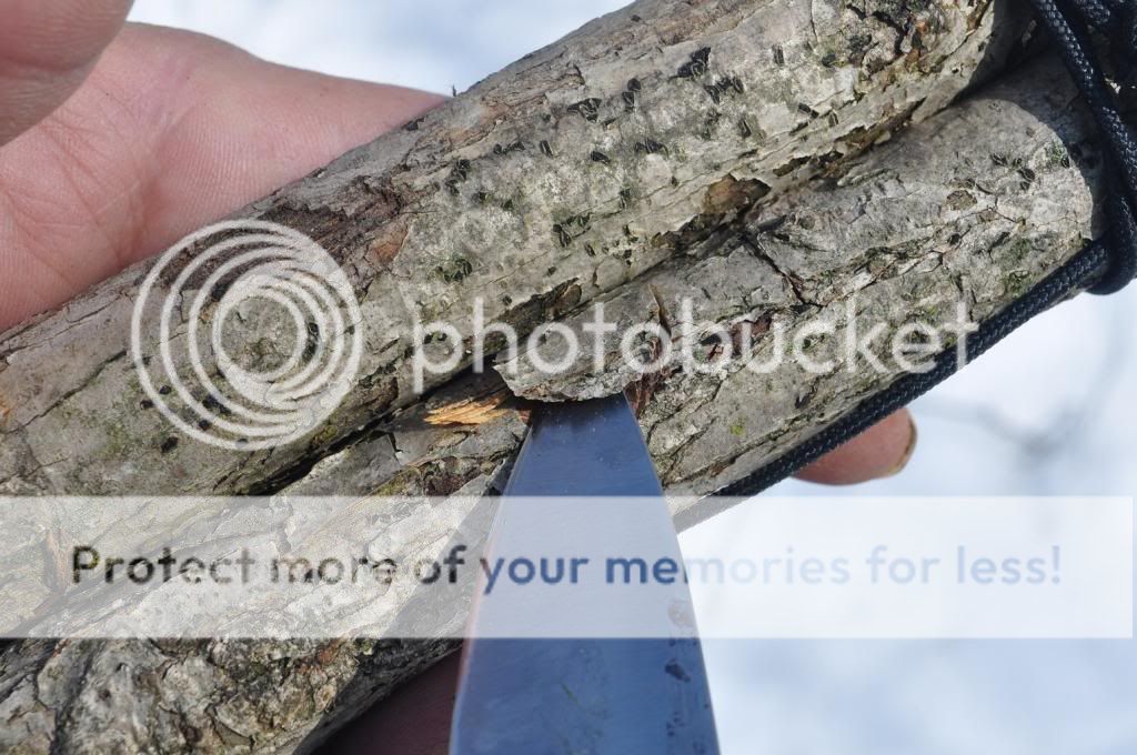

For the bearing block, you need a non-spalted, not rotten piece of hardwood, and there are various ways to go about it depending on the types of wood in your area. I prefer hard seasoned hickory, oak, walnut, or any hardwood that will glaze and become smooth from the heat of the spinning spindle. This reduces the amount of heat transferred to your hand when drilling. This time I used a section of a birch tree that was recently brought down by the weight of ice and snow, and the high winds, I used the same ring-and-notch technique to remove a limb, and then to remove the section I need from the cut end.
Then just to speed things along, rather than whittle a flat spot for the divot, I used a stick off the ground as a baton, and a downed log as an anvil and split off a section of the bearing block. Then I used the knife tip to bore the divot for the spindle. You want this divot deep enough that the spindle does not slip out during the spinning, but only just deep enough. You'll want as much insulation as you can get between your hand and the hot tip of the spindle. The divot will indeed heat up as the spindle turn in it.

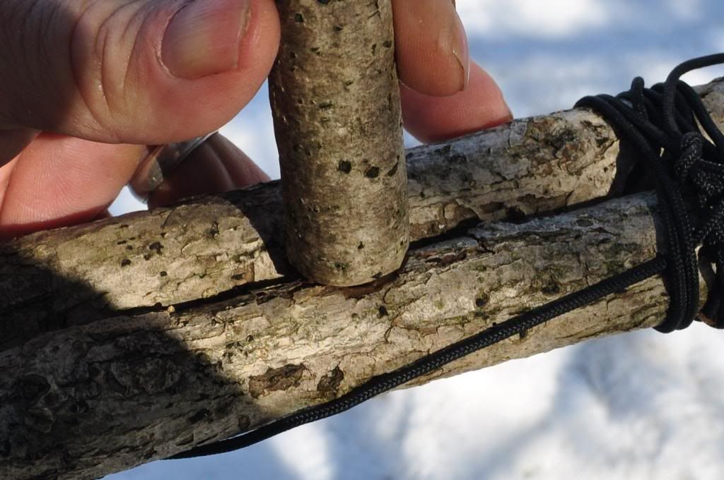

Now the spindle, hearth, and bearing block are made.
The pieces fit together like this
All that is lacking now is the bow to turn the spindle with, and tinder to turn the ember into flame. There will be more on that in part -3 of “Keep It Sharp”, but one good tinder material is the dried fibrous inner bark of certain types of trees. I find it better for the most part to remember characteristics than actual names.

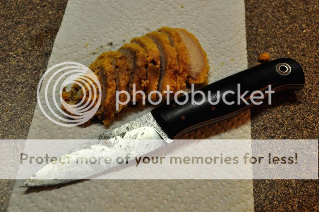

Then I took the knife into the kitchen, more as a test of edge retention than a test in how well the 1/8 convex slices, I already know how well it slices :) The little wanted catfish for dinner one night, so I used the KE Bushie to slice the potatoes into steak fries, dice the onions and cut the peppers for the hushpuppies, and to slice up the catfish fillets. For me the KE Bushie is like an awesome, sturdy, all purpose paring knife that I can take to the woods with me. I love the way the knife handles. Yep, still sharp even after all of the abrasion against the hardwood in making the parts for the bow drill, still nice and slicey!
The next day for lunch I made a smoked sausage sandwich, since the KEB was on my belt, that's what I used. The knife is still plenty sharp enough to slice sausage for homemade pizza if I wanted, and made quick work of slicing the sausage into a plank for my sandwich
Obviously tests are still on going, and I still don't know if I want to go with a 1/8”/3mm blade for the winters here after this last one, even paired with an axe. But I certainly won't be feeling under-knifed with it on my belt during this coming warm season :)

...I debated between the sausage and the midnight snack pork chop last night :) Seemed the sausage said more about the edge retention, but cooked meat is a good abrasion to expose and edge to for testing...
