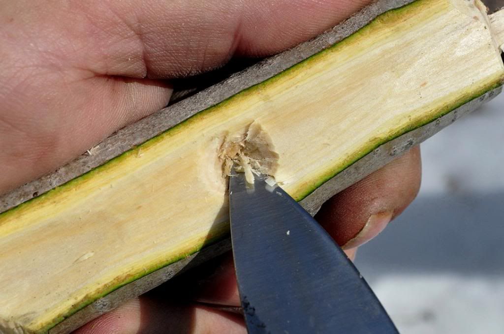

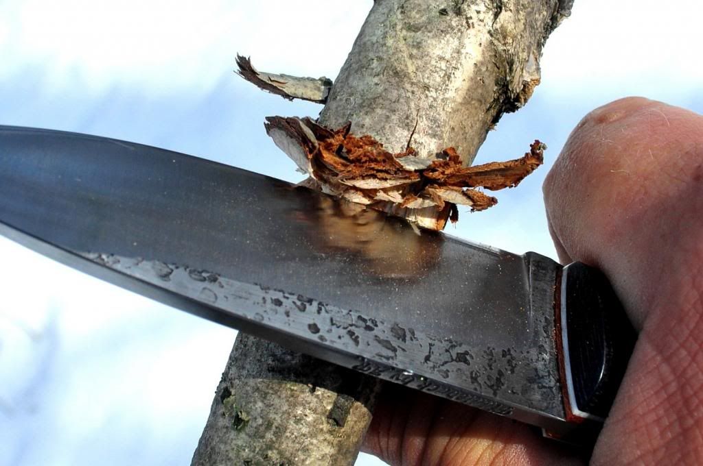

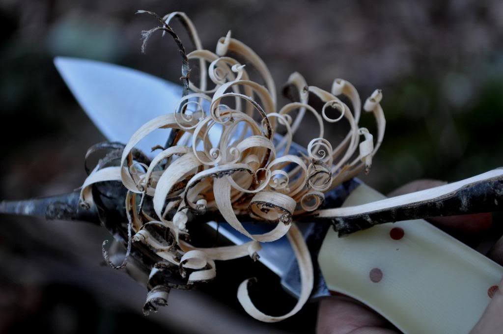

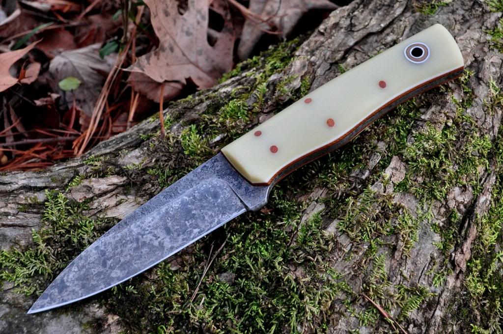

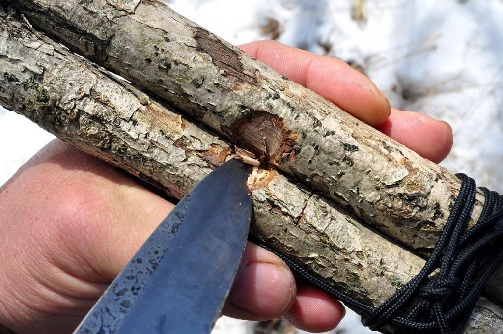

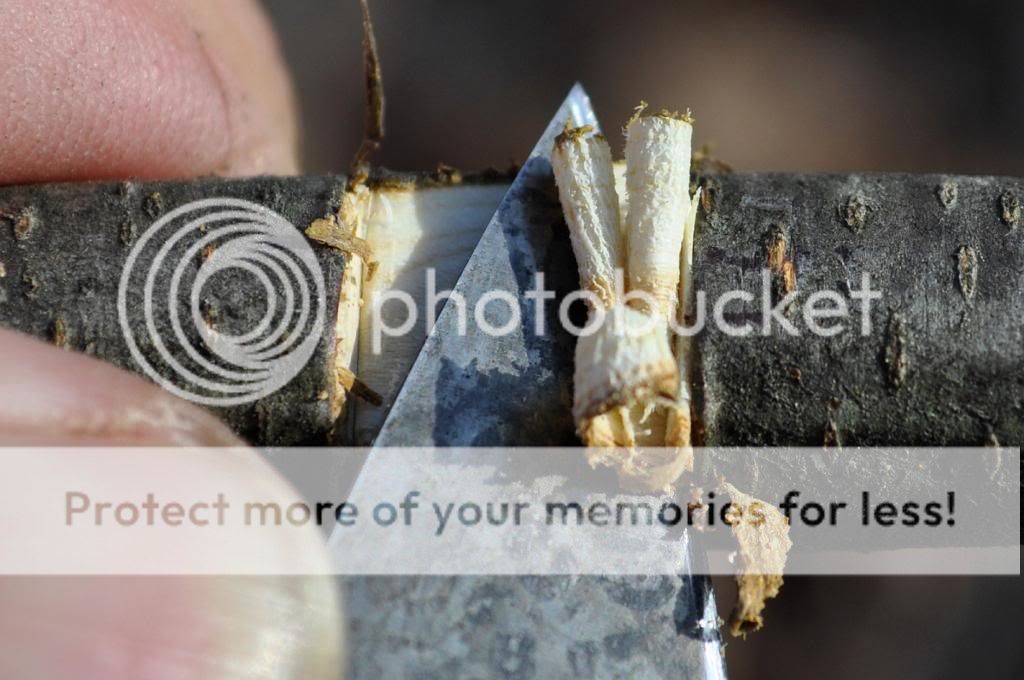

I have had a few of Andy's thinner blades, including a small knife in tapered 1/8 / 3mm. But this is the first "bushcraft" style working knife I have had in this steel thickness. With the abrasion on the edge at the tip when boring divot holes...
...and both the lateral abrasion of the edge and the stress of the twisting in the ring-and-break cutting method....

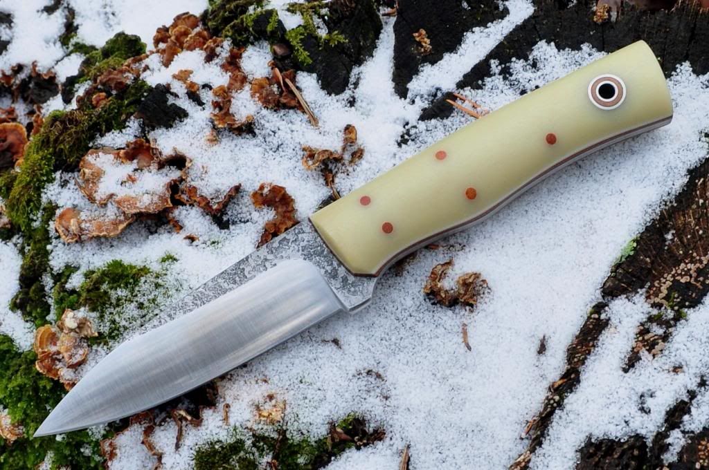

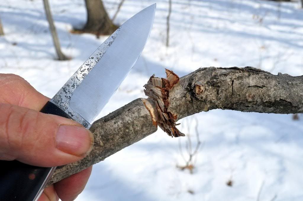

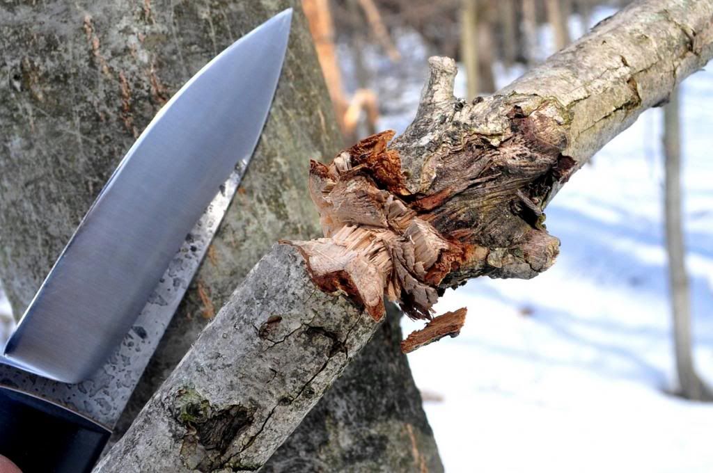

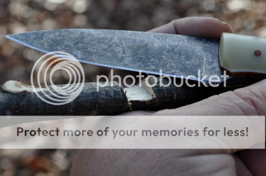

...I am really happy with the performance of the convex as a bushcraft knife so far, and with the edge retention. I think Andy has really dialed in his heat treat for a great mix of edge toughness and edge retention.
By the time the testing is done I may be wanting a tapered 1/8 / 3mm version for the summer, and a tapered 5/32 / 4mm version for the colder months :)

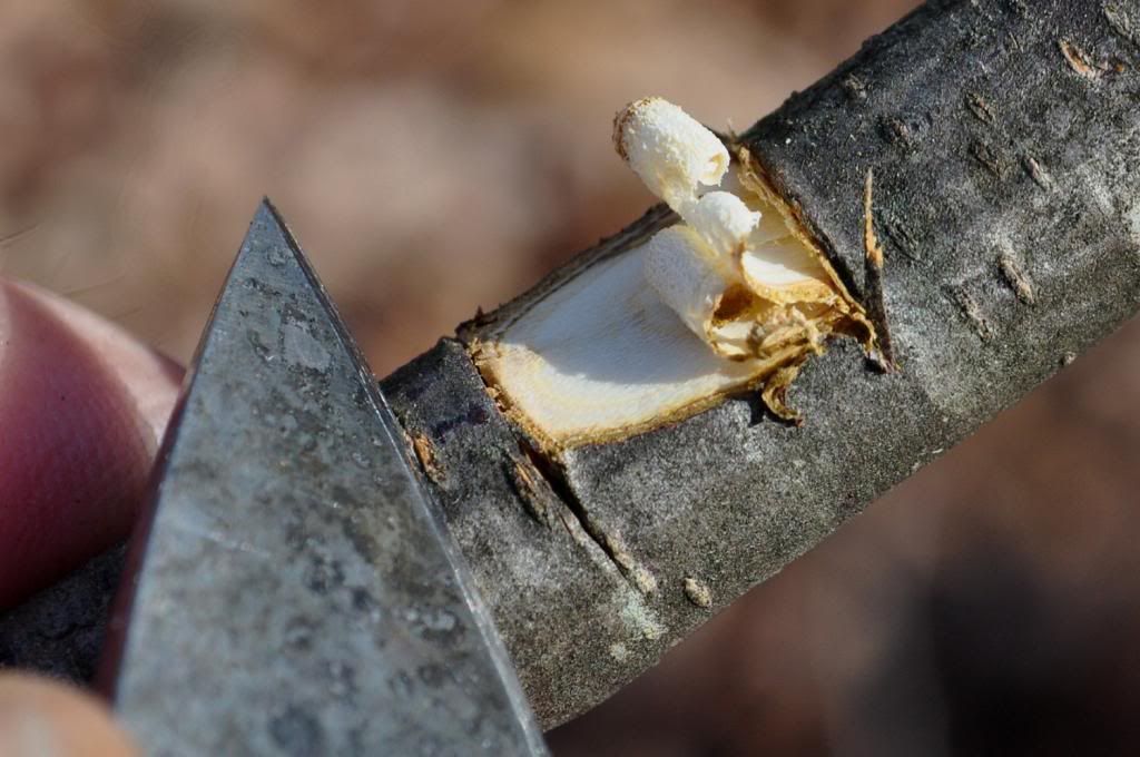

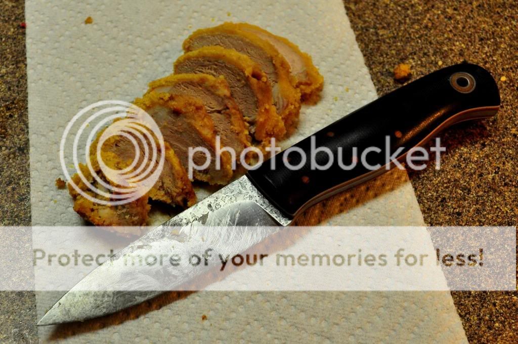

As time went by I expanded the micro bevel into a V edge, which was still plenty sharp enough for fine work.
But as you can see, I didn't go too acute with it, in order to keep the edge in a reasonable range of toughness for harder work
Tests show O-1 tool steel to be a good tough steel even in the RC ranges of 60-61 where it also has good edge retention. You just have to dial it in to your specific needs. If you are going to be doing a lot of game processing and meat prep, then a more acute angle, or finer convex edge may work better for you, just be keep in mind that if the edge is too fine the contact with bone may do damage. If fire prep and heavier bushcrafting like chopping will be done then a more obtuse angle or less thin convex edge will be a better way to go to endure the impacts. And if your tasks fall middle of the road in this, then so should the edge geometry in my opinion.
Considering the nature of the tests I am doing, I will likely adjust the edge on this one to be a little less keen in order to keep things within reason So far there is very little edge degradation even after the use in cutting the hard wood with lateral abrasion to the edge, bu I'll still want to make the edge a little bit less fine for general use in my tests over time.
